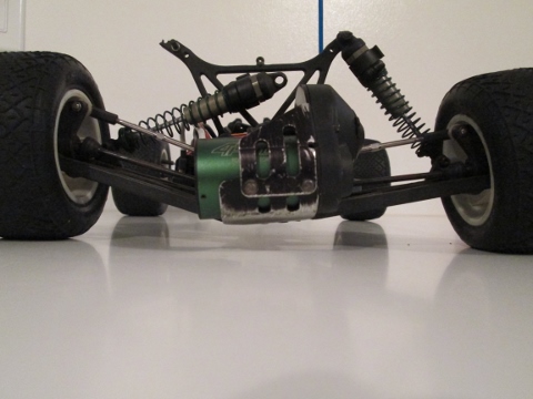

The truck spent almost as much time grinding down the road on the shock towers with no body as it did right side up. I can't believe the ears on the dogbones didn't shear off. They were well worn when I got the truck.

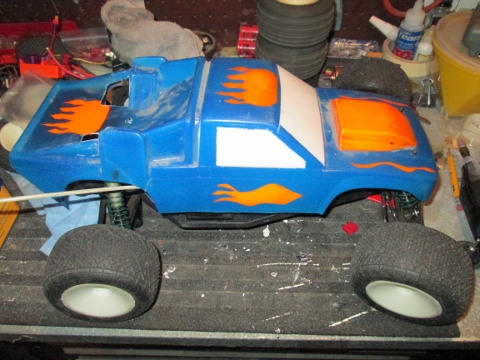

I updated the third grader paint scheme with Krylon paint for plastics. I used the paint on properly prepared 1:1 hubcaps and it never chipped or fouled from brake dust. It seems to be holding well on the lexan too. Most importantly it will keep me from grinding down any more parts. I will still get a newer T3/T4 body at some point.

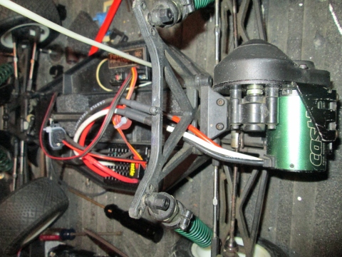

I am still learning the gear ratios of the truck. Castle recommends 87/12-16. I have been running a Castle CM36 4600kv geared 84/20 on the street. The truck hooked up with little wheel spin so the motor was working hard but never got hot.
I bumped up to 84/23 running at the beach and did not have any heating issues i.e. I didn't burn anything up. The motor was fairly hot to the touch and probably close to the limit <insert temp gauge here> I swapped out the CM36 for a 1406 5700kv (I believe both are 4 pole motors). I already smell fire...

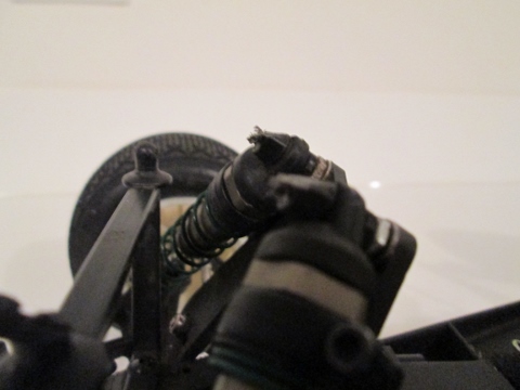

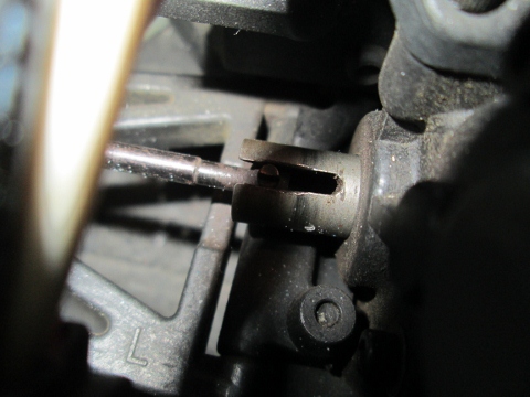

I cautiously estimated around 45mph, others believe it is running 50+. The body blew off in the first spectacular crash caused mostly by body aerodynamics. Shortly thereafter a high-speed run on asphalt ended with a 50ft slide on the shock mounts. They were all ground down evenly but the left rear upper nylon shock nut was ripped off.
I continued full speed runs and general bashing with the shock dangling around as I didn't bring the tool box. I clipped a utility transformer and broke the right rear arm mount. The mount was intact but seemed to break the front screw loose. The arm was hanging on and swinging from front to rear during, yes, continued bashing. Don't ask me how I didn't bend the axles

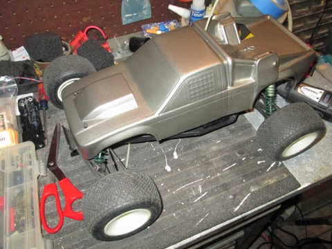

I opened up my T4 and put the body on my T3 and its seems like the body COULD work.My 4 body is uncut so i cant be 100% sure.The body dimples in the rear are for 2 post on the T4,so thats the best i can do.
