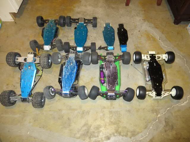

I would love to see some pics of your chassis'
Had to charge the camera a minute, but here ya go:
"When you are dead, you do not know you are dead; It is difficult only for others. It is the same when you are stupid."
That's nice, but I was thinking of something that might actually be pertinent to the conversation, like a close up comparison shot of two bare chassis'.

justinspeed79 wrote: That's nice, but I was thinking of something that might actually be pertinent to the conversation, like a close up comparison shot of two bare chassis'.
I got one better....Blue flat chassis, Black tub chassis, and DS black tub chassis
The flat blue chassis is the longest wheel base chassis of the GT line. The blue has the front extended further fwd than the tub chassis. Now the GT black tub chassis and the DS black tub chassis are different as well. The GT black tub chassis has the longer wheelbase compared to the DS chassis. The GT has two mounting holes for the nose tubes where the DS only has one set.
The GT vs DS chassis. see the extra mounting holes as well as the extra length?
in this pic you can see the steering servo mounting holes are further fwd than the center noseplate screw hole on the GT than on the DS. The blue chassis has no need for the center hole but look at the steering servo holes and you can see they are the furthest fwd when all three are compared.
Hope this better demonstrates the difference in wheel bases between all three chassis.

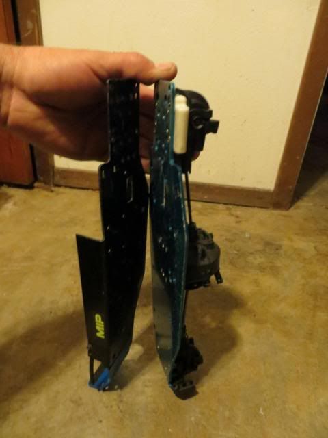

Here is a tub on top of a long flat chassis, nose plate screw holes aligned, dimensions are the same from there forward. As you can see the flat chassis is clearly longer on the back. NDS chassis also pictured for reference.
Are we good now?
