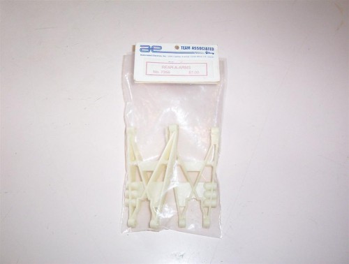

Based on the 10T sticky, this is a non webbed rear:

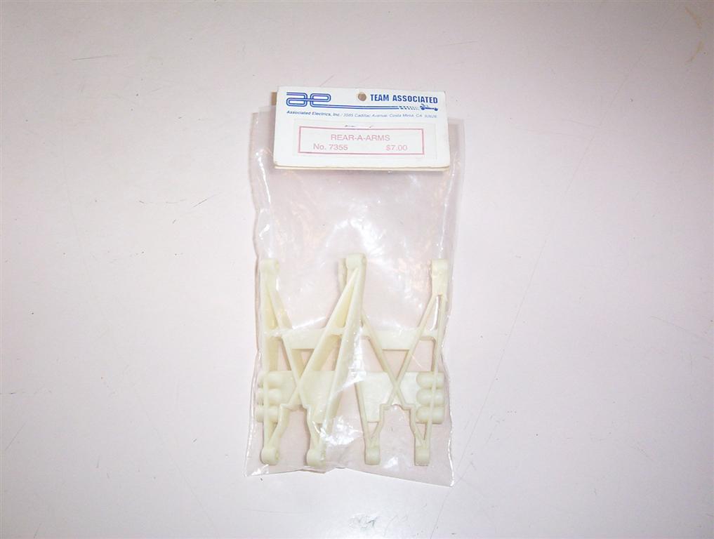

And this is a webbed rear:
Here's mine:
Based on the radius webbing, it appears that I do indeed have the "mid" arms.

The arms you have are webbed, and still "correct" for an early. The non-webbed arms are from the very first run of kits, with other parts mentioned earlier. The thin webbed arms were only found in kits, and not in support packs.
