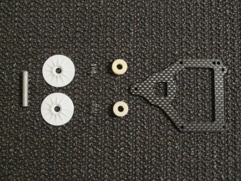

Re: RC12LS 1995 Euro Champs Special
Thanks for offer, just found those parts.
Found also some other parts at the weekend so build could be continued.
When building the t-bar pivots before, one used plastic socket had to be borrowed from an other car.
These parts had been replaced now by new ones.
All parts for the friction damper gathered, ready to install.

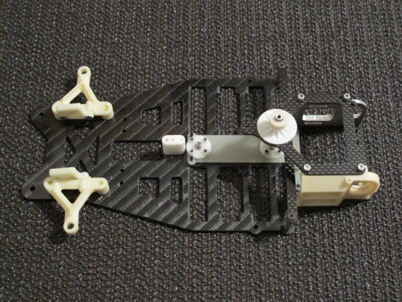

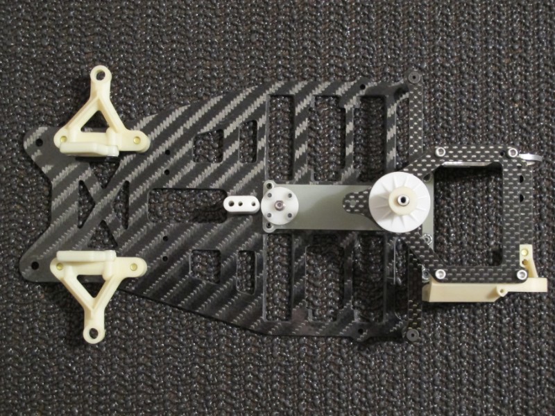

Also rear pod could be completed now.
Phil used AE 4-40 aluminium screws for the upper plate, I had exactly four of them left.

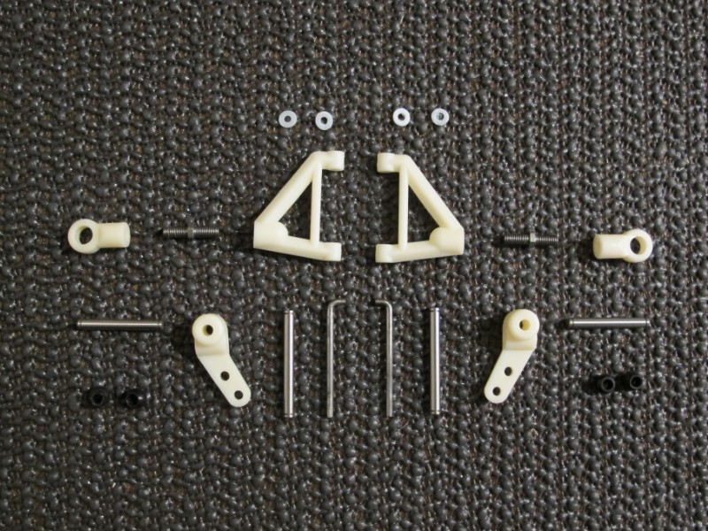

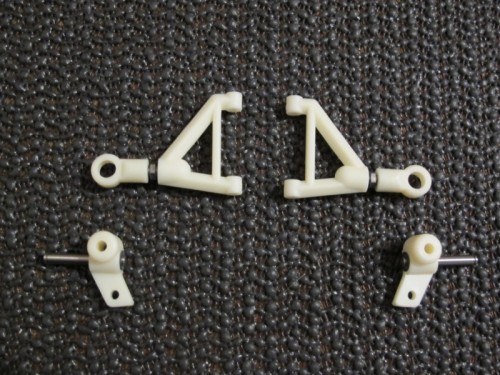

Assembly of upper arms, left/right turnbuckle for camber adjustment and eyelet.
Steering blocks shortened for 1/12 scale configuration, also stub axles added.

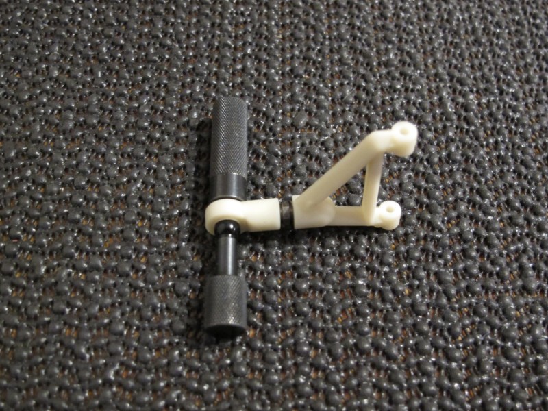

Adding pivot balls to upper and lower arms.
You can do this with pliers or a vise, I personally prefere this special tool for not damaging anything.
Bought this in the 80´s and have worked for my for lots of cars.
