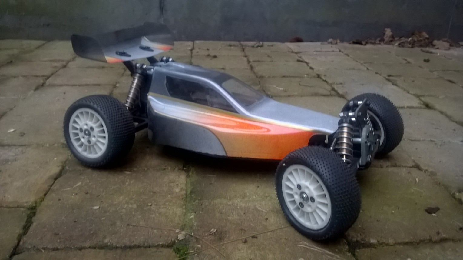

Things have changed a little: I subscribed for a race the first weekend of February.
For 2WD I'll probably run my new yokomo for the first time. And 4WD... well either an optima, the bling-bug mid, the pink wyvern, still-to-build lazer, my hot-dog works or.... yep: the MX834
So I've been working on the front end to increase the suspension travel:
The rear was less problematic to start with, but I moved the shocks to the back of the arms anyway and made a new rear shock tower adding a little more ground-clearance.
Unfortunately I forgot about integrating the holes for a wing mount
will hahave to fix that and get started on the front tower next
- I had to put in the MBR4-BC U-J's instead of the MX4 CVD's; somehow the CVD's were a bit too long and limited up-travel as they jammed into the outdrives. Result: about 10mm more travel upward. Thumbs-up smiley where are you when I need you?
Down-travel was limited by the lower kingpins hitting the under-arm crossbrace. Picking the alternative hingepin location on the carriers gained me about 10mm down-travel.
I also filed the area where the u-j goes through the carrier to give it a bit more clearance when the arms are at their lowest.

Re: Mr. ED and the dawn of the MX834, or mxx4?
Long due update: the 834b body was no good for a racer, so I guess it's an mxx4 now.
The car went pretty good, especially considering the front shocks bled half empty. Unfortunately the axle of my motor came out of the can and that destroyed a spur. The belt stretched out and the servohorn slipped. And then there was the heat I missed, and one I quit halfway: thinking something was wrong but it turned to be just some clay stuck in the wheel.

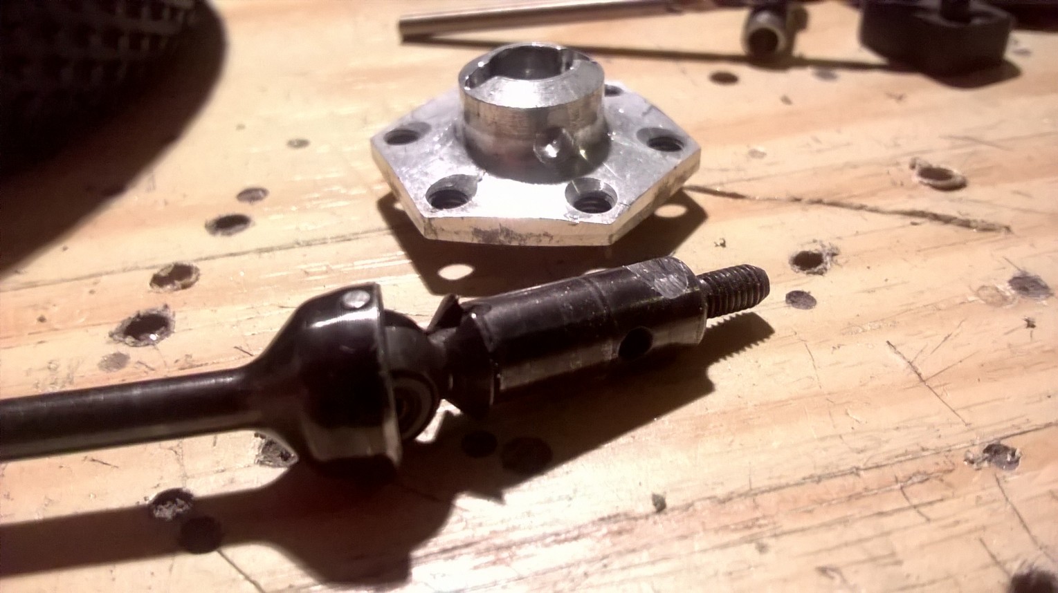

I modified the hubs and axles after reading here how they'd come loose systematically.
In the end I ran out of time and only had this mod on the front for the 2 days race. It worked well, but I didn't have any issues on the rear either.The car went pretty good, especially considering the front shocks bled half empty. Unfortunately the axle of my motor came out of the can and that destroyed a spur. The belt stretched out and the servohorn slipped. And then there was the heat I missed, and one I quit halfway: thinking something was wrong but it turned to be just some clay stuck in the wheel.
