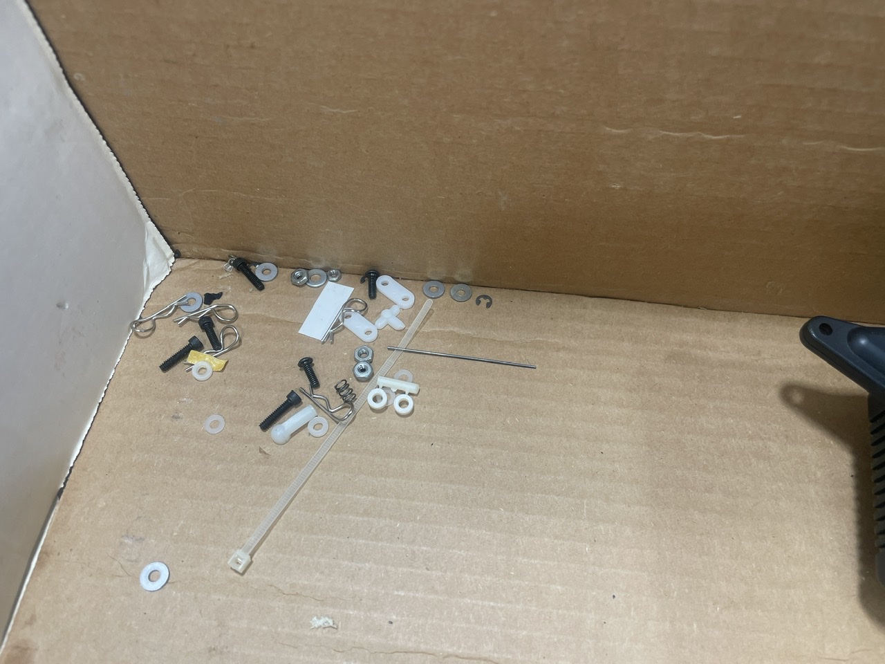

Purchased another truck, as I’m cleaning out the box and putting all the little loose things floating in the box into a baggie. I noticed something most would overlook. Yep, that’s the factory clutch spring laying there. I looked in the manual and the mention of clutch spring has been removed.
