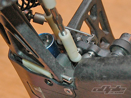

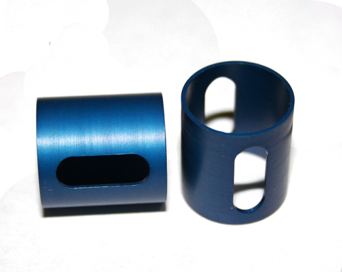

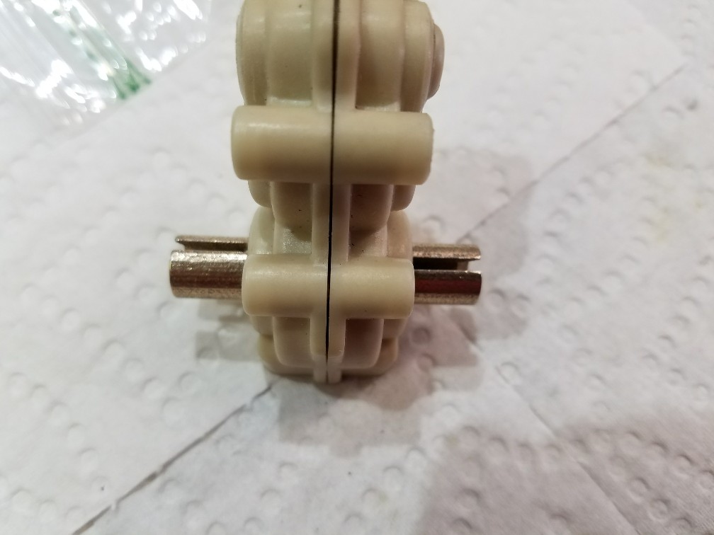

Or something like the Outdrive Savers we used on the XX4 with plastic outdrivesjwscab wrote: ↑Wed Aug 09, 2017 2:11 pm i only worry about mushrooming of the cups, If I remember correctly, aren't these also made with a brass or bronze matrix? ie, the stainless powder is intermixed with a brass alloy? would be good for wear, just hope they have enough stiffness.
Might be worthwhile to design some cup rings grooves, like you would see on plastic outdrives. very interested to see the results.

Got a pic of how those are assembled with the plastic outdrives Joey?

slide right over the top...let me see if I can find a pic

Not a great one...

Oh that makes sense. Even with those, I don't think printed nylon ones would survive the brushless/lipo torque and clay and turf traction of today. I think the pin on the end of the CVA would destroy the plastic contact surface of the outdrive.

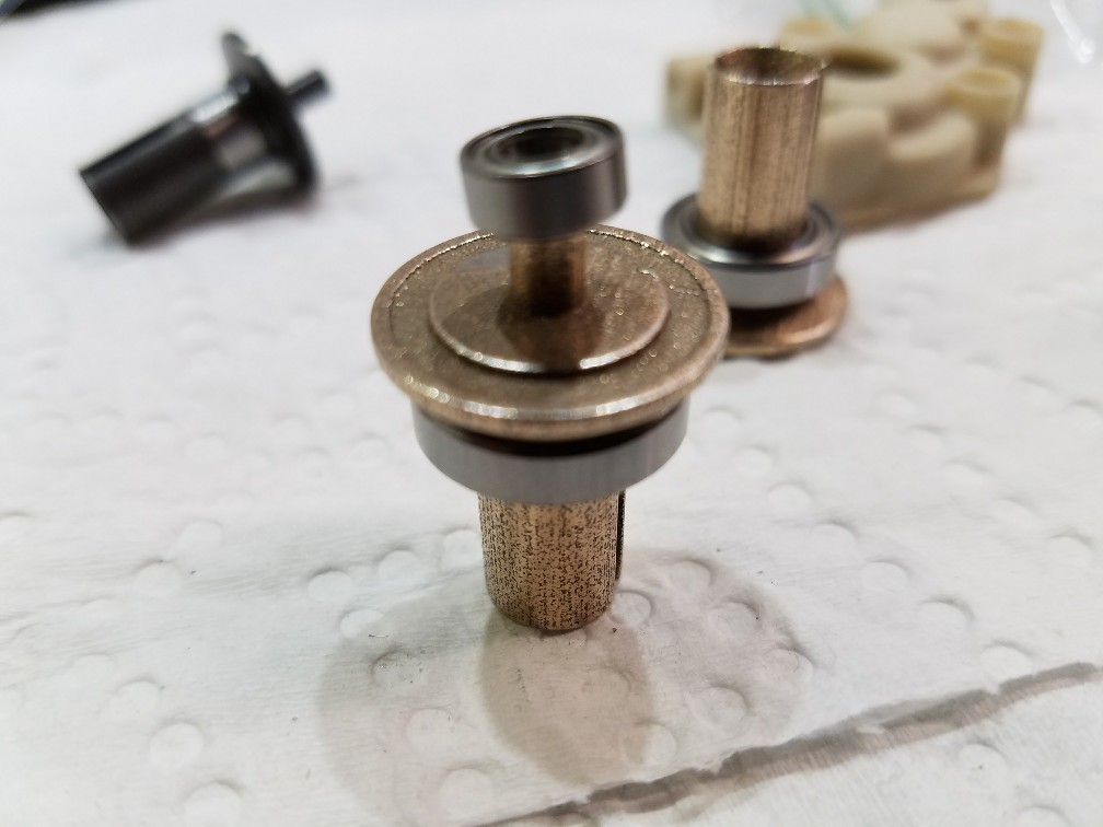

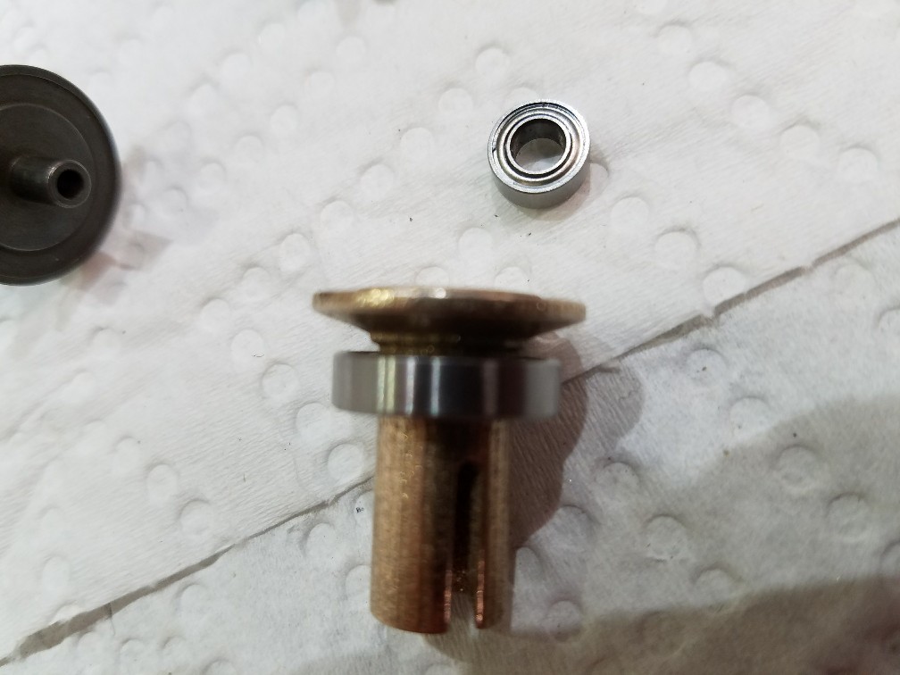

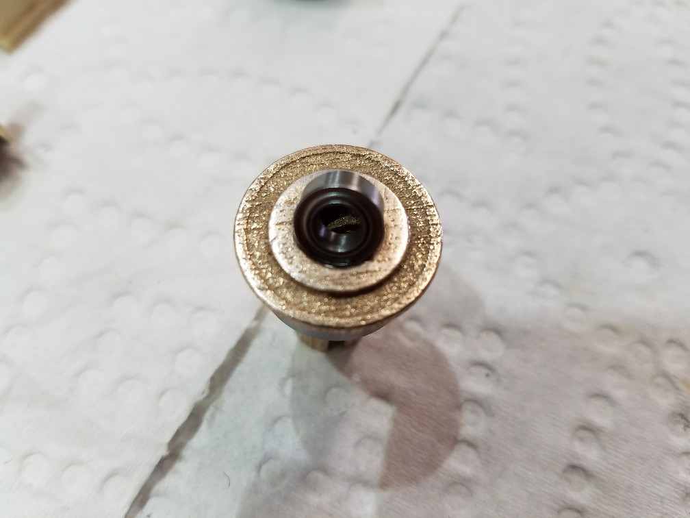

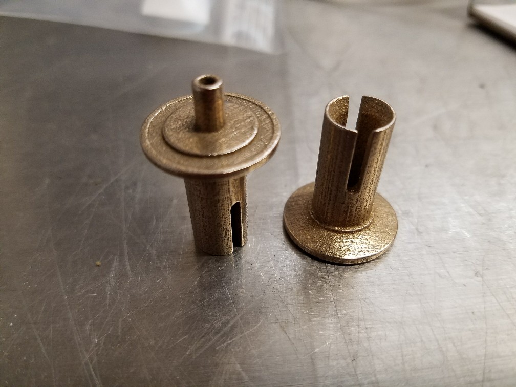

The printed outdrives came today.
My first impression: nice!
The outer bearings went on nicely, but on one side it didn't quite bottom out: I can put a small undercut in the model to prevent that from happening. I think some factory parts are even like that.
This is slightly more problematic. The diff bearing did not fit in its hole, the hole is a little undersized Likewise, the bearing would not go on this post I plan to measure how much those two features are off by, then compensate on the CAD model. In other words, if the bearing bore is undersized by .005, I'll make the hole .005 oversize on the CAD model. These two features are only off by a few thousandths each, so I think it's a reasonable approach.
I'm the mean time, I'm going to machine these outdrives to get them to fit so I can test their durability, which is the other big question aside from fit. Once I get them to fit I plan to run them in my RC10M and see how they hold up.
