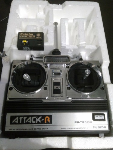

I was surprised it wasn't easy to find a "How To" online. You would think the motor would come with something. My ESC came with a huge manual. I am using a Futaba Attack R, the same radio I had when I was a kid. Found one in mint condition.
