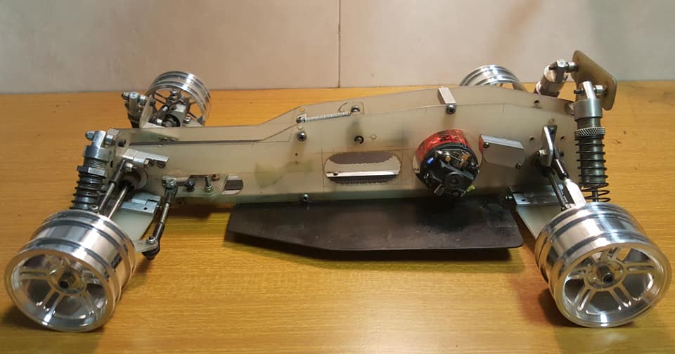

you made the wheels???
Re: Brimod Prototype Car
Posted: Wed Dec 11, 2019 9:52 pm
by dinglem
KidAgain wrote: Wed Dec 11, 2019 4:02 pm you made the wheels???
No, i actually sent off a set of my Pro Radiant plastic rims to a wheel guy and he made them up to fit onto my Pro Radiant, but in the back of my mind i also thought they might just work on this and they really do. My father typically machines all of our alloys but i wanted something very specific in this case.

dinglem wrote: Wed Dec 11, 2019 10:25 am Not too much of an update with this, but I have had a set of alloys machined which really seem to set it off 8)
Those wheels look like they're from Pargu in Korea. I bought a set, I believe they were for the Kyosho Scorpion but will fit any 12mm hex, and I believe are 2" diameter. I'd link to them but Pargu's entire website is totally borked, practically none of the links work, all of them serve up page coding errors.

Yes they are from Minsu. I had been messaging him for quite some time and sent over a pair of my Pro Radiant plastic rims (front and rear) for him to use as a template to make a set of this design of rims fit my Pro Radiant, but they also cross over well onto this Brimod car. They seem to suit the machined look!

I gave the car a quick wipe down to check it over last night - the front shocks a re a bit of a mess and will take some sorting i think. The hex adjusters are locked up solid so i think i will try soaking them in WD40 overnight to try to get them moving. Reluctant to try forcing them too much as they are so rare. I started polishing up one of the hex rears though, and they are going to come up a treat :D
I had a pair of original Brimod UJ's for the rear end (fronts were already fitted) so they have now been added.
I was also curious about the main drive mechanism to the rear gearbox. My initial thought was that it ran off two 32DP pinions running on the two shafts which then mated to the rear diff, but on closer inspection the front pinion on the main spur shaft is absent. I was presuming i would have to add one, but i then tried turning the main spur shaft and it actually drives the entire drivetrain (very freely i must say!), so i now presume that there is some sort of gear link within that tiny alloy box to the rear of the motor. It never really crossed my mind before as it looks too small to house anything! I will whip it off shortly for a closer look.
The spring-loaded belt tensioner is a really cool detail also.
There are also holes in the wishbones and through the central chassis plates to accept the anti-roll bars at either end so i will have to add those, based around those i have seen in the prototype mag pictures from 1988.
It is an absolutely beautiful machine to look at - i keep finding more details here and there.
I am also wondering which bodyshell to go for - 1988 gives plenty of choice and as there was never an official shell made i can go for pretty much anything!

Well having just checked it turns out that small alloy case behind the motor actually houses a pair of meshed 12tooth pinion gears. Clever way of making the drivetrain relatively easy to refresh i suppose. There is a third pinion gear mating to the diff itself, and the whole set-up spins very very freely indeed. The outer alloy casing is incredibly thin, and the whole lot is coated in gobs of grease. Pretty cool.

Just trying to think why they went with the double lay shaft and two pinions , my guess it changes the direction of rotation as many stock motors had fixed timing that went faster in one direction , it also keeps this system of reversing the drive out of the way of the belt path , it might offer a gear ratio change option with odd size pinions but I don't think that's it because the housing doesn't look like it has much space for a larger pinion that would couple to a smaller one .
The mystery of this car is making this one of my favourite builds to watch , will you ever run it or is it destined for the shelf ?
Posted: Fri Dec 13, 2019 12:18 pm
by dinglem
I was thinking the same regarding adjusting the final drive ratio somehow. I presume if the car had been developed it would have been simple to make alternative gear cover to house different sized pinions where necessary.
It all seems very efficient though.
The next thing for me to look at is the front one-ways which are built into the front diff out-drives somehow.
As with all of my cars they are built to run so i am already gathering suitable electrics for it. Nothing brushless/Lipo going anywhere near it!
