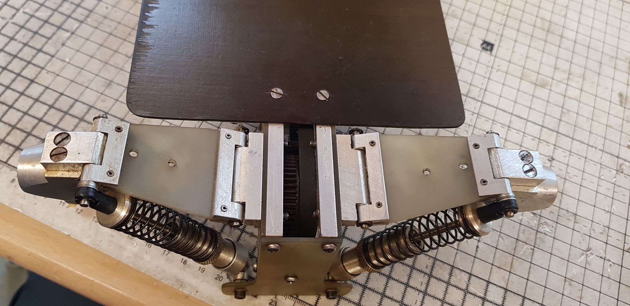

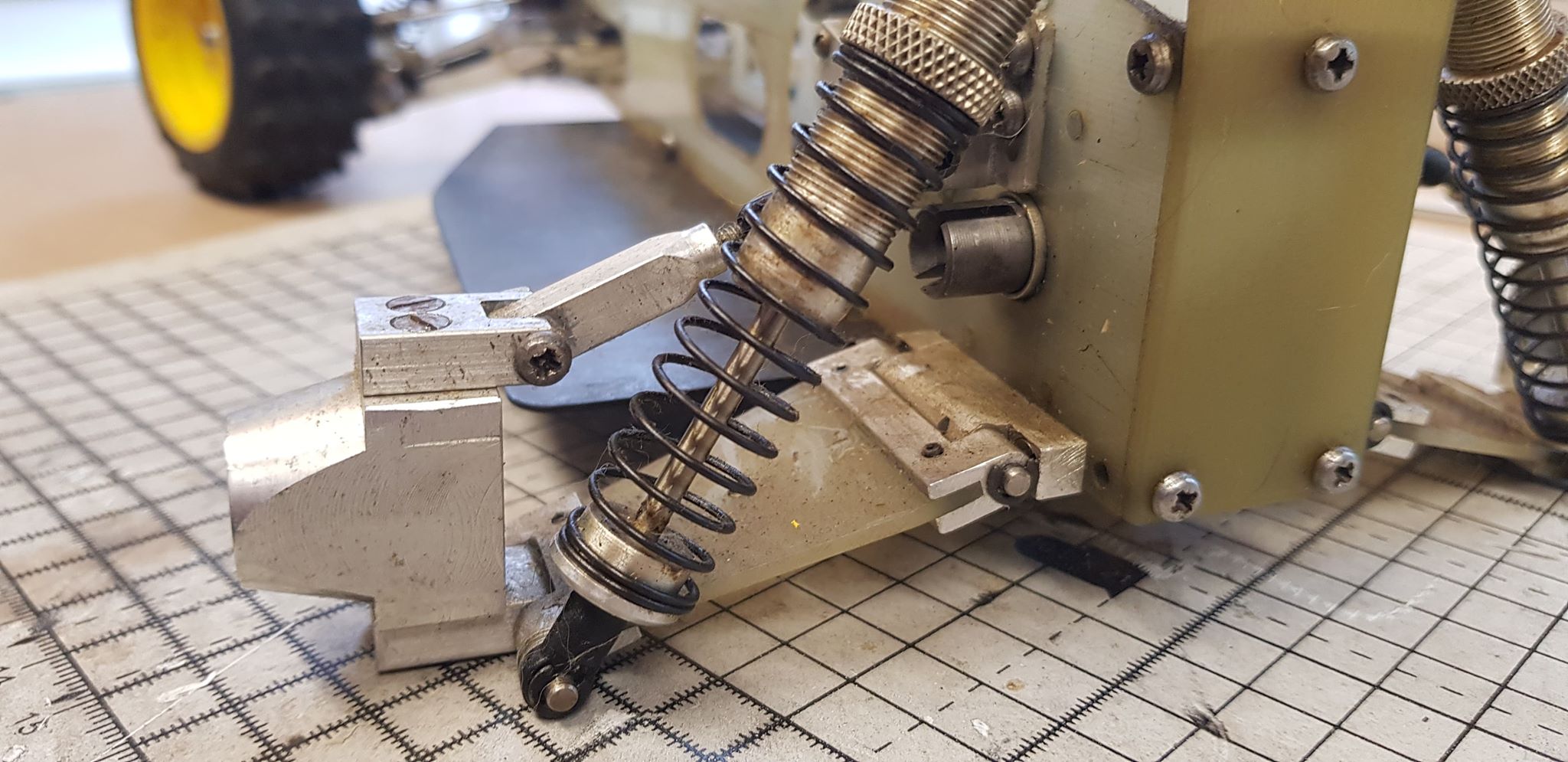

I won't post too many pictures until it has safely landed on my doormat, but this thing is completely bonkers. I am also really pleased to say that it is the 4wd version.... something that i had never seen or heard about previously.
Quick teaser:-
Quick teaser:-

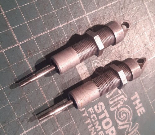

I have pretty much immediately started looking at what parts might be required for this. I know from studying the old magazine pictures that the two prototype cars I have seen had slightly different Brimod shocks than the typical versions which were commonly available. They had smaller shock caps for starters, had a coarser thread on the bodies, and had hex adjusters rather than the usual round rough-finish items. The upper cap was made to accept a diaphragm but did not have the bleed valve which was one of the main selling features of the commercially available Brimod shockers.
I noticed on the car I have purchased that the correct hex adapter versions are present on the front, including the lower profile caps, but the rears are the more common type. I contacted a friend who also has a few sets of these shocks and having checked what he had, he discovered his rear pair were the missing hex adapter versions. Quite a stroke of luck, and he has agreed to make a trade with me for a standard set so the prototype will have the correct versions all-round

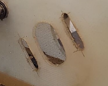

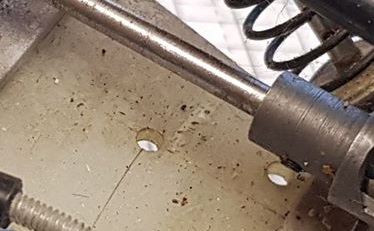

Well let's put it this way... this one still has the pencil marks on the fibreglass for the design cut-outs(!) I am therefore guessing it is either 1 of 1 for the 4wd version, or at least this is the first. I knew of two 2wd's, but had never even heard about them making a 4wd one until I saw this, and I had researched them quite a bit in the last year or so.winner_evo wrote: ↑Sun Nov 03, 2019 10:33 am I wonder how many of these existed and raced bitd, any idea?
It has definitely been run in 4wd mode at one time or another, there is evidence of this on some of the spare parts which come with the car. The spares suggest they were experimenting with several set-up options.

No concerns about vintage plastic parts shattering with this one, that's for sure!

I'd guess that getting it to run well was a first priority and weight reduction would follow , that's how I'd use a prototype , you want to know the geometry works without worrying about it breaking ,that's quite a find !

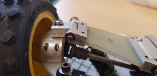

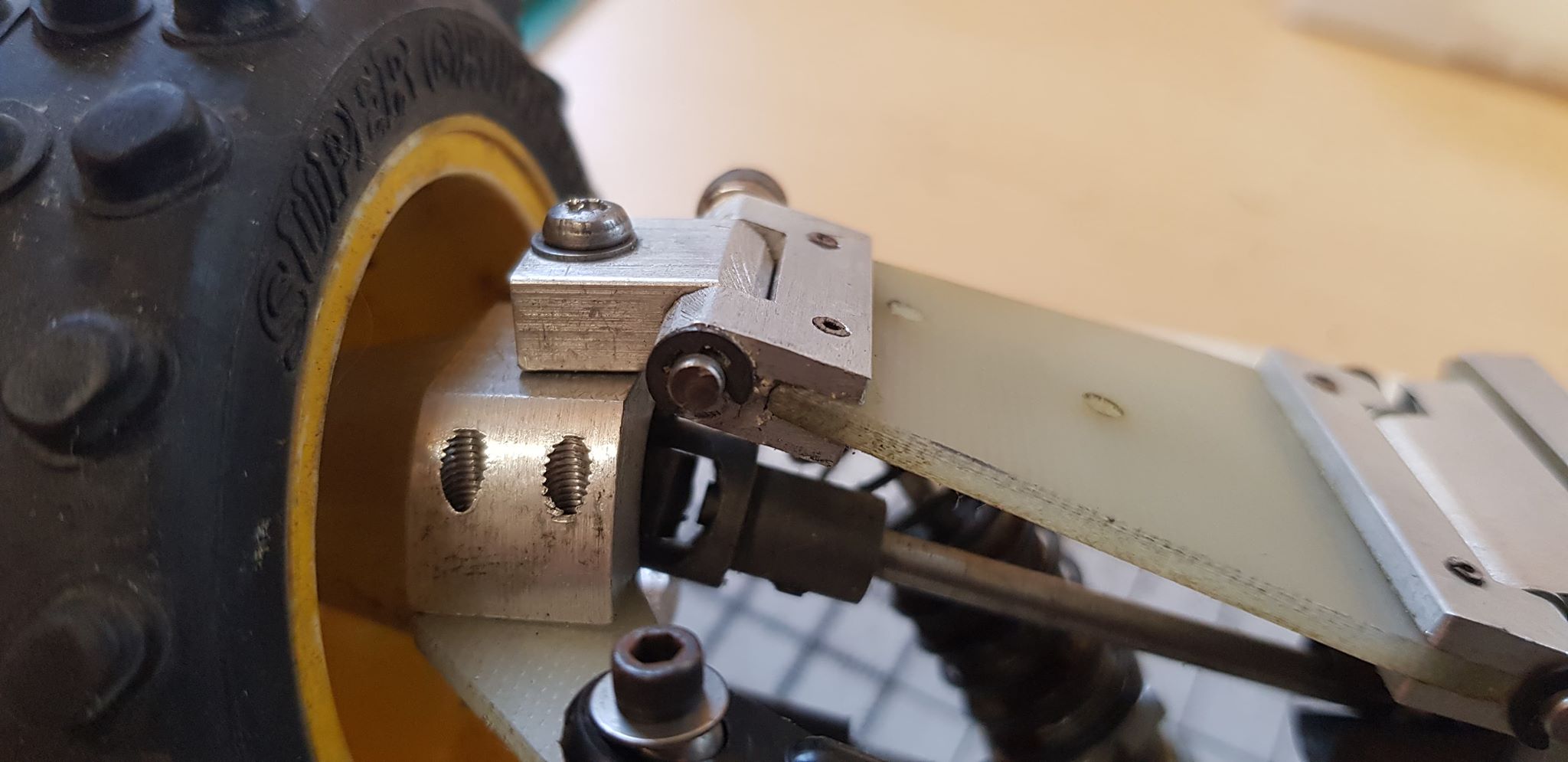

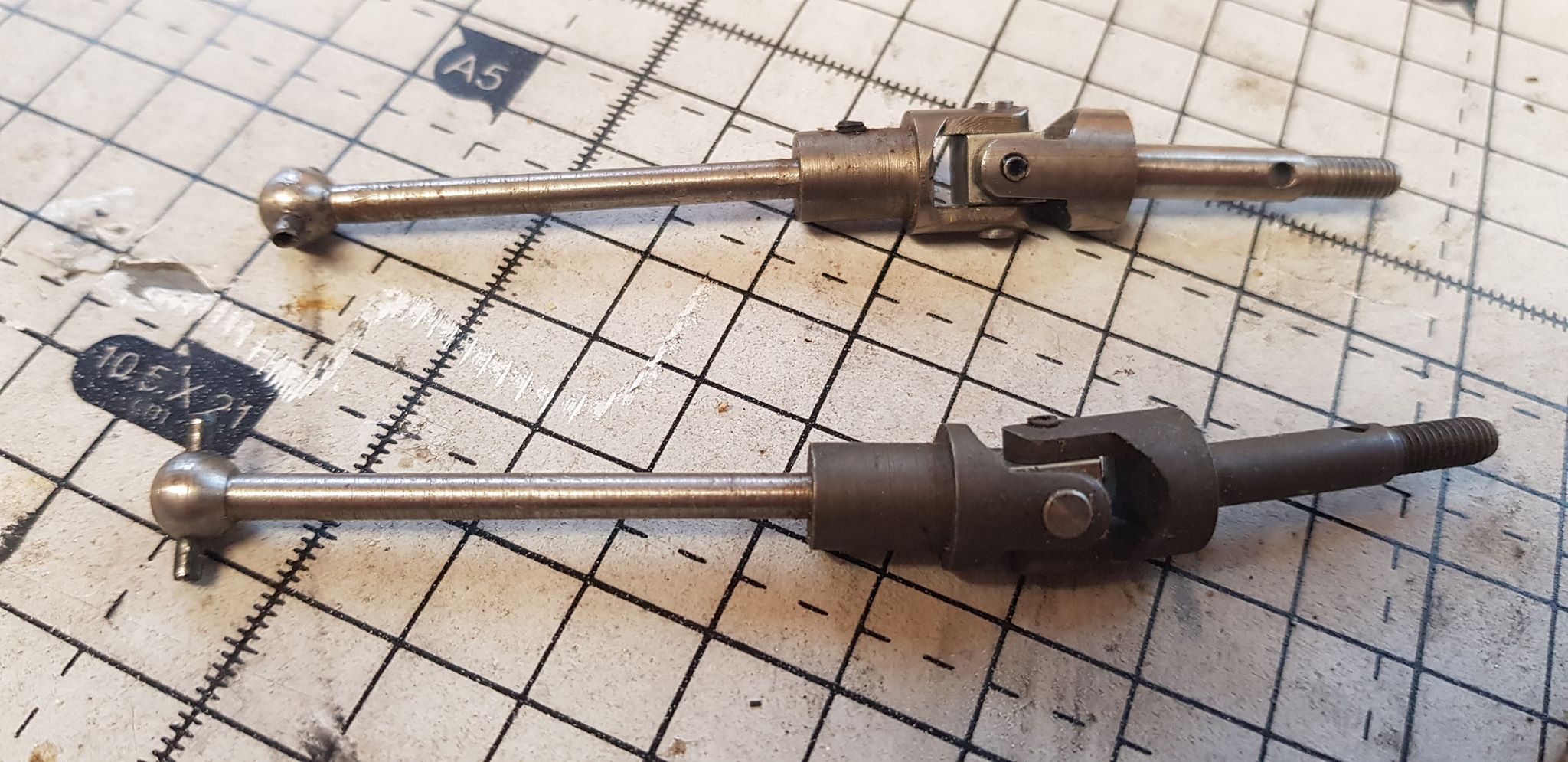

The UJ's are quite a cool design too. Very chunky and substantial at the joint end, but the main shaft is held in by a grub screw onto a flat as you can just see in this picture. I guess once located at the diff end they can't really come out as they are essentially trapped. I knew they made similar versions for the Pb cars as upgrades so i guess they could just use different lengths of main shafts and interchange the joint end for various model applications.
These are unique to this model i am presuming, and thankfully there are 6 of them included with the car as well as normal stub axles for presumably more basic dogbones. One pair are of a darker material too?

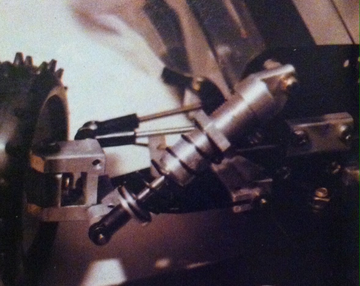

Here's an old advert showing what looks to be the same units and a bit of detail about them.

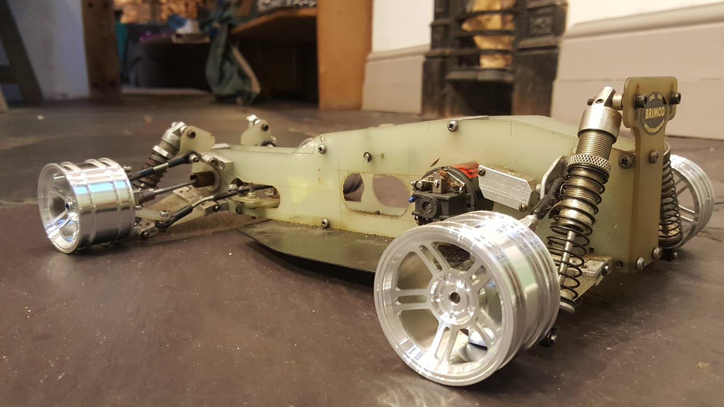

Not too much of an update with this, but I have had a set of alloys machined which really seem to set it off
I haven't even cleaned it yet, or even straightened the bent steering arm(!), although i do now have the correct and extremely rare rear shocks here ready to fit, complete with hex adjusters.
I am heading away to work for a few weeks today and have the car, rims, shocks and a few other parts stashed away in my bag, so my plan is to spend my off time stripping, cleaning and rebuilding the car, as well as trying to figure out how the alternative chain drive mechanism/gearboxes work!
It should be quite the looker when finished. I still cannot quite believe i have managed to get my hands on this car
