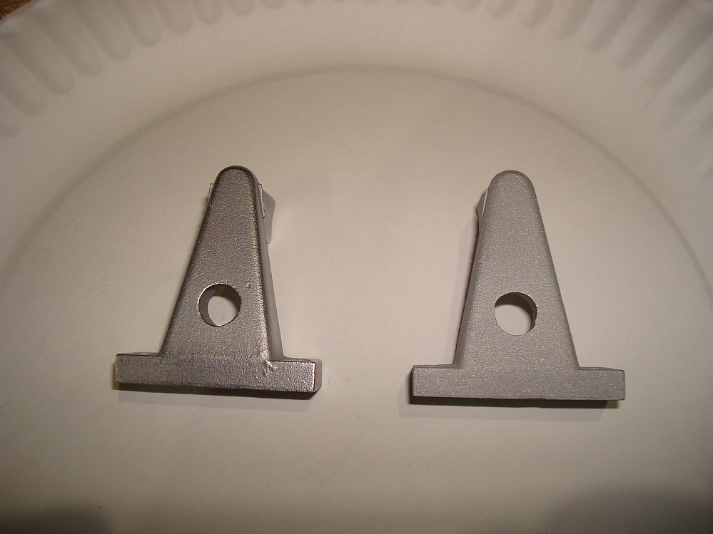

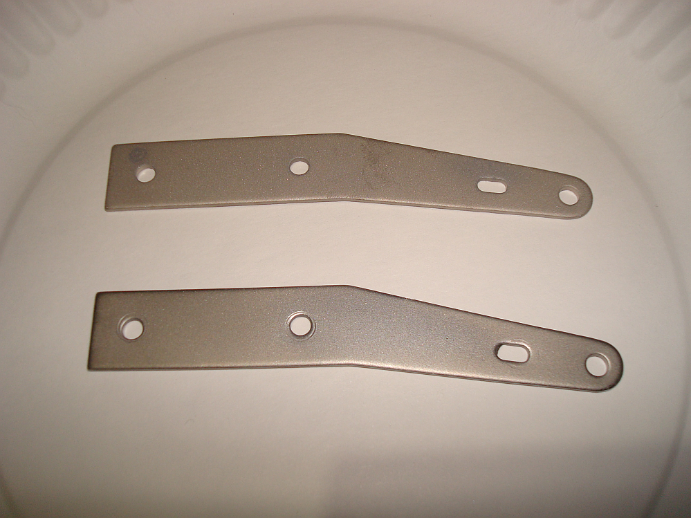

Rear bumper and cage mount brackets. These were originally chrome that made them look cheap. They were also both covered in stains. The top is blasted, the bottom is after buffing with the steel wool:
Side cage to frame mounts. These had ugly marks on them possibly from the factory, and were also stained. Unfortunately one of them has a split from the stress of roll overs. Not that big of a deal but I'd like to replace it in the future. Blasted on the right, final finished on the left:

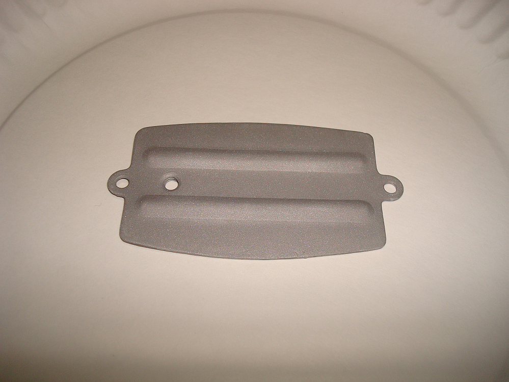

Transmission housing cover. This was in bad shape. It was bent, scratched, tarnished, and had CA glue on it. I used acetone to remove the glue, a body hammer and dolly to straighten it out, and then blasted it to remove the rest. I don't have an individual pic of the cover after final finish but you can see it in the group shot below:

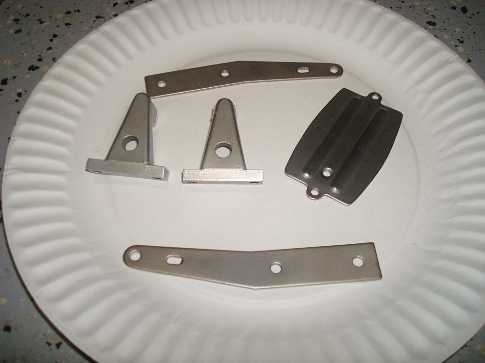

Finished group shot:

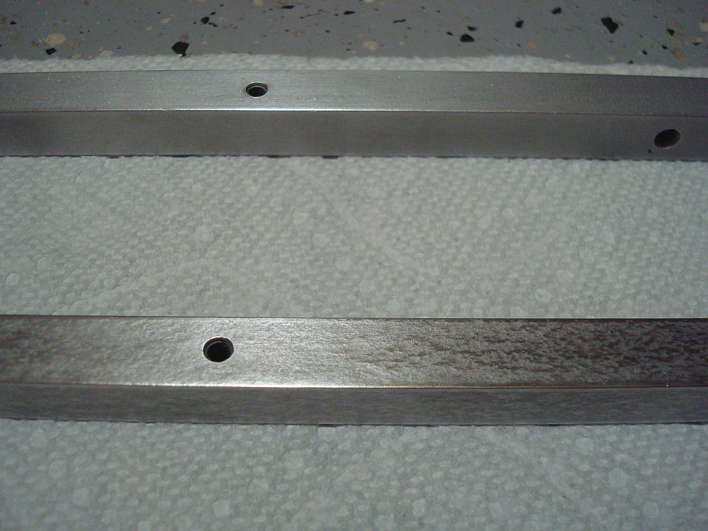

One is smooth and looks how it's supposed to but the other rail has a bumpy texture. A grain in the aluminum is the best way I can describe it. It came from the factory this way, and between the original raw aluminum finish, and how marked up and grimy they were, I never noticed it until now. It's upsetting as after finishing both rails, they're two different shades from one another as a result.

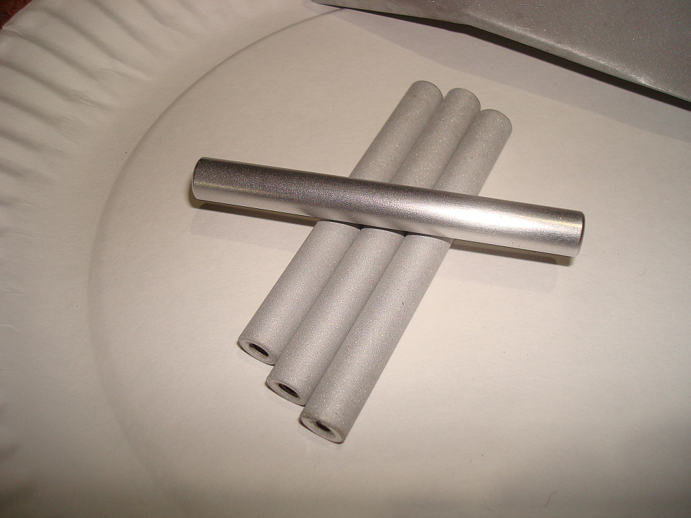

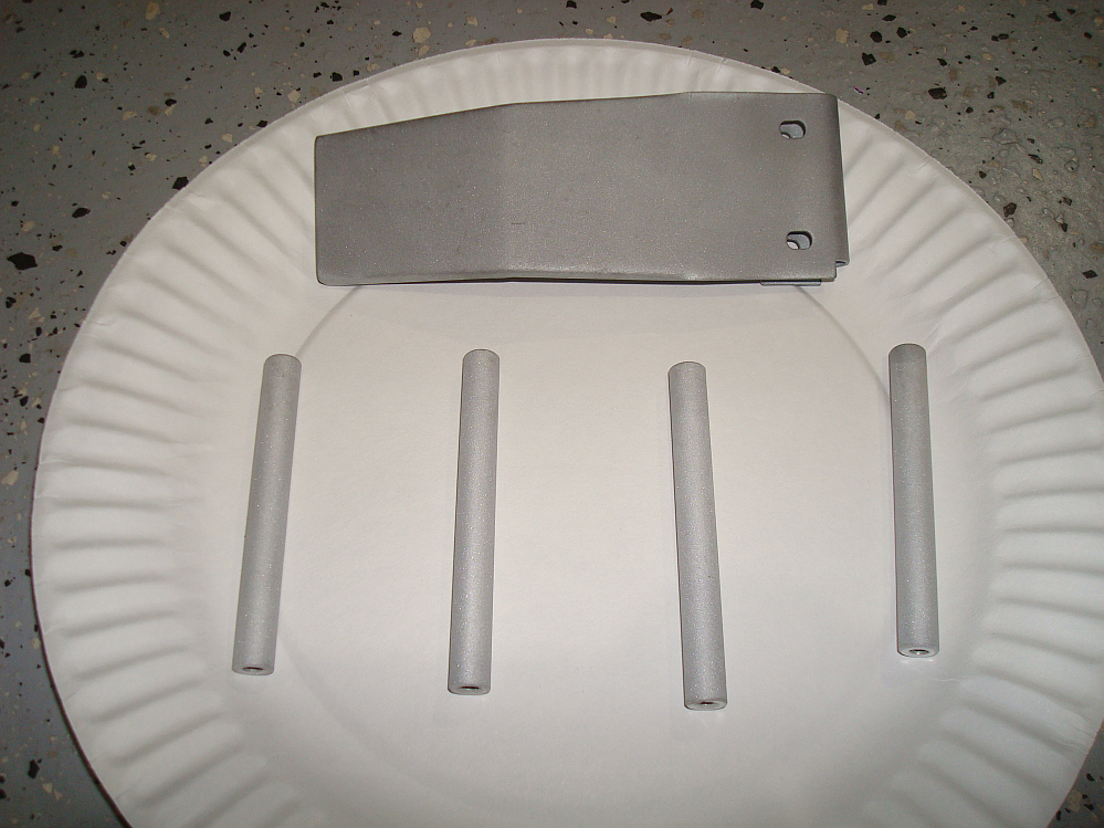

Cross braces and skid plate after blasting. The skid plate was one of the worst parts cosmetically:
Cross braces blasted versus finished:
Frame rail problem. You can clearly see what the issue is. they're both finished. The one on top is how both are supposed to look. A nice uniform silver finish. The bottom one has the texture, and it encompasses all four sides. That isn't the reflection from the paper towel:
This project has become a can of worms that's been a monkey on my back for nearly 5 months now but I can't quit as I've already spent countless hours and hundreds of dollars so far on it.
I know I'll feel better once I can start putting it back together again but that won't be for a seemingly long time.

Looks like your frame rails were cast differently. I've also seen aluminum surfaces with that texture. At any rate, you should be able to get the weird textured one to match the media-blasted one with wet-sanding. Looks like you'd need to start with 200 or 400 grit until you get a uniform finish, then work your way up until you match the other rail's finish. It looks like 600 to 800 grit satin finish to me. Or you could go the whole 9 yards and polish them both right up to 1000 or 1500 grit, and get a polished aluminum/near chrome-like finish.

Re: Thunder Tiger Challenger restoration
Thanks
The frame rail in the background has not only been media blasted, its been buffed with the steel wool as well to the finished surface. Both frame rails have been, but you can see how the one with the poor casting turned out a lot differently. If I attempt to try and fix it, I'd do what you suggested with the 200-400 grit wet sand until I got it down to a uniform surface. I would then media blast and steel wool buff it again. I don't want to go the polishing route with this build as I always do that. It's like I'm a one-trick pony when it comes to aluminum, so for the first time I'm trying something different. Either way, I'm just afraid that sanding it down until I hit a uniform surface will take too much material off. Especially since I have to do all four sides. It's even worse than the picture shows. I tried sanding a little in an area that will be hidden, and some pits go pretty deep. I suppose it won't hurt to try fixing it as I can't bring myself to use the rail in its current condition. I just don't want to wreck it, and then be screwed. I'd have to wait for a parts buggy to come up for sale for a replacement rail if that happens. I'll have to mull it over a bit before proceeding.Coelacanth wrote: ↑Tue Mar 24, 2020 3:57 pm Looks like your frame rails were cast differently. I've also seen aluminum surfaces with that texture. At any rate, you should be able to get the weird textured one to match the media-blasted one with wet-sanding. Looks like you'd need to start with 200 or 400 grit until you get a uniform finish, then work your way up until you match the other rail's finish. It looks like 600 to 800 grit satin finish to me. Or you could go the whole 9 yards and polish them both right up to 1000 or 1500 grit, and get a polished aluminum/near chrome-like finish.

For interest's sake, have you measured the thickness of each frame rail with a caliper? If you're lucky, the weird-textured one might be slightly thicker due to the raised textures, and by sanding down the textured surface, you'd actually be getting both rails to be more or less the same thickness.

the frame rails are not cast, they are extruded square stock. I've seen this in the past, it's the alloy, and how it was pushed through the die, sometimes you get this type of marbling on the finish.
You're best bet is to sand both down and then bead blast, and you should get pretty much the same finish at that point.

That's a good idea I hadn't thought of! Unfortunately I'm not a lucky person.Coelacanth wrote: ↑Wed Mar 25, 2020 10:10 am For interest's sake, have you measured the thickness of each frame rail with a caliper? If you're lucky, the weird-textured one might be slightly thicker due to the raised textures, and by sanding down the textured surface, you'd actually be getting both rails to be more or less the same thickness.
Marbling is a really accurate way to describe the finish. It appears as if it's going to come down to sanding both so that they match if I want to fix these ones. I'm definitely not enthusiastic with the amount of effort it's going to take as I'll have to do both all over again on top of the sanding. This is one of those times a mill would have come in really handy. I'm going to hold off on it for now while I complete other parts of the restoration. Maybe in that time something will come up on eBay. There's a parts buggy on there right not but it's in way too bad of shape. I was also thinking of buying the complete one that's on there with the wrecked cage, and swapping its frame rails with my wonky ones, and then reselling it. That's going a little overboard though.jwscab wrote: ↑Wed Mar 25, 2020 10:18 am the frame rails are not cast, they are extruded square stock. I've seen this in the past, it's the alloy, and how it was pushed through the die, sometimes you get this type of marbling on the finish.

I know its not what you want but you could paint the frame rails ,two coats of paint would probably cover the marbling .

if you hold them in a vise with some cushion on the jaws, you should very easily be able to use a sharp file add draw file the profile to a nice uniform finish. it' won't take long at all. look up the draw file technique. essentially, you hold the file perpendicular to the orientation of the object and pull it towards you with both hands. it leaves a really nice finish and you have really good control.
