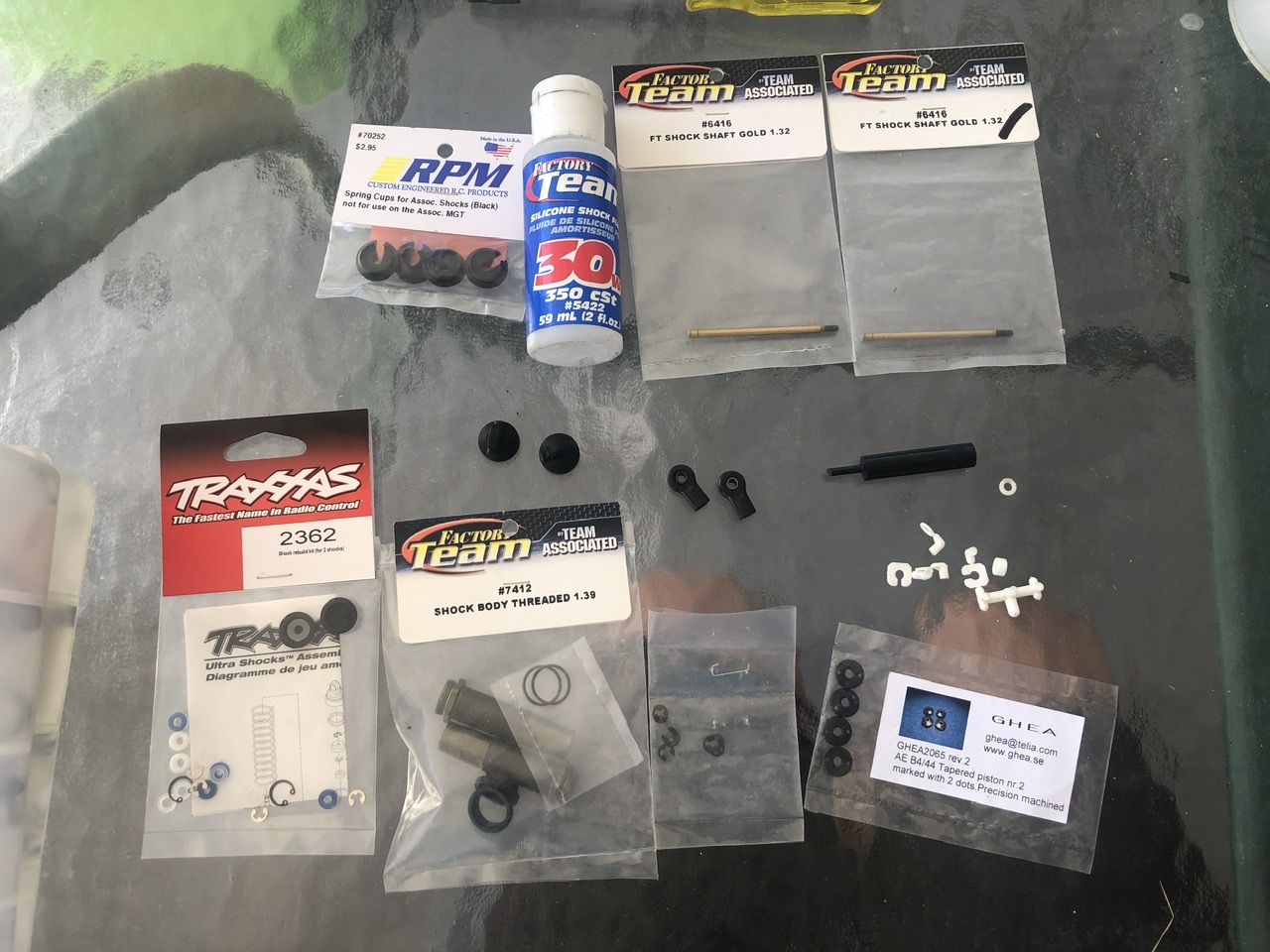

Piece by piece this is getting there. The #2 shock pistons were
GHEA 2066 Team Associated Tapered Delrin Machined Pistons 2 Hole T4/B4/B44.1.2
or
GHEA 2065-F Pro Team Associated Flat Delrin Machined Pistons T4/B4/B44.1.2
I picked up a pair of each and I'll see which one runs better.

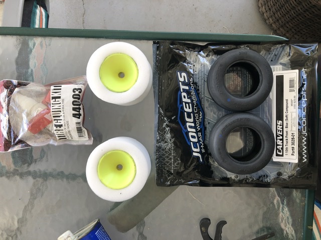

Also the tire inserts are no longer made by pro-line they are
https://www.prolineracing.com/inserts/2.2-pre-glued-2-stage-rear-inserts.asp
Proline part 6184-00 | 2.2" Pre-glued 2-Stage Buggy Rear Inserts

Some small progress.
The old tires were unglued and the blue carvers were mounted

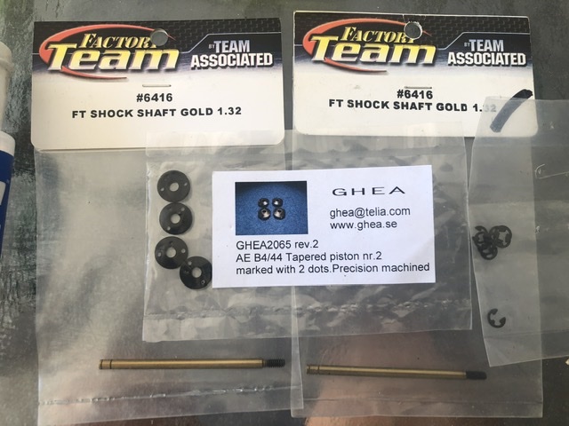

A little bit more. I was basically going to just use the stock shocks and wound up building a complete set of v1 threaded 1.39 rear shocks.
I found some inexpensive threaded 1.39 bodies. The machined tapered #2 pistons, the titanium nitride shafts, molded shock caps and shock cups.
With all of the parts together I started on the shock shafts all nip.
I got the shafts of of the package and was surprised that the shafts were gritty.
I gave them a spin in the drill with some metal polish. You can see the before and after.
I had some shock rebuild parts but I tried using the pieces from the traxxas shock set and it simply didn’t work. I had to scavenge the spacers from another set of shock for the build.
with the traxxas spacers the shafts did not move freely.
Once replaced with associated parts the shocks were free moving.

The Traxxas parts are made for 3mm shafts. The older AE shafts are 1/8", which is slightly larger.
I have reamed the spacers to 1/8" before.
