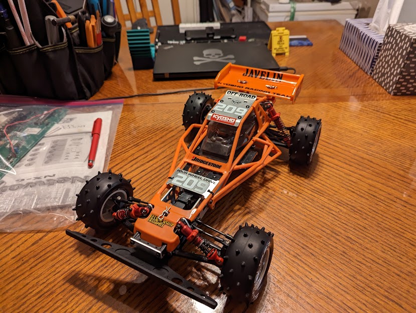

Ran the Javelin today, and broke the front led holder (the garden is in a slope, and the home track is not easy to handle as turns are uphill or downhill, and the result is that the car tend to go off track and fly easily. That makes a good crashtest. Rear led holder is not exposed at all, so it was fine).
Reinforced version incoming soon on Thingiverse

PETG, to allow some flexibility (PLA would break more easily). The fact is my first print was too thin, and the light bucket I used required to drill a hole for alignement. The drill hole is exactly where the part broke, and I suspect it is linked. I still reinforced the part by adding thickness..

When you like to run a car, and that it's roll cage based, and by essence close to the box art, and you go to vintage events there is fair chance you see few Javelin of the same color... I converted mine to red, and in anycase I'll have the orange roll cage with me... I also replaced the front led lights support (broken too easily on a jump on the track at some point) by some TPU printed ones which should be far more resistant...
Still a a few stickers to add on top of this... I love red cars
