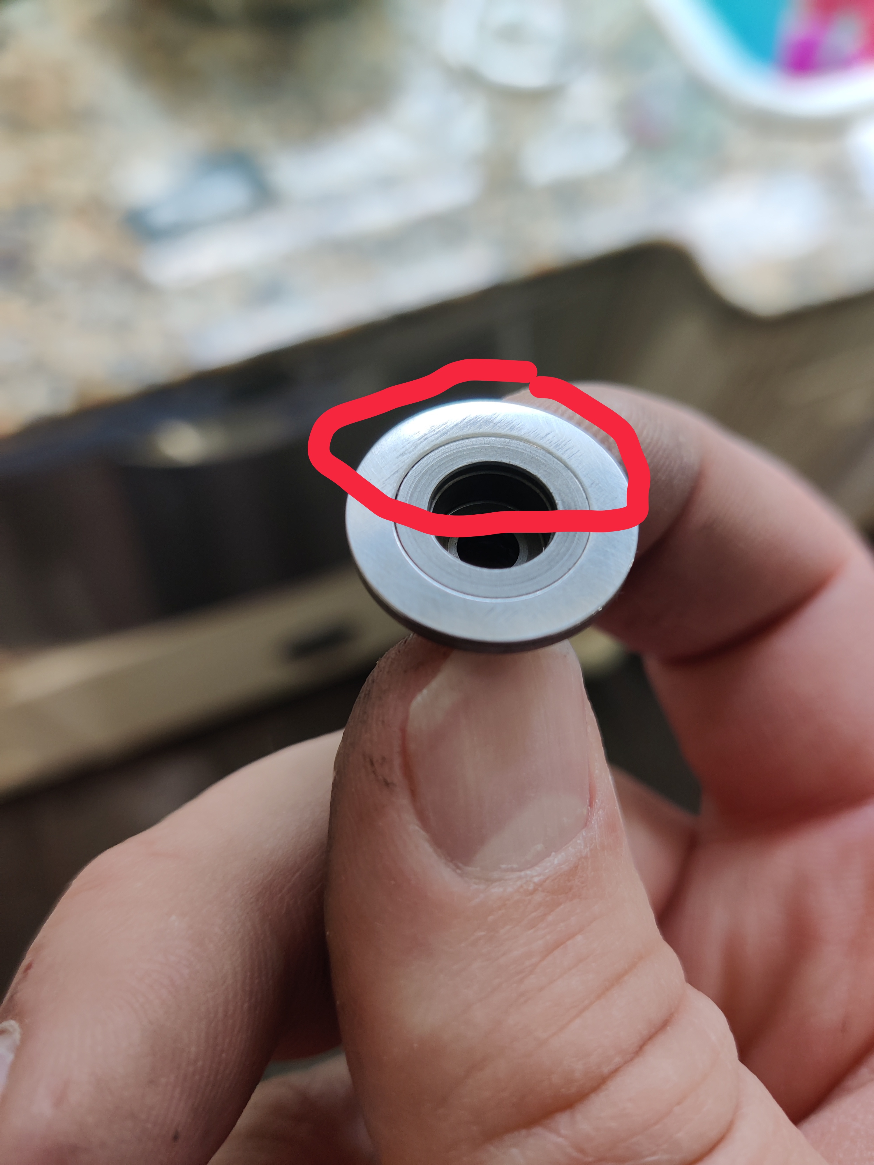

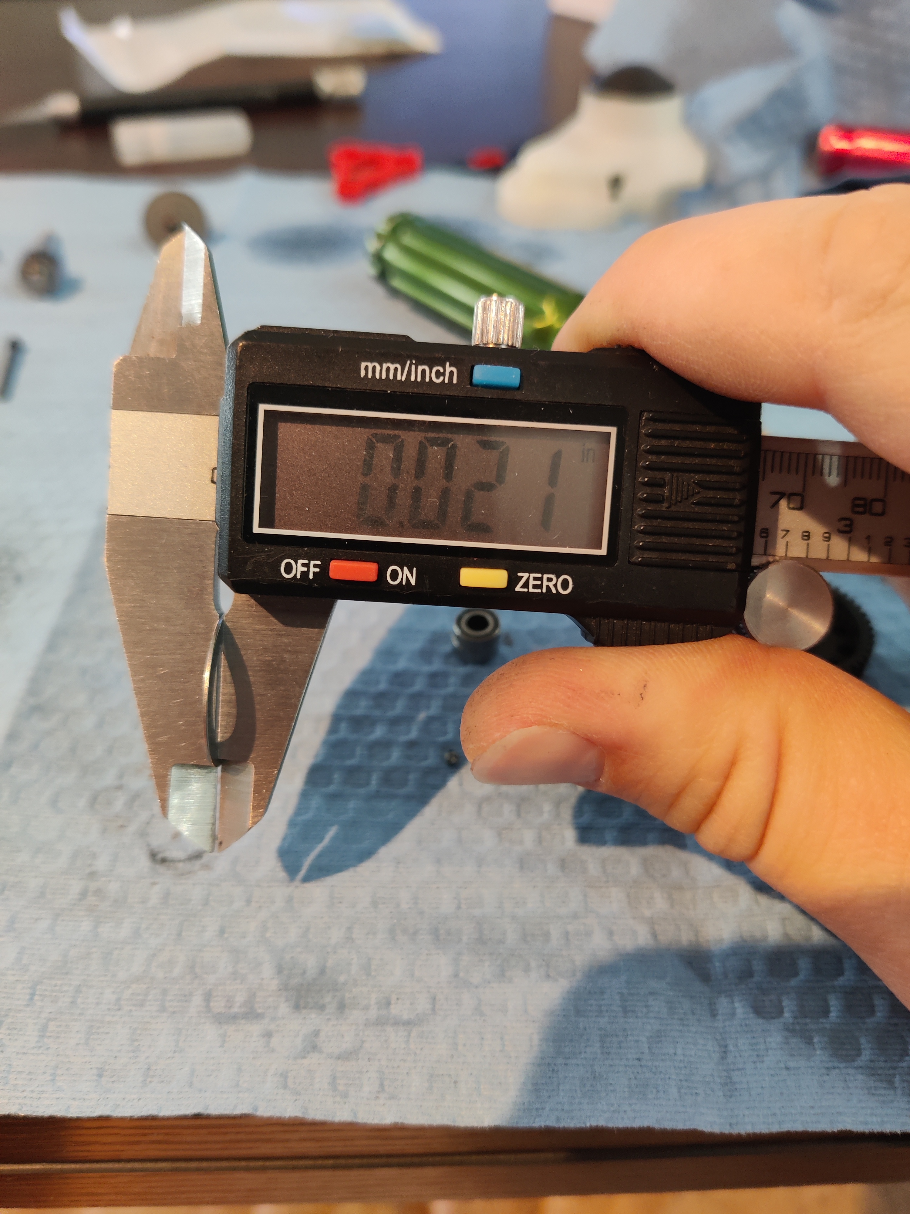

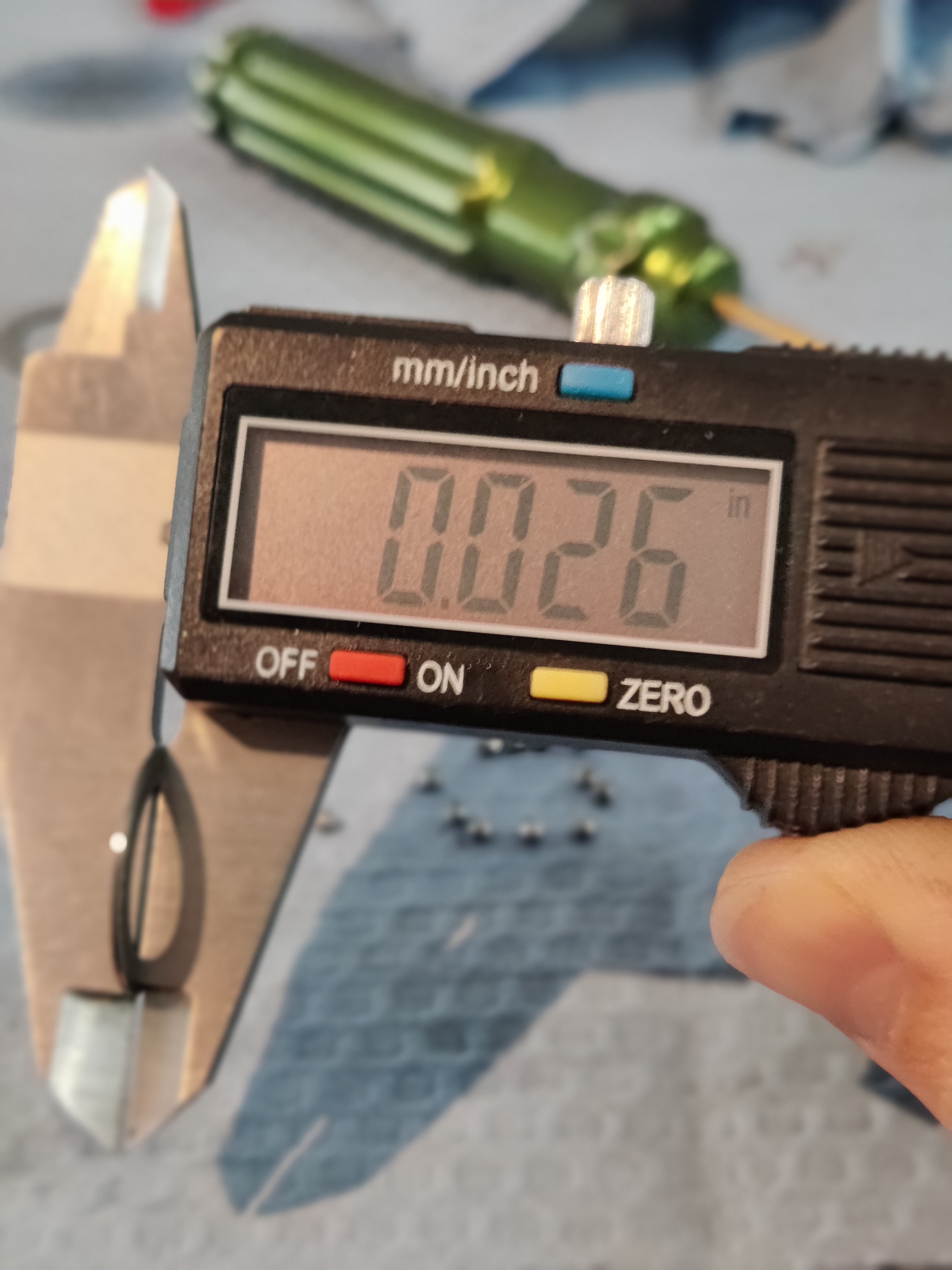

I went ahead and ordered a set of the McMaster Carr rings listed earlier (https://www.mcmaster.com/90482A432/) and they seem to measure the same +-.002" in all dimensions except for the thickness. The McMaster Carr rings measure .005" smaller. I did have to sand a few manufacturing groves out of the rings using 1000 grit sandpaper but they weren't very deep (you can see them circled in the attached picture after a little bit of sanding). I'll run it around the house a little bit and see how they do! I may end up racing it the first weekend of April if everything goes well!

Brocklee wrote: Sun Mar 06, 2022 3:29 pm I went ahead and ordered a set of the McMaster Carr rings listed earlier (https://www.mcmaster.com/90482A432/) and they seem to measure the same +-.002" in all dimensions except for the thickness. The McMaster Carr rings measure .005" smaller. I did have to sand a few manufacturing groves out of the rings using 1000 grit sandpaper but they weren't very deep (you can see them circled in the attached picture after a little bit of sanding). I'll run it around the house a little bit and see how they do! I may end up racing it the first weekend of April if everything goes well!
I just ran a pack through the car and everything seems normal which is good! When rebuilding the diff I broke it in somewhat on a drill before putting it in the car and after the running a battery through it I noticed it did loosen up slightly but that is all normal. I'll report back after I take it racing on the first week in April!
