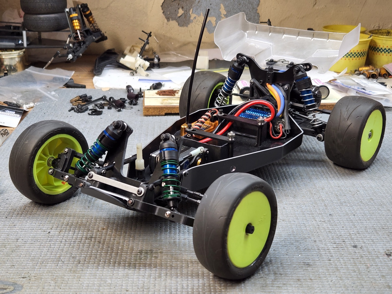

MarkyDents wrote: Thu Dec 30, 2021 12:18 pm Looks great ! What kinda arms are those ?
Prototype Factory Works arms. Similar to the RPM Worlds, Klein arms.

I was wondering is a t4 transmission could fit a t2 chassis. It's good to see how it's done.

Interesting how you've retained the B4 wing mounts instead of using the B5 wing mounts. Looks like it all blends together nicely.

RC10th wrote: Thu Dec 30, 2021 6:05 pm Interesting how you've retained the B4 wing mounts instead of using the B5 wing mounts. Looks like it all blends together nicely.
It still may end up going that route if I don't find a wing with a super deep drop center. Jeff modified one of my tower designs. Trimming 5mm off the top to lower the body and gain some more clearance. The tower was initially higher than the mounts. Now the mounts are slightly higher.

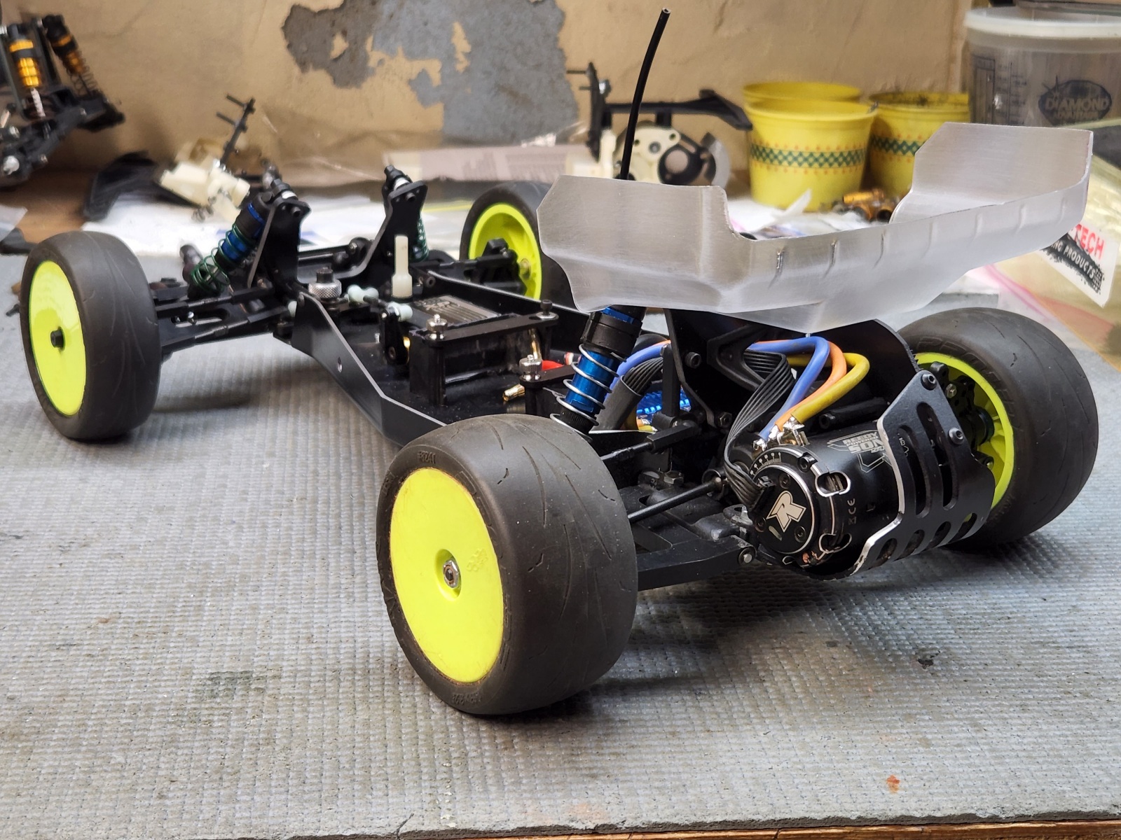

Are B4 T4 and SC10 gear-diff transmissions the same or is there a difference?
Posts: 16841
Been thanked: 1341 times
Re: RC10 B1.5 #7
XLR8 wrote: Fri Dec 31, 2021 10:26 am Are B4 T4 and SC10 gear-diff transmissions the same or is there a difference?
They should be the same.

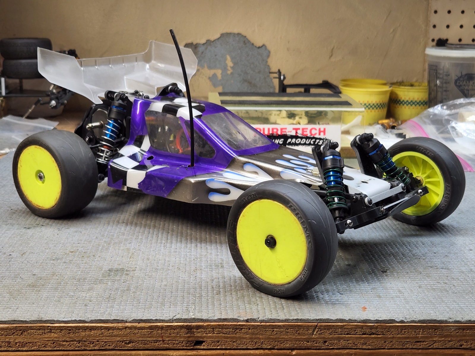

Little update on this. I've not been to the track at all so far this year. But I will be headed to the Vonats next week, so I wanted to take this along to try out. I got an old b2 body mounted up, I think the wing is for a newer Tekno buggy, and temporarily stole the electronics from my B2. Looking forward to see how it runs.

The rear shock tower is your own design but what is the rear body mount from?
Posts: 16841
Re: RC10 B1.5 #7
Frankentruck wrote: Mon Sep 12, 2022 8:16 am These B1.5 are so cool!
The tower is already drilled for a 10t style body mount. That wasn't gonna work this time, so jwscab made one for it out
of square 1/4" nylon.
