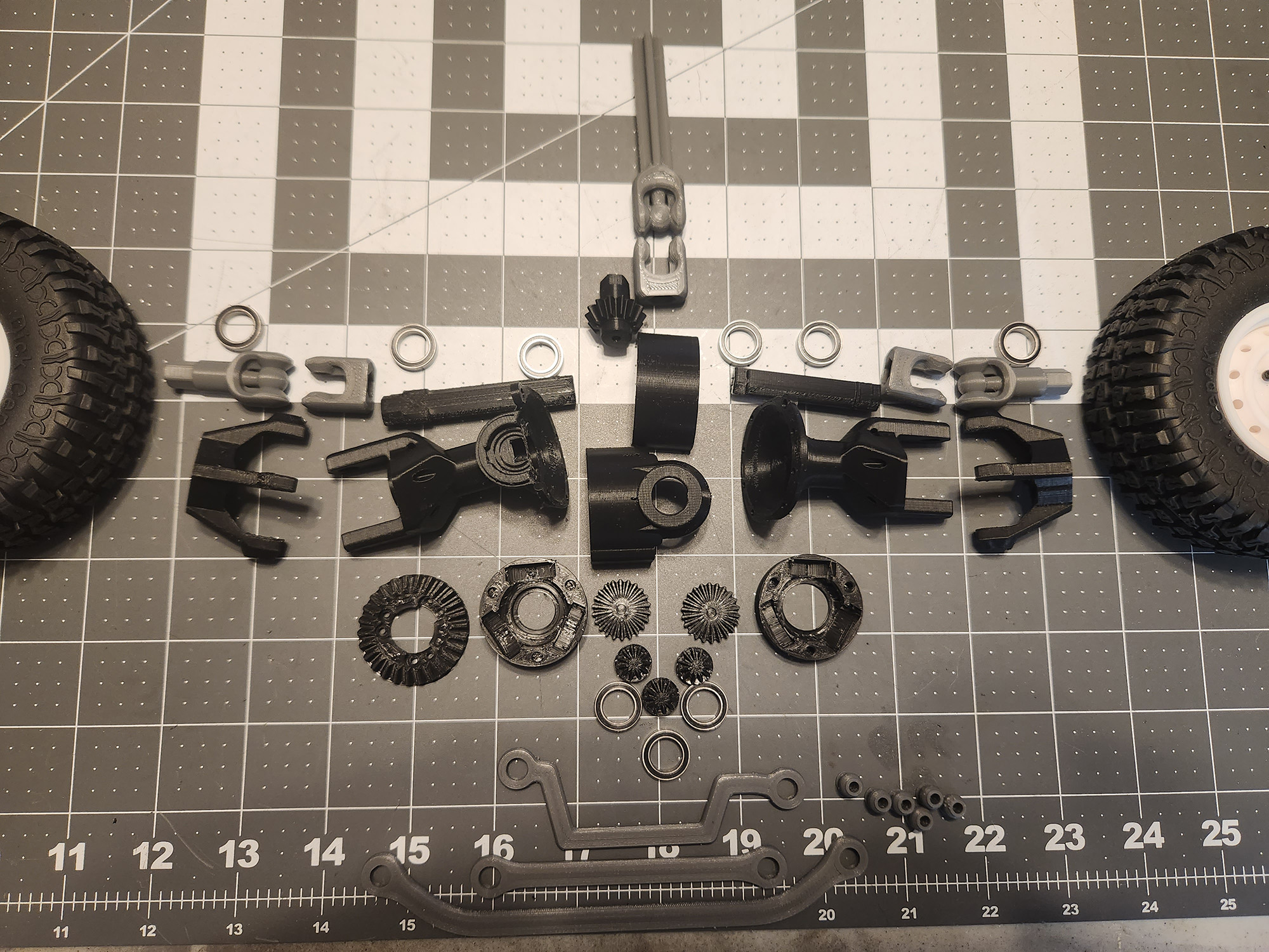

All the printed parts needed for just one axle. The gears should maybe be made with something a little tougher, but just out of laziness, they were printed with a tough PLA just as the cases were, which I think will ultimately be fine. If they are too weak, I don't think they will destroy too much at 2mph.
![Very Happy :D](./images/smilies/icon_biggrin.gif)
A simple reprint with a stronger filament will all that will be needed.
