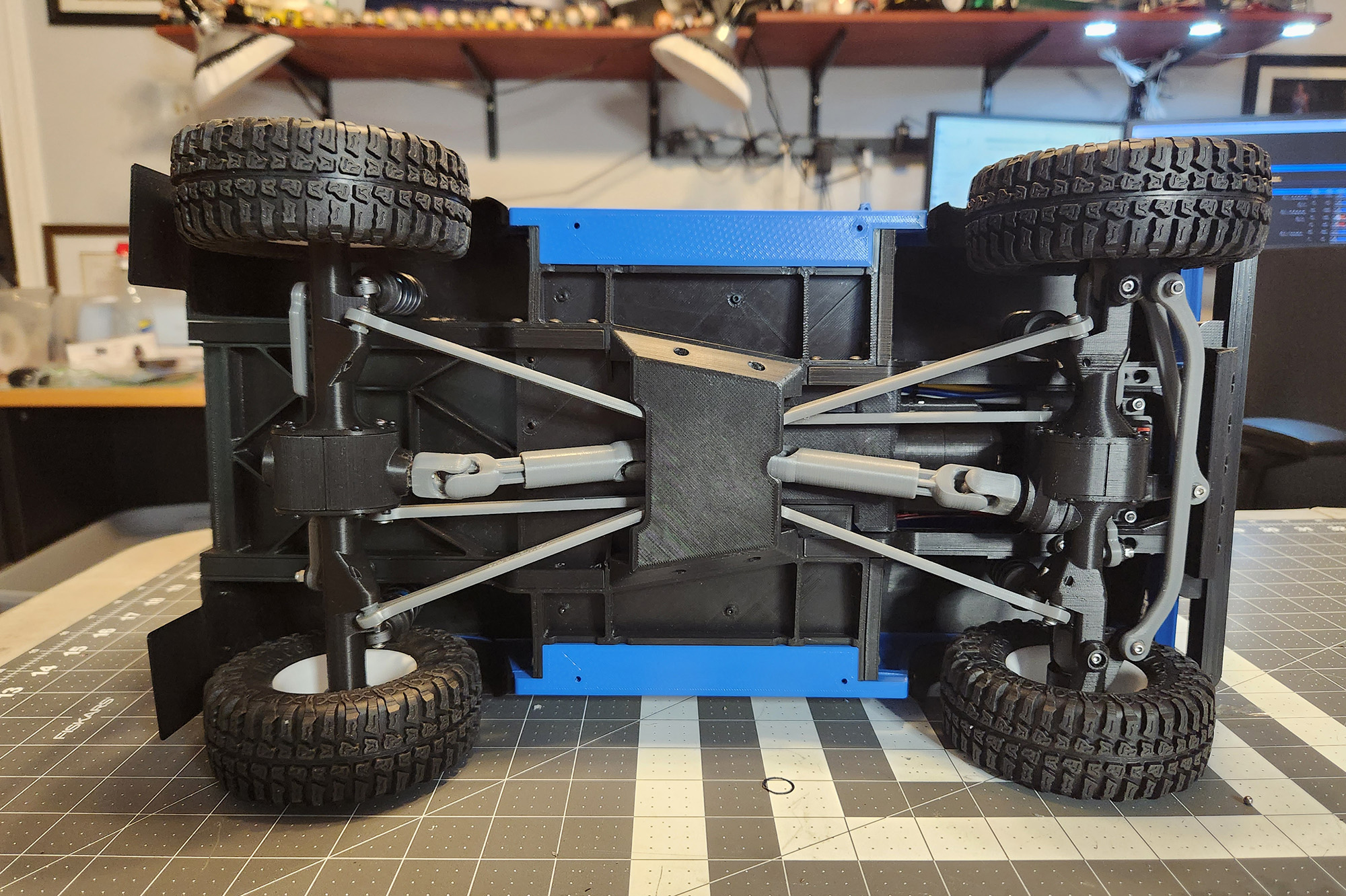

morrisey0
Posts: 1311
Location: Richmond, VA
Has thanked: 54 times
Been thanked: 1285 times
Re: 3D Sets Landy Build
Post by morrisey0 »
She's on her feet! :D
