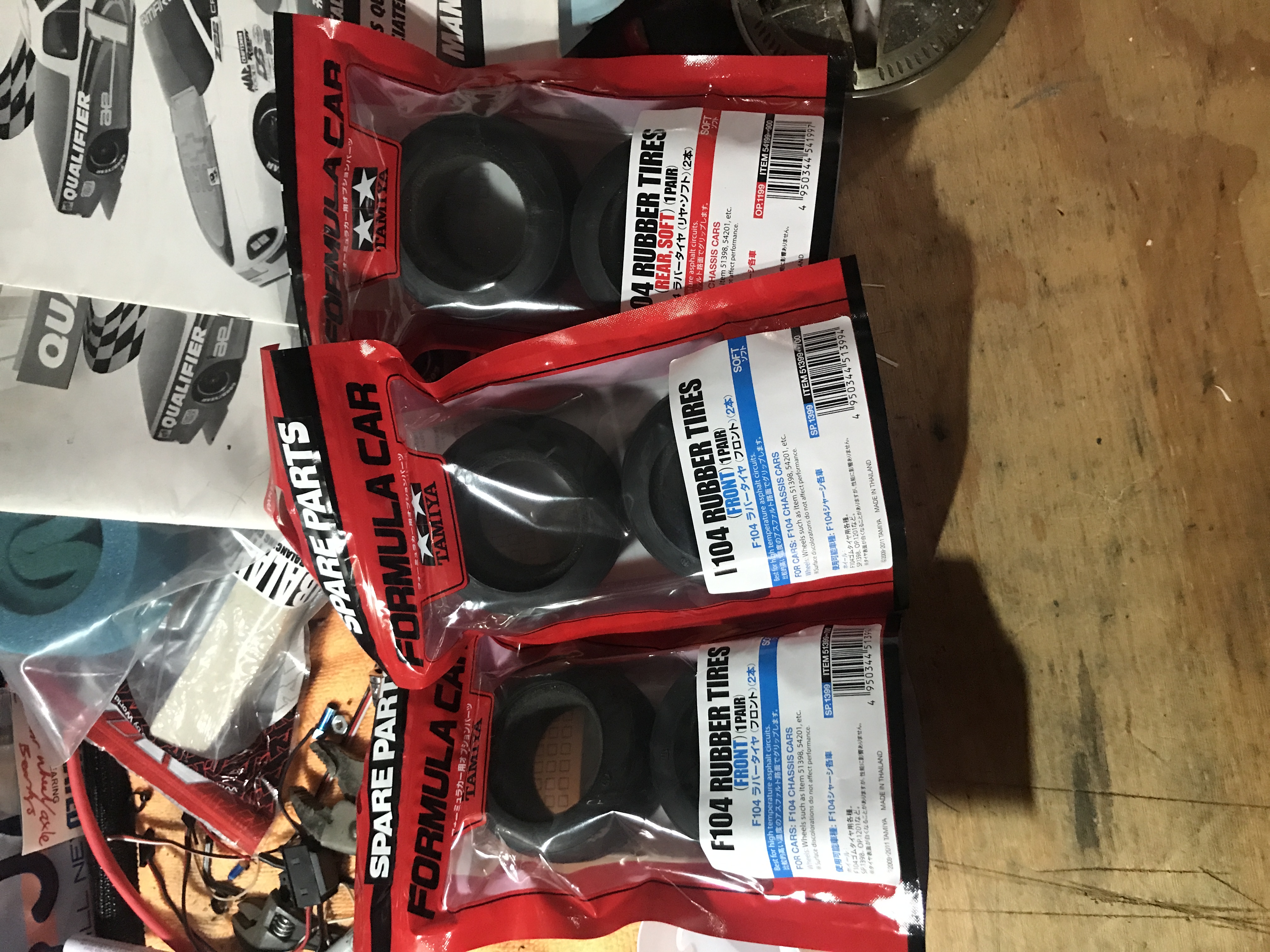

Re: RC10 DS steering wander - won't return to center, not trim issue
I have heard the the tamiya F1 tires may fit the original rims. There are a number of ways to fit hexes to the DS and they cost similar to what you found.tripedaler wrote: ↑Sun Sep 03, 2023 8:15 pm Been enjoying the DS - perhaps a bit too much as I’m chewing through the original rear Road Hawgs.
I’m considering a hex conversion to open up my tire options. I’ve seen the detailed conversions, and may go that route eventually, but has anyone tried this rudimentary product on the DS?
https://www.etsy.com/listing/1037227532/12mm-hex-wheel-adapter-kit-vintage-team

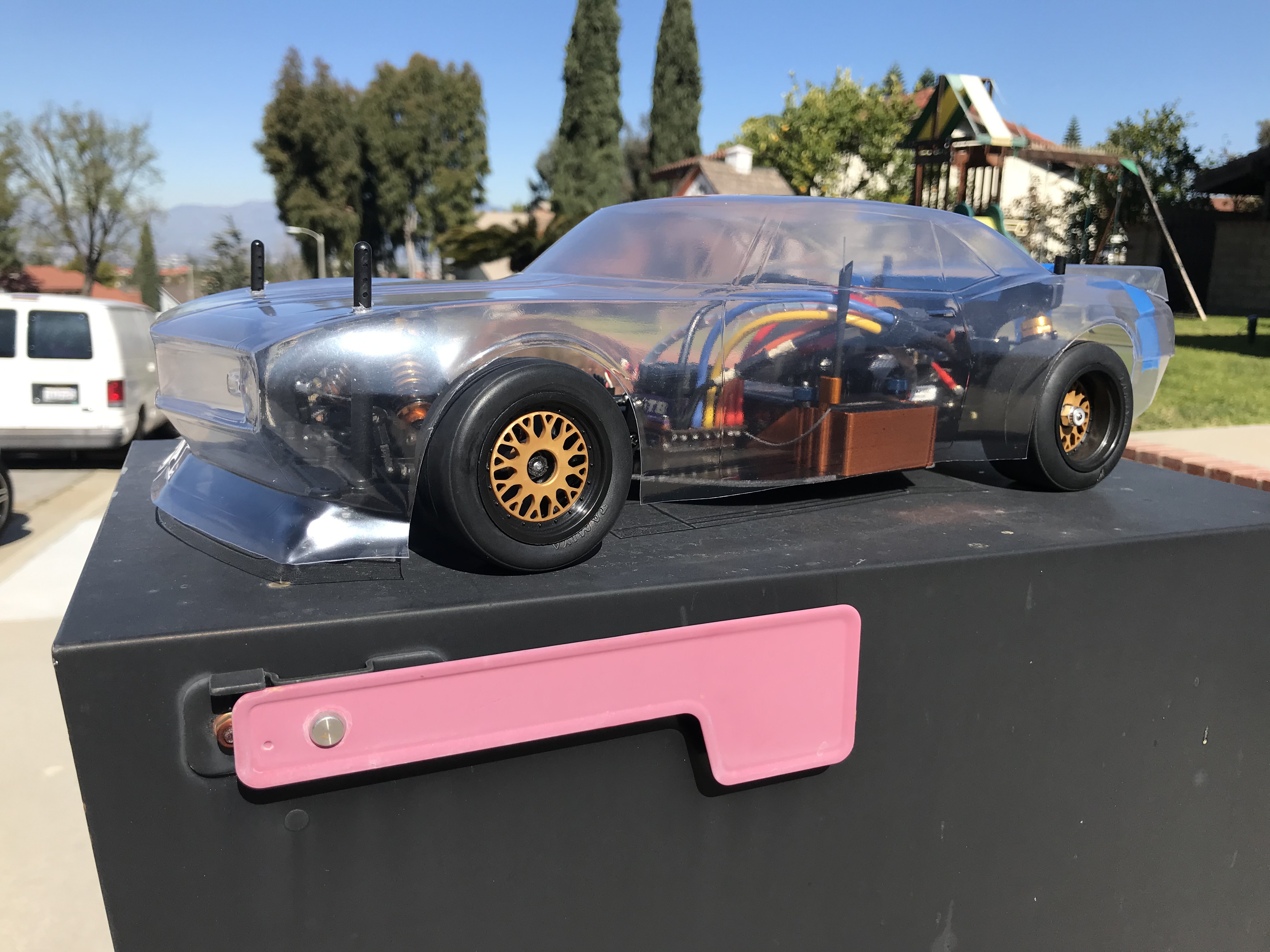

Yes sir I’ve been running and recommending the Tamiya F1 tires on stock rubber DS wheels, been greatJosephS wrote: ↑Fri Sep 08, 2023 1:47 pmI have heard the the tamiya F1 tires may fit the original rims. There are a number of ways to fit hexes to the DS and they cost similar to what you found.tripedaler wrote: ↑Sun Sep 03, 2023 8:15 pm Been enjoying the DS - perhaps a bit too much as I’m chewing through the original rear Road Hawgs.
front and rear?KidAgain wrote: ↑Sat Sep 30, 2023 11:16 pmYes sir I’ve been running and recommending the Tamiya F1 tires on stock rubber DS wheels, been greatJosephS wrote: ↑Fri Sep 08, 2023 1:47 pmI have heard the the tamiya F1 tires may fit the original rims. There are a number of ways to fit hexes to the DS and they cost similar to what you found.tripedaler wrote: ↑Sun Sep 03, 2023 8:15 pm Been enjoying the DS - perhaps a bit too much as I’m chewing through the original rear Road Hawgs.
https://www.etsy.com/listing/1037227532/12mm-hex-wheel-adapter-kit-vintage-team![]()
Both front and rear specificJosephS wrote: ↑Sun Oct 01, 2023 12:47 pmfront and rear?KidAgain wrote: ↑Sat Sep 30, 2023 11:16 pmYes sir I’ve been running and recommending the Tamiya F1 tires on stock rubber DS wheels, been greatJosephS wrote: ↑Fri Sep 08, 2023 1:47 pmI have heard the the tamiya F1 tires may fit the original rims. There are a number of ways to fit hexes to the DS and they cost similar to what you found.tripedaler wrote: ↑Sun Sep 03, 2023 8:15 pm Been enjoying the DS - perhaps a bit too much as I’m chewing through the original rear Road Hawgs.
