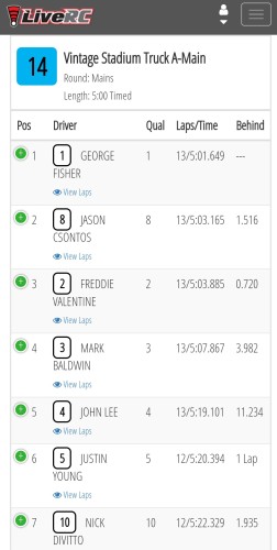

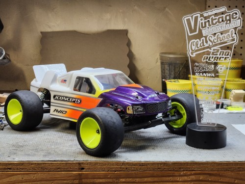

The only good part of my on track festivities. A fun battle for the stadium truck title. Finished 2nd with my T3.

That's a pretty close finish between 1 - 3

RC10th wrote: Mon Apr 15, 2024 5:35 am That's a pretty close finish between 1 - 3
Yeah. Though, it was a bit of a crap show with the layout, surface and lap trucks.
Freddy posted a video on his Youtube channel. To make it easier to follow, especially later in the race, the white truck won, then my truck above in 2nd, and Freddy's T4 with the red wheels in 3rd.

Can you share your T3 setup:
- ESC / motor?
- Gearing?
- Shock springs/oil/mounting position?
And what about tires?
- I did not have good traction with B3...
-dldiaz
Posts: 16810
Re: ** 2024 Vintage Showdown - "The Track" - Gaithersburg, MD - April 13th **
dldiaz wrote: Mon Apr 15, 2024 11:26 am That stadium truck race was awesome!
Jason,
- ESC / motor?
- Gearing?
Esc - Speed Passion Reventon Pro (on blinky)
Motor - 17.5 Reedy S+ (around 40* of timing)
Gearing - 78/24
Front end:
Standard shocks - 30w/#3/blue
Outer hole on tower, middle hole on arm
Middle camber hole on tower.
30* castor blocks
Kingpin - spacer top and bottom
Tires - Jconcepts Smoothie 2's (silver compound)
Added lots of weight :wink:
Center:
2s shorty lipo about 1 3/8 back from the front.
Rear End:
Standard shocks - 30w/#1/green
Middle hole on tower
Inner camber hole on chassis
Inner camber hole on hubs
3 x 3 arm mounts
0* rear hubs centered in arm (spacer front and back)
