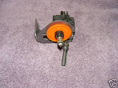

JK Racing
Posts: 4619
Location: Placentia, CA
Has thanked: 139 times
Been thanked: 246 times
Re: JRX-T question
Post by JK Racing »
like this???? my recent $1 ebay win...
x2 tranny slipper.jpg (26.87 KiB) Viewed 1108 times
--Joey --
Vintage A&L and Factory Works
JKRacingRC.com

JK Racing
Posts: 4619
Re: JRX-T question
Post by JK Racing »
That one is destin for my Pro SE, the current tranny guts are toasted. This one will have a double slipper put on, it will be a runner. (yes, brushless lipo)
If I could get my hands on a decent graphite chassis, I would be building a JRX2/T in a heartbeat. 5 link, not H arm.
