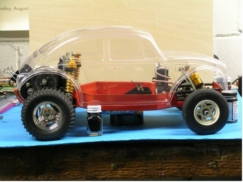

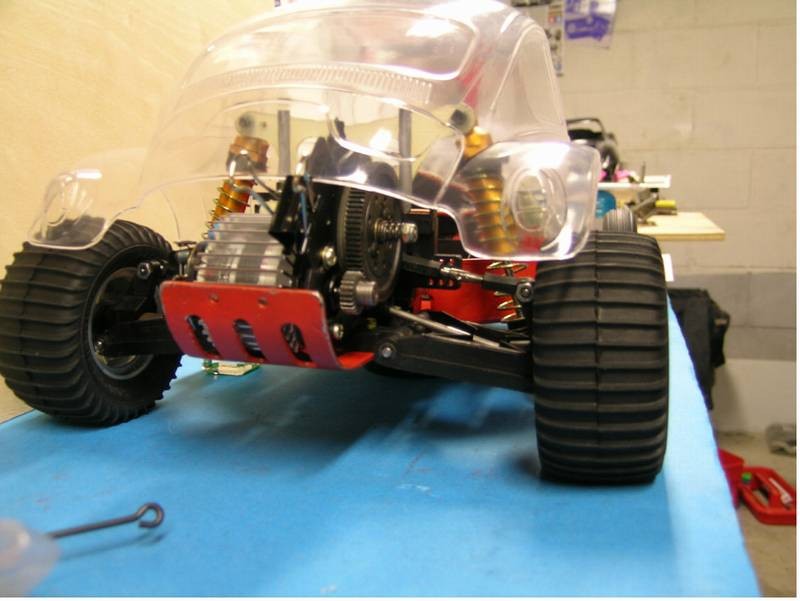

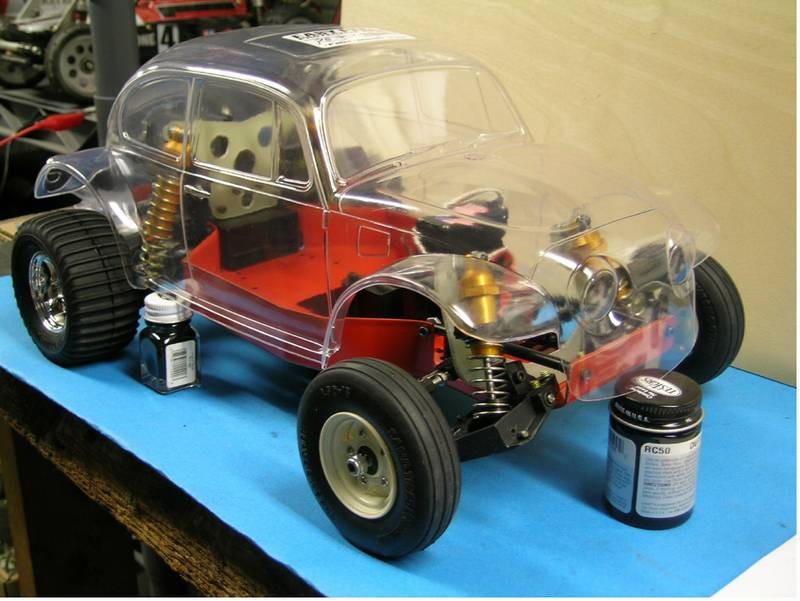

Hi fellas, A little update on this sweet ride!
....An extra bonus is that the front and rear track width match well together with the old but solid RC10 suspension and the 27mm shorter chassis modification. It is roughly 10mm wider than a Tamiya S.Scorcher track width in the front and the back, so it should spank the tamiya sand Scorcher in overall handling. No contest. (if you are wondering about the rear rims, its because the Tamiya Wild Ceptor rear rims are the only kind I have available to me right now that clear the RC10 suspension. And that fit a paddletrack tire. I would have used 1st gen RC10 rims if I had an extra set. Had to use HPI rear RC10 /hex adaptors to mount the Wild Ceptor rears to the AE stub axles.......
