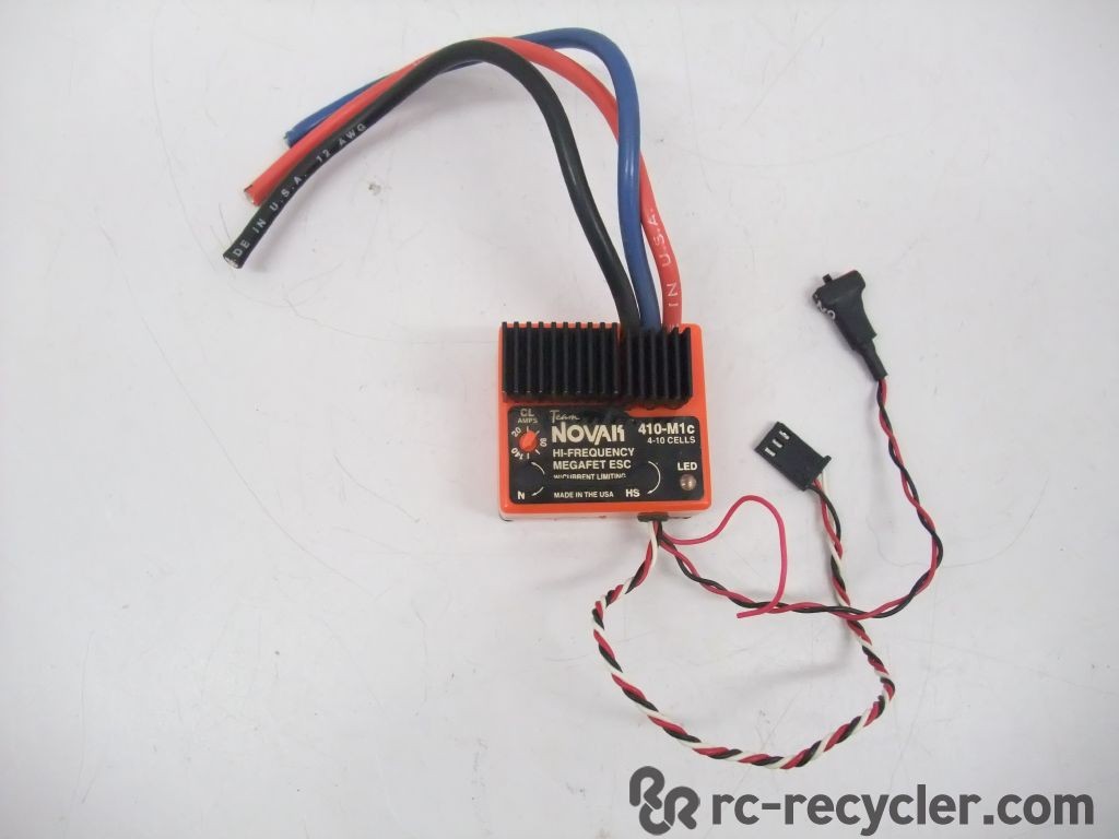

The Novak Speedo would probably be a 410-M1c, or 410-HPC (2 time WC that year)

One more- I'd bet it's a 410-HPC since the 1993 410 M1-C was a side-wire and the HPC is a top-wire.
(The earlier M1c was a top-wire but was SPF equipped and prone to popping the fuses, most replaced them in real racing situations)-

I looked at my solder pop 410m1 and did some searching for the m1c
Judging by the wide brake fet heat sink it will be one without the solder pop fuse, and judging by the 3 wire it will be the m1 or m1c, from the angle it's really impossible to tell, either a m1 or m1c would work fine there, a m5 would need the 3 wire conversion.

The speed control should have been a Novak M1c.
