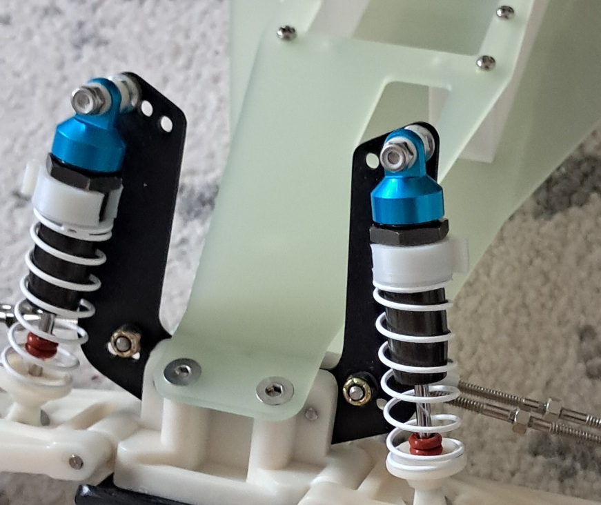

Swapped out some shock caps. These seem to be the hue needed for the purposes of this exercise.
