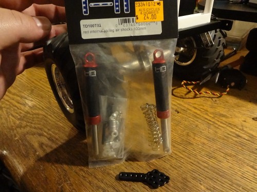

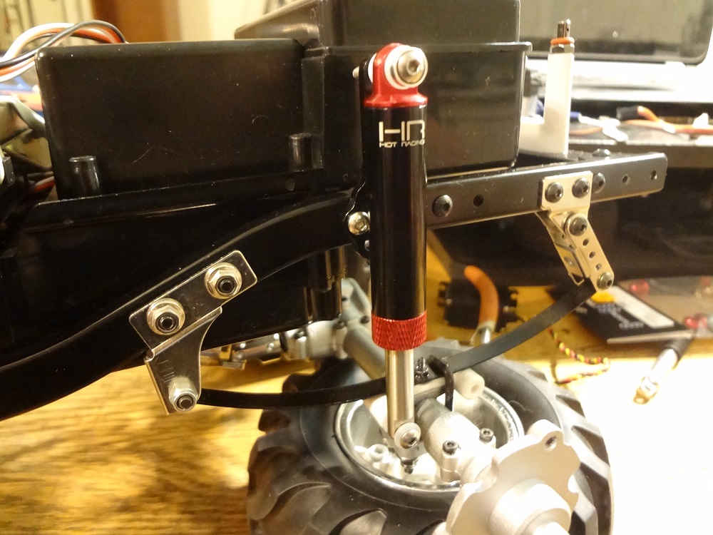

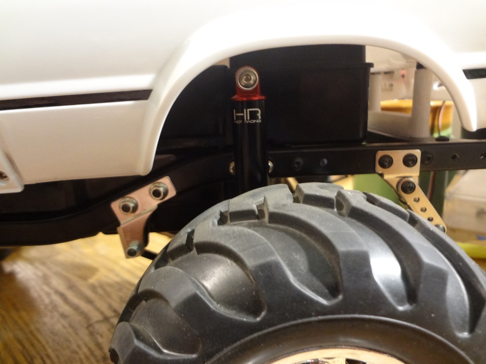

I switched steering servos also. I'm now running a Savox 1258 TG which has 277oz of torque and titanium gears. Steering is no longer a problem of any kind. I decided how to fix the shocks---replace them. I grew tired of trying to make a silk purse from a sows ear. We had our local track rc swap meet on Sat. and through some wheeling and dealing, I ended up with 2 sets of these shocks for free along with an RC Screws stainless screw kit for the axial wraith for $10. I have never heard of "air shocks" for an rc before but these are pretty cool. They use an internal spring and instead of being filled with oil, they use just a few drops of oil to seal the piston and the resulting dampening action is surprisingly smooth. I had a couple axial adjustable shock mounts laying around that I used to set up one corner of the truck to see if it would all work. The results look very positive. Compared to the stock shocks, this setup has a much wider range of motion. The suspension compresses lower and lifts higher due to the new shocks being 100 vs 90 mm along with a higher top mounting point. Tire clearance is close and I have to wait until the new tires arrive to be sure. I ordered a full set of the adjustable shock mounts for a little over $10, so when they arrive along with the new tires, I'll get it all installed and let you know if it all works out.

I've finally got my shocks working but I'm still tempted by those they look nice .
