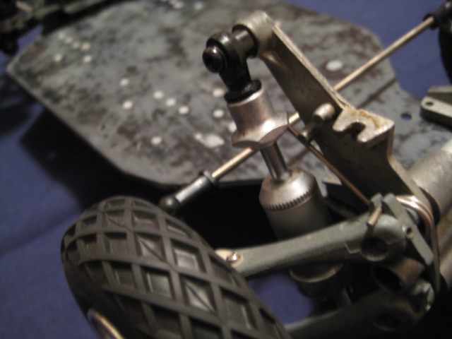

Re: I have an idea...
I think I've got the rear end sorted out...narrowed by about 2" or so.
Dual sport rear arms are nearly perfect!....even room for wheel base adjustment w/Kyosho hubs!

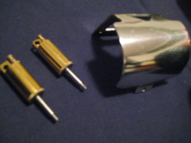

More recycled goodies that may wind up on the project.
Ex trash can ready Triumph motor guard w/about 3 hours of work. (so far)
Old aftermarket front Frog shocks I've had sitting around for a decade or so..(these may wind up on the front end if I don't find the stock 'Scorcher fronts soon. (or use the Platinums..)

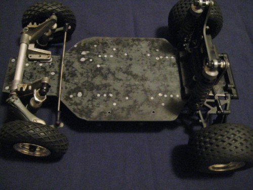

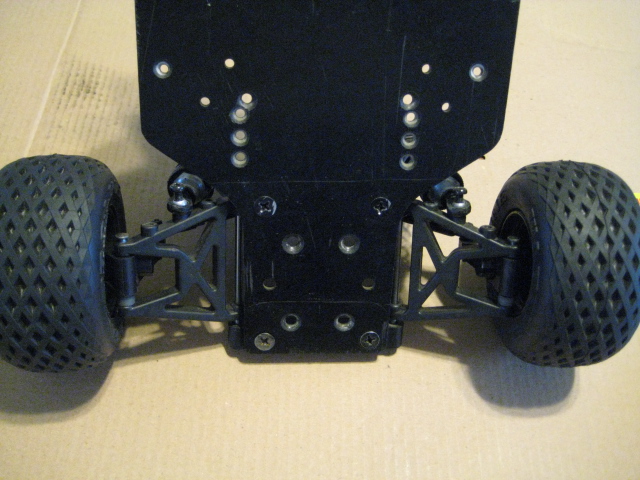

Additional photo of rear track width changes w/DS arms:

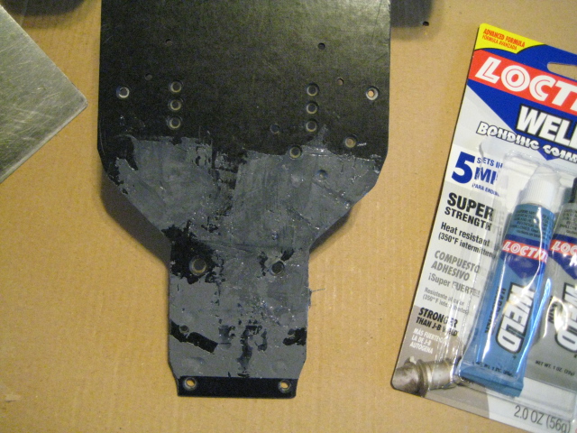

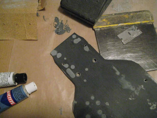

Filling a zillion unnecessary holes w/5 minute (sandable) epoxy:

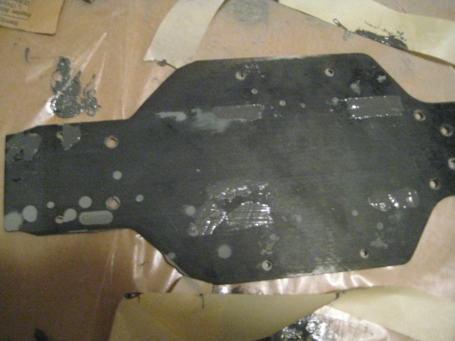

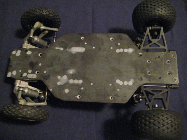

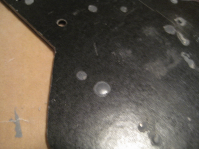

More body work...
Let another coat set up another 16 hours or so..
I love this epoxy stuff..sands easily.
The opposite side of the chassis will be simple to clean up, the epoxy fills the holes & almost looks like plastic plug welds.
Looks good. I need to do this to one f my chassis, are you planning on coating it after sanding? If so what will you use?
Let us know how it works out.
m_vice wrote:Looks good. I need to do this to one f my chassis, are you planning on coating it after sanding? If so what will you use?
Let us know how it works out.![]()
thanks
Thanks.
When everything is filled and double checked, I may prime it and block it out one last time before painting it.
I'm leaning towards a thin coat of black spray-on truck bed liner coating on this one (on the bottom half). I think it will be perfect for a potential runner.
I was checking out Rizzo's latest Sand Scorcher post and noted how cool the polished FT suspension arms looked...I plan on doing something very similar:
http://www.rc10talk.com/download/file.php?id=28603&mode=view

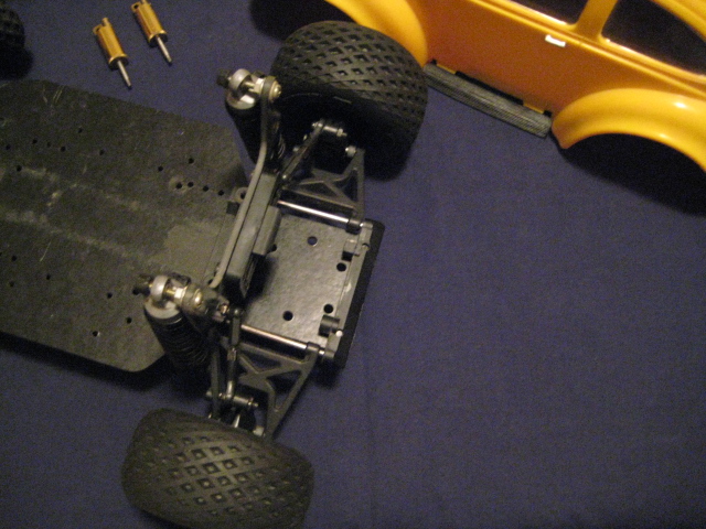

Progress...a lttle more mock up:
