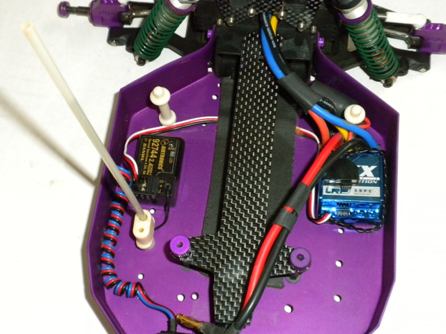

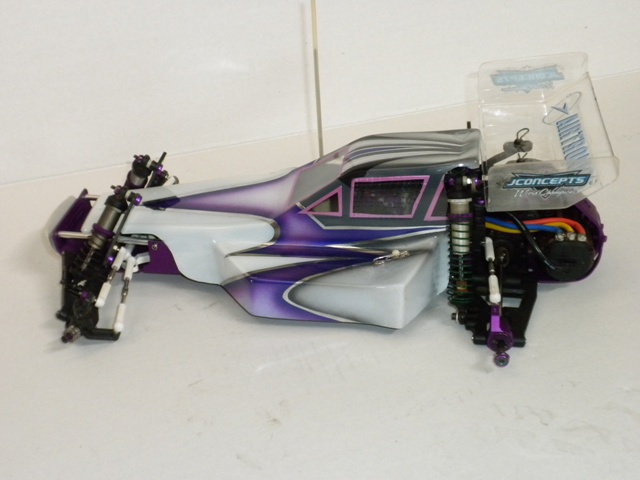

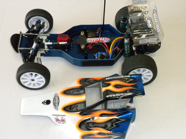

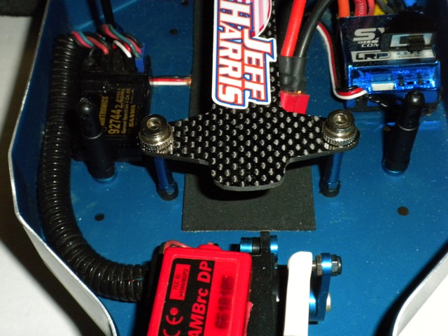

I had a couple questions asked about mounting the body. There are currently a few different bodies that are available for the RC10. The Protech single seater (original RC10 body) is available from Associated for $14 and can be attached using velcro on the sides of the chassis. Next is the Viper from Associated. Also $14, but attachment is a little different. I attach the Viper the same way I do the Mirage SS, which is available as a reproduction through Mrlexan for $39.95/ea. Below are the pictures of my mounting of the Viper or Mirage bodies.
Since I use B4 wing mounts on my cars I remove the rear section of the body. This is still authentic for the cars of yester-year since I did this same modification back in the day. With no rear section and no way to velcro the body to the chassis I decided to use mounts inside the chassis. I have found that 10T/T2 front body mounts work well as do the Kyosho body mounts. I use a spacer underneath the body post with a countersink washer (color matching the theme of the car) to raise the post to the appropriate height.

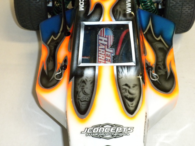

Larry does some pretty sick work. He does everything using tape, pencil and exacto. That is except the faces. He uses stencils for the skulls or in my case, the clowns. Check out his thread on rctech.net for an idea of what he can do. You will even see both the RC10's I built for him and his son.
You will notice in the mounting pictures of my car and Jeremy's that his mounts are in the rear of the chassis and mine are more forward. Both work the same but he wanted his antenna in the front while I wanted the antenna in the traditional location.
