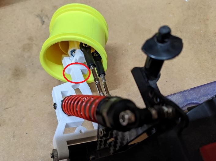

If you make it vertically thicker in the 8x8 section downwards and radius all the 90° and sharp corners to prevent stress risers then it may work in nylon , testing is all part of fun .The delrin one looks good !

This area you pointed out looks like a weak point. There's too much weight and stress that will happen on opposite sides of that area, IMHO. I could be wrong but I think it's bound to fail and break, unless it only sits on a shelf or gets driven very gingerly.

Yeah, this whole project really hinges on if that part will be strong enough. It's really the only way to design an arm that meets the design goals I have in mind so it is what it is. Although I'm not too worried - I'm pretty sure I've seen some pillow ball suspension arms that are just as narrow right where the ball screws into the arm. And in my hand it does feel more substantial than what you might get from the pictures. But I guess I'll find out eventually! I have some 1.5mm aluminum plate sitting around too. I'm thinking it might help if I could machine some plates to skin the top and bottom of the arm in that area to give it some extra strength.

When designing parts for printing I like to use big radius for strength. If you have room, you might just add some radius to that area and a little bit will go a long way in durability. Just my .02

So the printer finished the parts for the other side of the car and after dinner tonight I wasted no time getting them on the car.
I was aiming for 12.75" wheel to wheel. Nailed it.
Hopefully that last 1/4" is enough width to accommodate any bulge from the tires and anything else that might affect total width like camber or toe.
I managed to get a few minutes driving it around the street on some SCT wheels and tires. The car drove okay for the most part. Nothing too exciting to report, and with so many issues in these parts it wasn't going to tell me much to anyway. But it was just fun to drive it with these new parts. Until I lightly clipped a curb.
It wasn't the part of the arm we thought would break! lol
Anyway, I've got some more changes I need to make to the design. And since you guys sound like you know better than I do, I'll be rounding off all those edges at the thin point on the arm. Thanks for the advice on that!

Curbs always have been the natural enemy of RC cars , I'm guessing that's PLA or PETG and its fine for prototypes but just not really strong enough for off road , if you can you should switch to CF Nylon as without getting super exotic its the best material for this type of thing .
