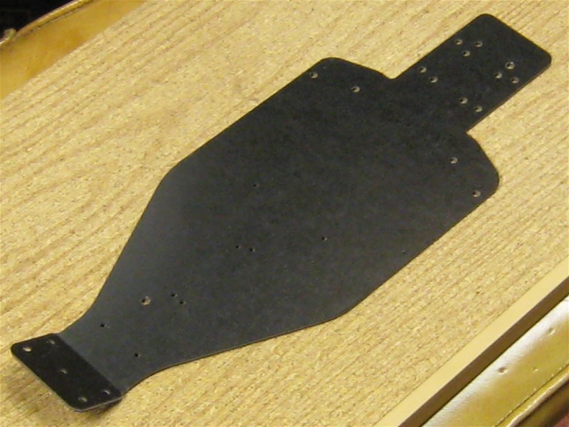

as i stated earlier in this thread, due to my health problems over the last year and a half or so, i had to unload alot of my stuff. including all of my andy's builds from page 1. well, today i ran to the hobby shop to pick some things up for a couple members, and stumbled across another andy's/s&k pro graphite chassis (nip). of course, i couldn't just leave it there.
so, i'm gonna try to get one of these together again to replace one that i unfortunately had to let go.

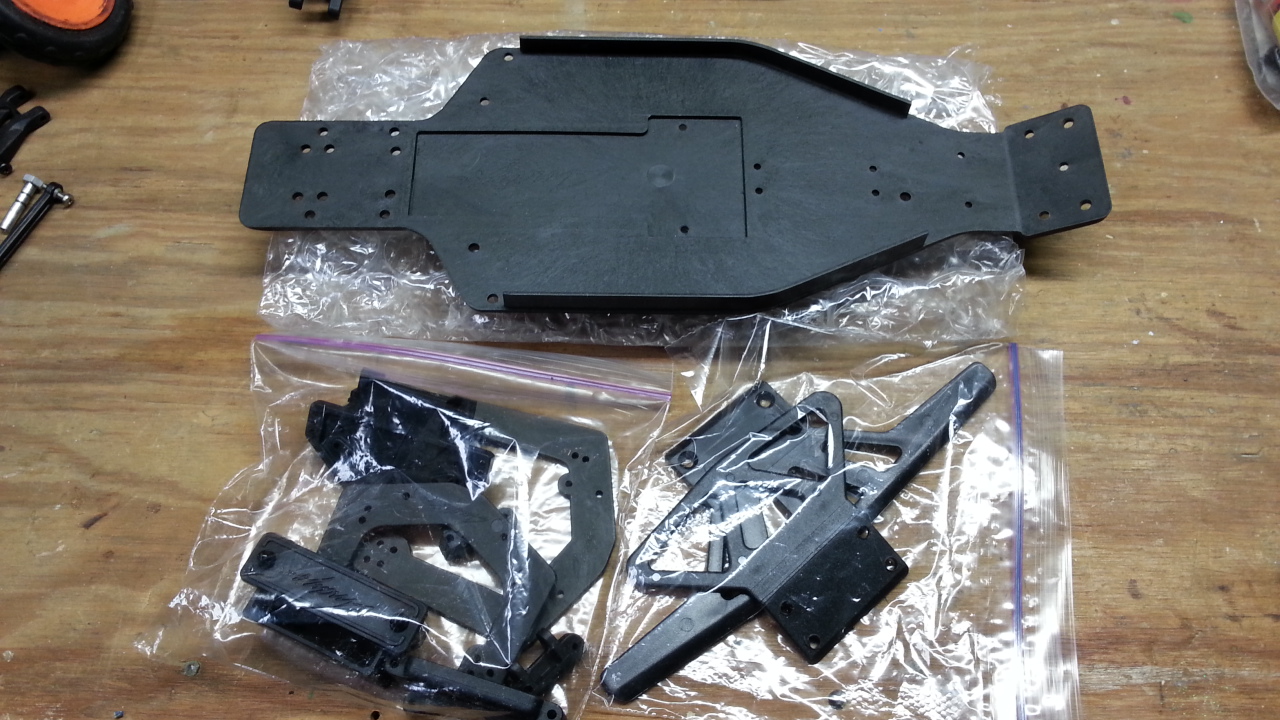

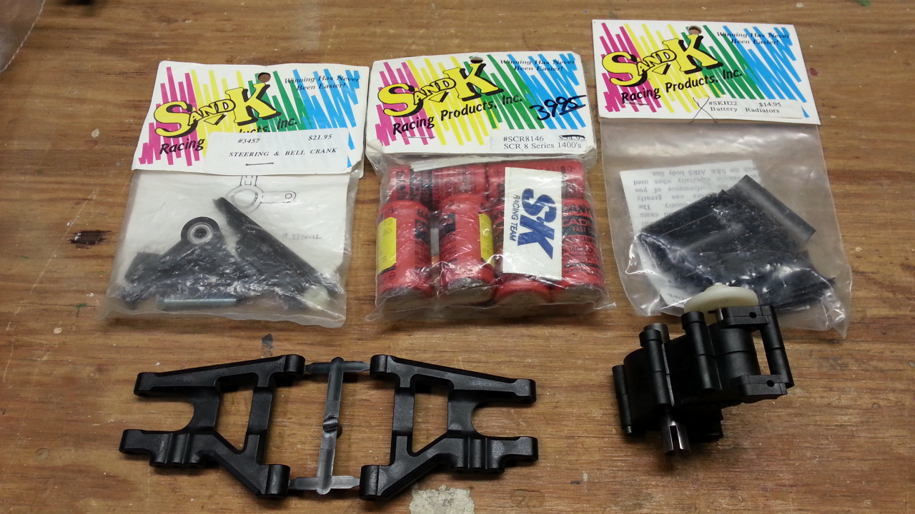

Update...
Sometime last year I think, I sold off my pro graphite chassis and related parts figuring i'd never get it built. Well, when roger posted up the molded pro race parts lot up in the bst I couldn't resist...... though I tried.
So I'm gonna try finishing off one of these cars again.
Unfortunately, I'm going to have a nice long hunt on my hands for new pro race front arms, but the rest of what I need that is Andy's specific is easily found thanks to Paul. I still have a couple things in my stash yet. I thought I still had the s&k ironman motor nip but I mustv have sold that too. Ah well, i'll find another one.

Re: The Andy's Family................
i was so close to buying that for spair parts lol
nice to see another one built .. so far ive killed a front caster block and a set of rear suspension mounts
Good luck on the build. I'm glad to see that it went to an RC10 enthusiast.
