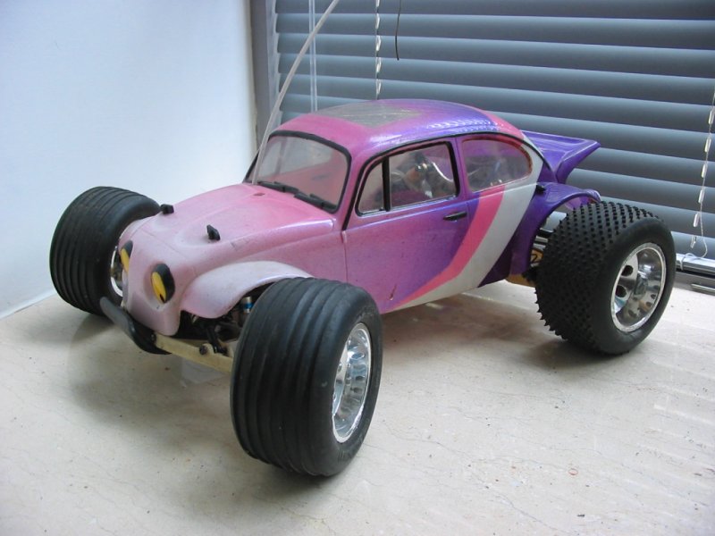

For those who didn't see it in the vintage section: my personal version which uses AE RC10T arms on an ultima chassis.
It beat the hell out of an ultima outlaw when that came out about a year later
Maybe we can all build a beetle-racer and have a contest some day :wink:

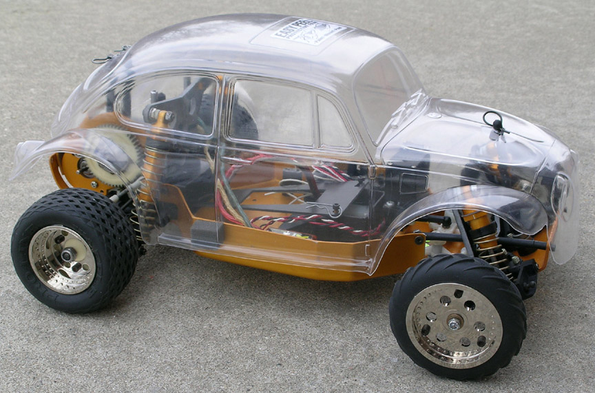

Scollins, can you give me a wheelbase measurement on your car from front axle to rear axle? I am trying to get an idea of what it will take to do this with a GT, and since I would be using the same body as you I will need to have the same wheelbase.
Thanks! :)
scollins
Posts: 106
Joined: Wed Jan 10, 2007 4:38 pm
Location: Detroit
Hi justinspeed
Post by scollins »
The wheelbase is exactly 242mm, or 9.5 inches.
I moved the rear suspension arm mounts in the forward screw hole position to help get to that dimension.
The front nose kick up plate was slid back into the tub approximately 27mm with the nose tubes shortened and re-bent accordingly. The material of the chassis tub was taken out of the side walls where the back of the nose tubes normally mount. Also re-drilled and moved back the pivot points for the steering rack about 6mm from their original places. Hope this helps- i just gave you all the secrets i had on this little project 8)
scollins
When in doubt, throttle out ...... scollins
Mr. ED  It’s my birthday!
Posts: 5483
Has thanked: 62 times
Been thanked: 62 times
Post by Mr. ED »
justinspeed79 wrote:Scollins, can you give me a wheelbase measurement on your car from front axle to rear axle? I am trying to get an idea of what it will take to do this with a GT, and since I would be using the same body as you I will need to have the same wheelbase.
Thanks! :)
GT is the gas truck, right?
I measured the wheel base on my truck with this same body and it's a little bit more than Scollins with the suspension fully out: about 250mm.
Because of the kick-up angle, the front wheels will move a little backward when the suspension gets compressed. With a truck's wider track and bigger travel, the effect is more noticeable than with the buggy.

Hi all, no updates yet on my RC10-Sand Scorcher, but I built one for a friend last week and this is what it looks like, pretty cool huh??? (Shortened wheelbase with chassis mods as I described in earlier posts) Now I have to get mine done, LOL...............scollins
scorcher rc10.jpg (196.16 KiB) Viewed 1304 times

This thing looked sooo schweet I did not want to send it back to my buddy. It will tear a Tamiya Sand Scorcher a new one on performance...Cant wait to get mine done now.
I decided to build 2 of them, one "mild" and one WILD!
Love um to death, but I guess I just got bored looking at all traditional bodied RC10s, even the two that I have! lol. Glad you approve Special Ed, I mean scr8p!
