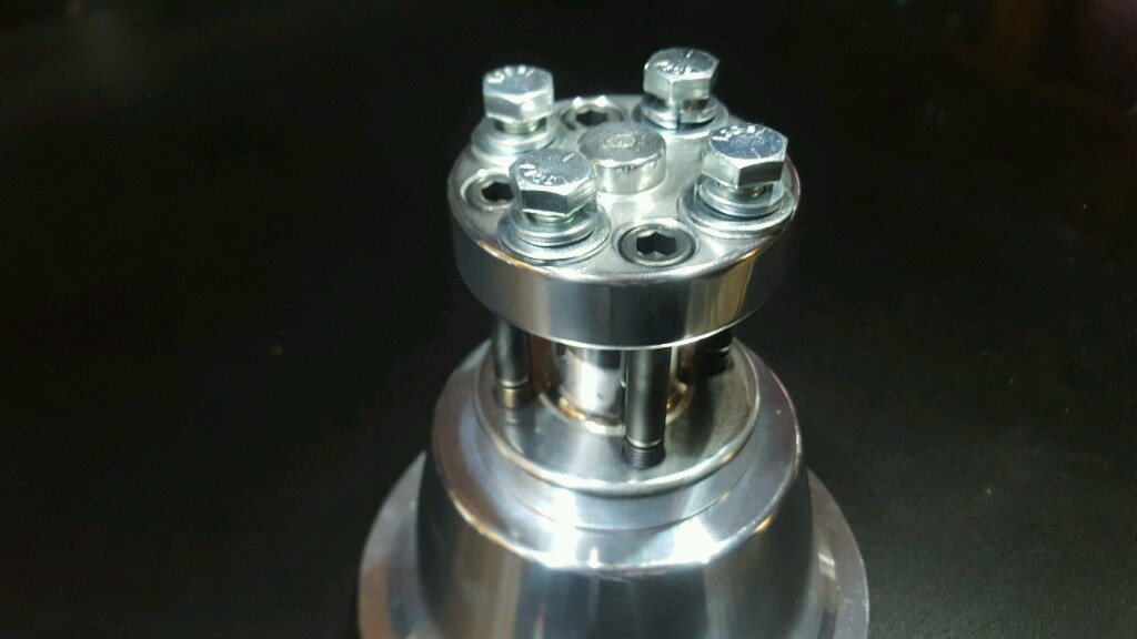

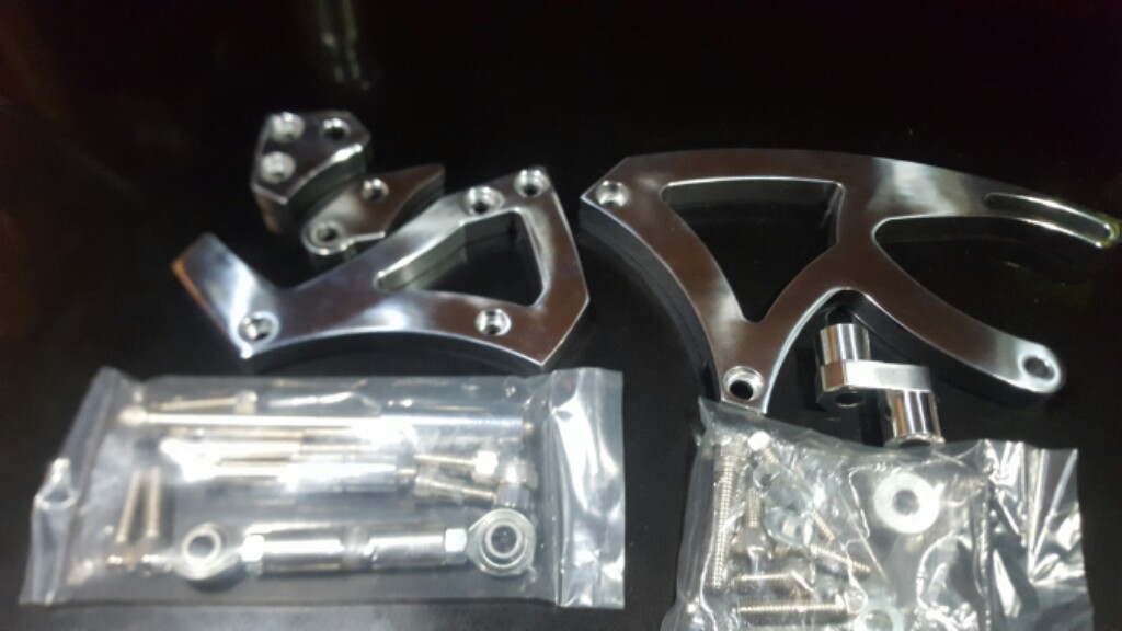

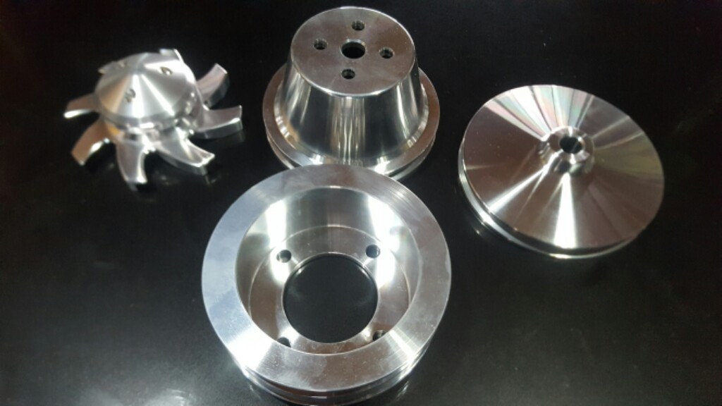

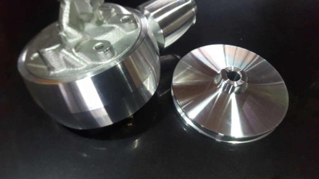

I really went down the rabbit hole with this one. I basically just wanted a nicer power steering bracket and pulley and ended up with all this crap
Performance enhancing it is not except for the fact that it will slow the water pump and power steering down slightly. I did the calculations on the stock pulleys and discovered that the stock 44yo fan was reaching speeds in excess of 7100+rpm..... dangerous
Just need to order the fan now and new belts...
Pretty.......
Pretty.......

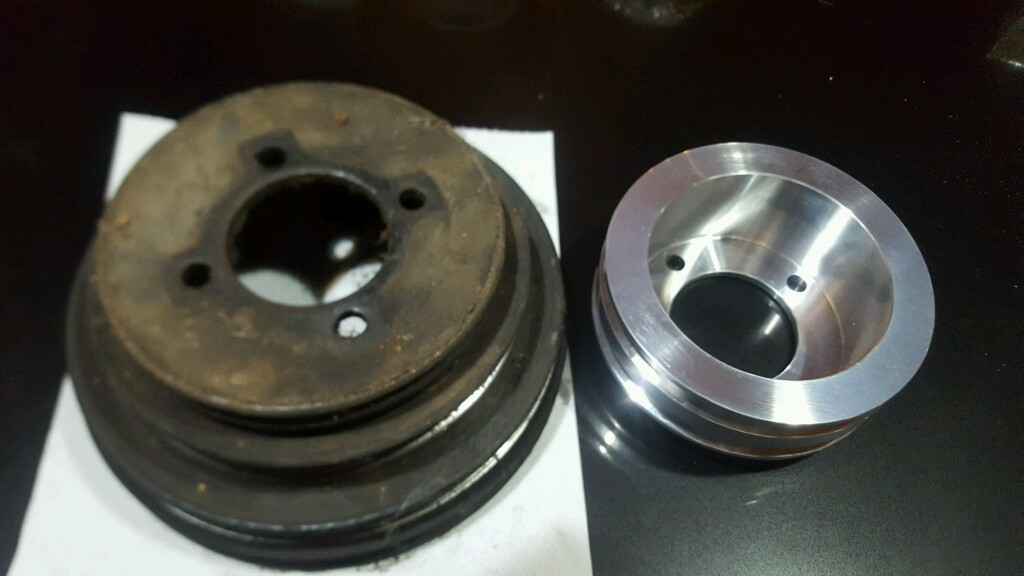

For comparison sake here's the billet crank pulley compared to a stock size pulley.

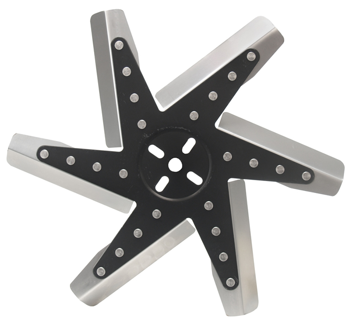

I also bought one of these fans to try. It is almost half the weight of the stock fan although I have my doubts that it will move enough air. We will see, luckily they are pretty cheap.

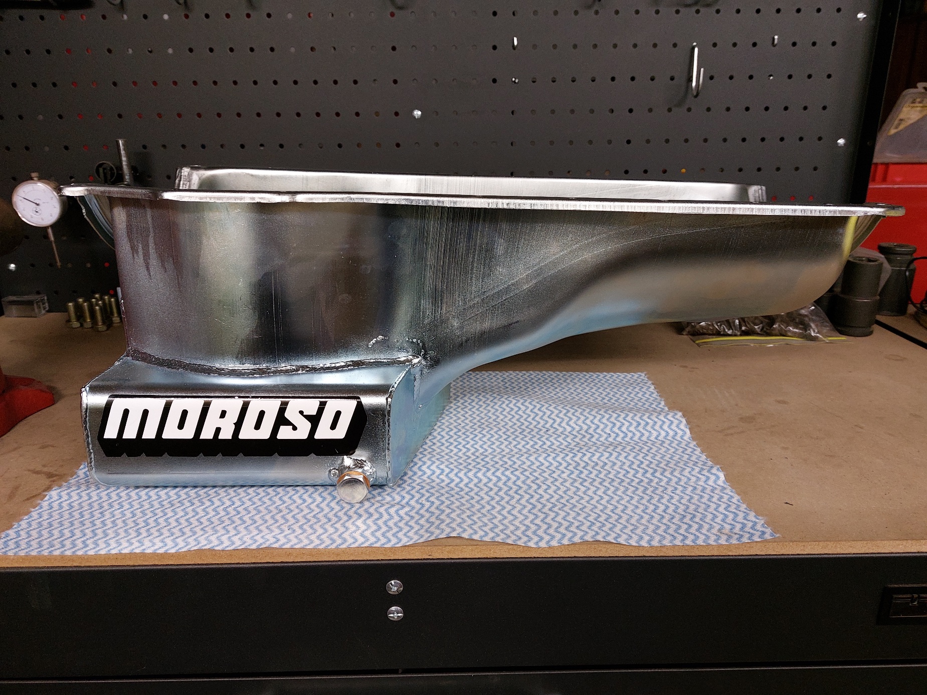

I started to put the billet stuff on and while removing the old stuff to make way for the new, and pulling the radiator out for more room I thought hmmmmm..... that's basically half way to pulling the engine. So I figured it was now or never in replacing the pan and fixing up a few other issues like replacing the too tight converter with a smaller higher stall converter. I originally wanted the Milodon pan but upon measuring it up it just hangs down too far for my liking, you'd see half of it hanging down below the chassis. As it is you can see the blue from the stock pan from the front. I went with the 7 quart Moroso pan as it will fit great and looks good.

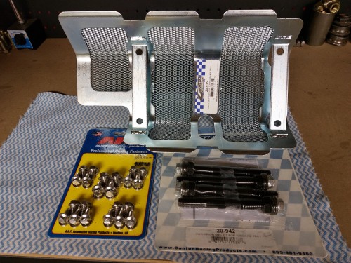

I also bought a Canton Racing windage tray and ARP stainless pan bolt set. With a bit of luck the pan baffling and windage tray would hopefully be worth something in the range of 5 - 20 horsepowers.

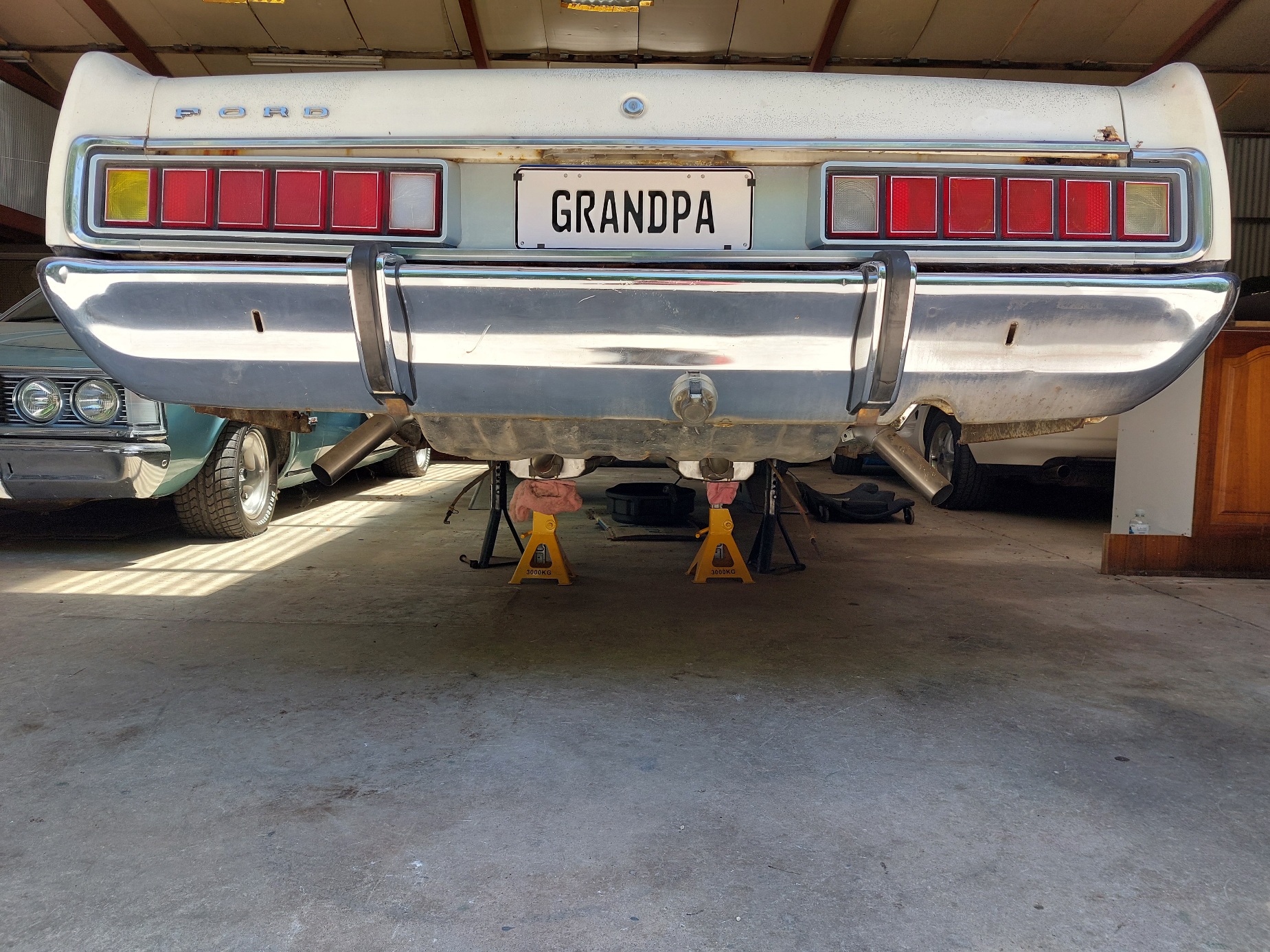

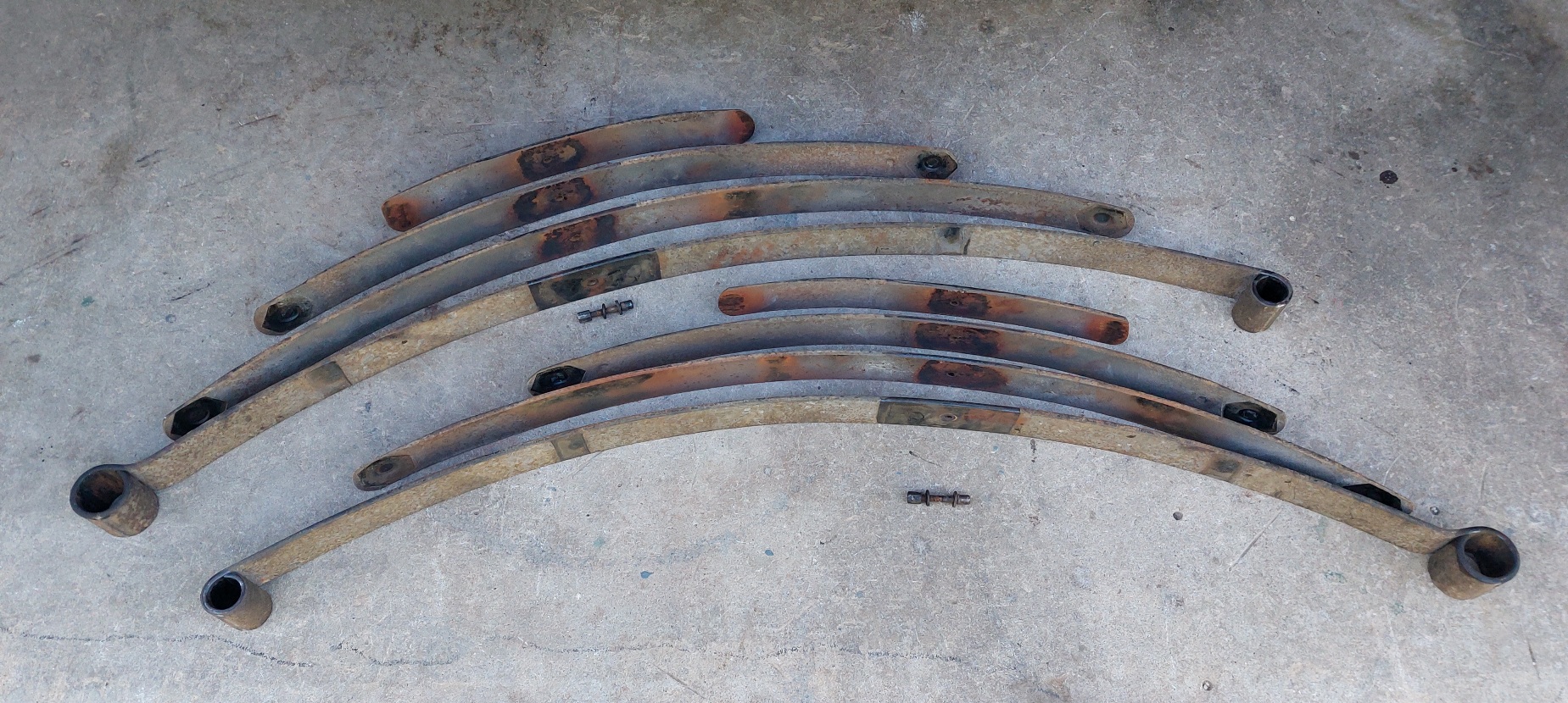

Well this has been WAY too long but I finally pulled the stock rear and put a deposit down for a Strange chromoly driveshaft. Getting it out was pretty straight forward except the mufflers were in the way of removing the front spring eye bolts which was annoying.
The joys of rebuilding springs, hardly anybody rebuilds springs anymore so I had to order new slipper pads and spring clamps. I was surprised to find the springs were only 4 leafs but that explains why the rear is so soft and way under sprung for a 3600lb car. The car has 9" of wheel travel and pretty much uses all of it, just the way I like it
Getting the eye bushings out was a challenge as I tried all the cheap easy ways first to no avail. I ended up setting up a table next to the press and taking the time to set everything up properly, needless to say the 30t press made light work of it. I should have just done it that way to begin with
I was happy I got the springs apart without breaking the center pin, time to clean and paint them while I wait for parts.
