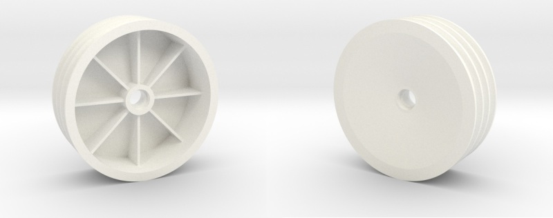

- Niki
- Posts: 524
- Location: Finland
- Has thanked: 3 times
- Been thanked: 45 times
Re: NIX91 Questions and Answers
2.125" TQ style front wheels. Similar to #6852. Uses #6902 3/16 x 5/16 flanged ball bearing.
I think these are perfect match for a replica.
http://shpws.me/GCDO
