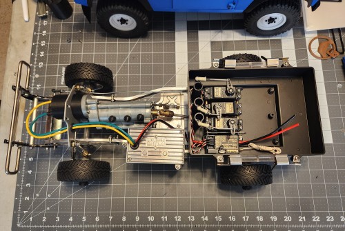

This morning I got some work in on the Hilux. Installed a new spur gear I printed to match (better) the incorrect pinion that is installed. Final wired the motor and got it installed. Then installed the servos and got all the linkages setup semi-well.

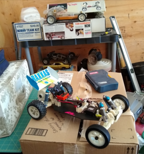

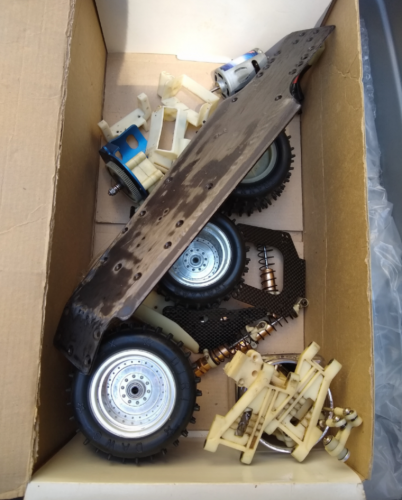

Chop-shopped an Eagle I picked up from Crunchy a couple years ago so I can ship it to myself. (Not in that box/in that manner)

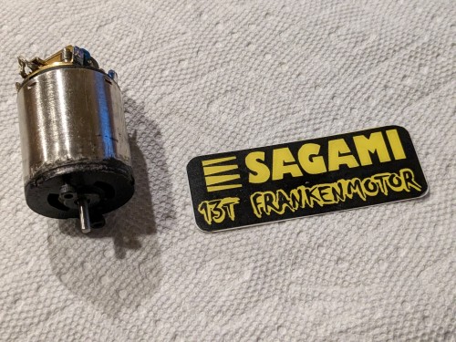

I made a label for my Sagami can parts motor.

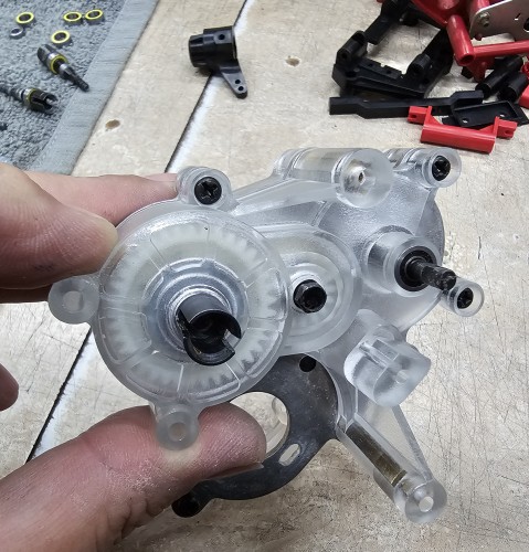

Started a rebuild of this Samurai that's been in a box apart for quite a few years now. Gearboxes are impossible so I had one 3d printed in clear resin. Not fully transparent but looks pretty cool and will be a good placeholder until I can locate a fresh original

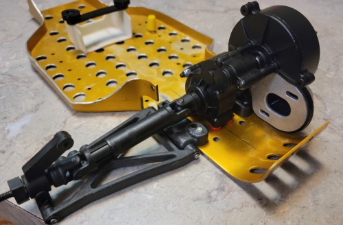

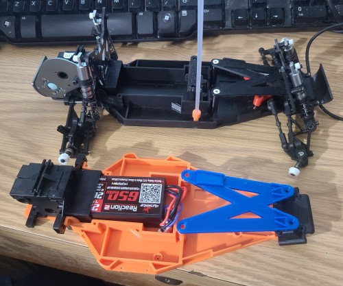

Managed to fit one of those $20 Injora transmissions on a RC10 (going to be a truck). I had to clearance the gear cover a little, to allow more upward movement of the half-shafts.
The half-shafts came off a ECX Torment and the carriers are from a Traxxas Stampede. Both fit without any modification themselves but the control arms require clearanceing.

TRX-1-3 wrote: Mon Jul 31, 2023 4:02 pm Chop-shopped an Eagle I picked up from Crunchy a couple years ago so I can ship it to myself. (Not in that box/in that manner)
Are those eagle front arms?
Do they happen to fit on an rc10? I have a set that looks a lot like that from a parts car.

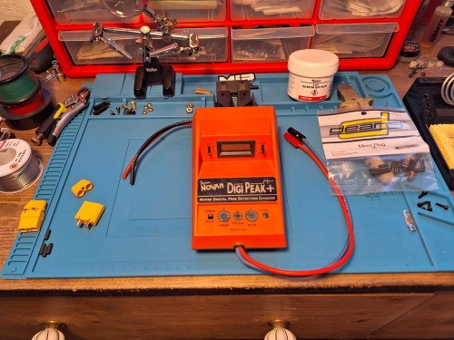

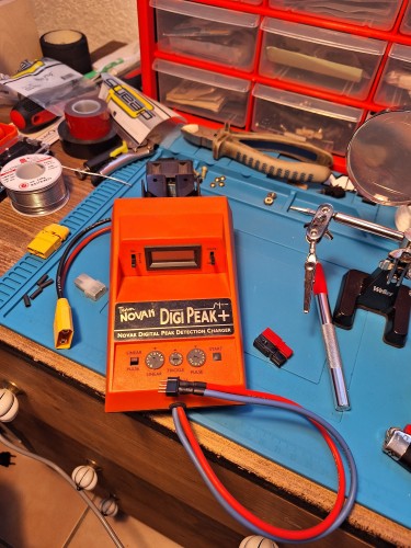

Switched out an Associated and some other style connector on a Novak Digi-Peak Plus to XT-90 and 4 pin dean.

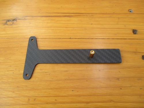

Made this battery strap for my Classic. The post stops shorty lipos from sliding backwards. It's upside down in this picture.
Fitted.

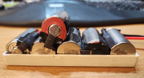

Had a little time to play around with my new mini spot welder. Made up some cells to fit into a Tamiya hump pack. It is such a tight fit in the case that I hade to remove the skins from the cells, and only insulate where needed, so that is why it looks all trashy with the tape. It will look just fine in the case. :D Fascinating part is that it is taking a charge and the smart charger didn't sound off any alarms!

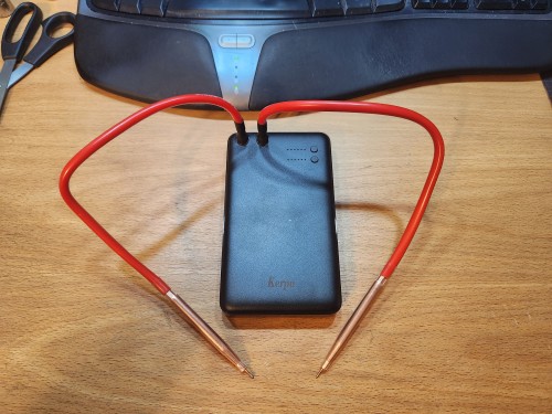

mini spot welder...?
morrisey0
Posts: 1802
Location: Richmond, VA
Has thanked: 87 times
Been thanked: 1852 times
Post by morrisey0 »
Frankentruck wrote: Thu Aug 03, 2023 7:56 pm mini spot welder...?
Yep, it is literally just a rechargeable battery that acts like a mini spot welder. There are bunches of them on Amazon that are very similar, and probably all made in the same factory. I chose this one because it has 11 "gears" of adjustability. I just imagine the designers sitting around and one saying that they should range the voltage discharge on a standard 1 - 10 scale, and one guy popping up and saying it should go to 11. And then you know the rest of the conversation..............
