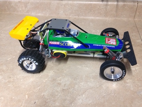

Post by slotcarrod »
I just built one of mine! What an enjoyable experience! 8) I built this one as a runner, but it looks so nice, I don't know if I have the guts to run it! :lol: One of my rear tires had the Good Year logo scuffed right out of the box, but a little white paint, a fine brush and a steady hand fixed that. Best rere for the value ever, I would recommend this car to all of you vintage RC guys! 8)

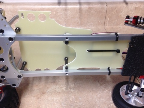

Here is where I have been going with mine....Tomahawk 2014 :mrgreen:
stulec52
Posts: 294
Joined: Sat Jan 12, 2008 1:28 pm
Location: Calgary, Canada
Re: Kyosho now on the re-re bandwagon - Scorpion
Post by stulec52 »
gomachv wrote:Here is where I have been going with mine....Tomahawk 2014 :mrgreen:
I like it !
I do wonder if I can get away with not using the upper deck.
Mine just arrived today, and I'm going on vacation tomorrow, so my build will have to wait, but I'm thinking different body, and just a flat plate and go from there.
