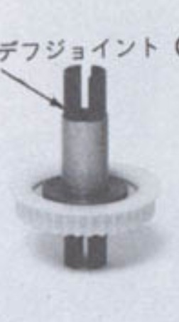

stickboy007 wrote:So that's what the diff kit is for. I have one that came with an RCPS steering brace, and wasn't sure how to use it. What do you do with those two metal tubes in the diff kit?
They are spacers for the bearings after you dremel off some material from the diff. halves.

Well, that's another question I had actually! My 870c had tubes already and no ridges to grind. In fact that's what is shown in the manual as well. Were there different versions of the diffs for the YZ10 variation?

Not completely sure I follow there. Do you have a picture you can reference?

apparently some or most YZ10 diff outdrives have a flange on them that the bearing rides against. To install these you need to grind off that flange. My diffs did not have a flange, instead they had a longer tube than the one with the diff kit. Just slip it onto the outdrive on the long side.

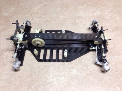

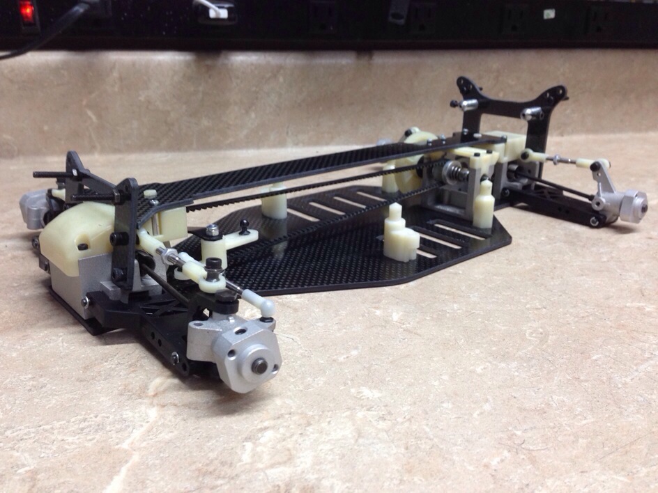

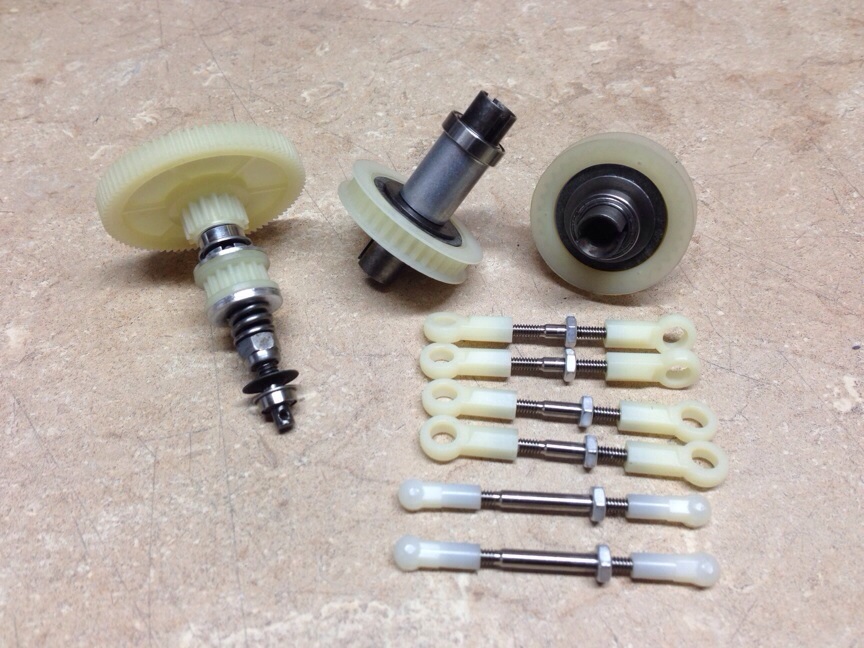

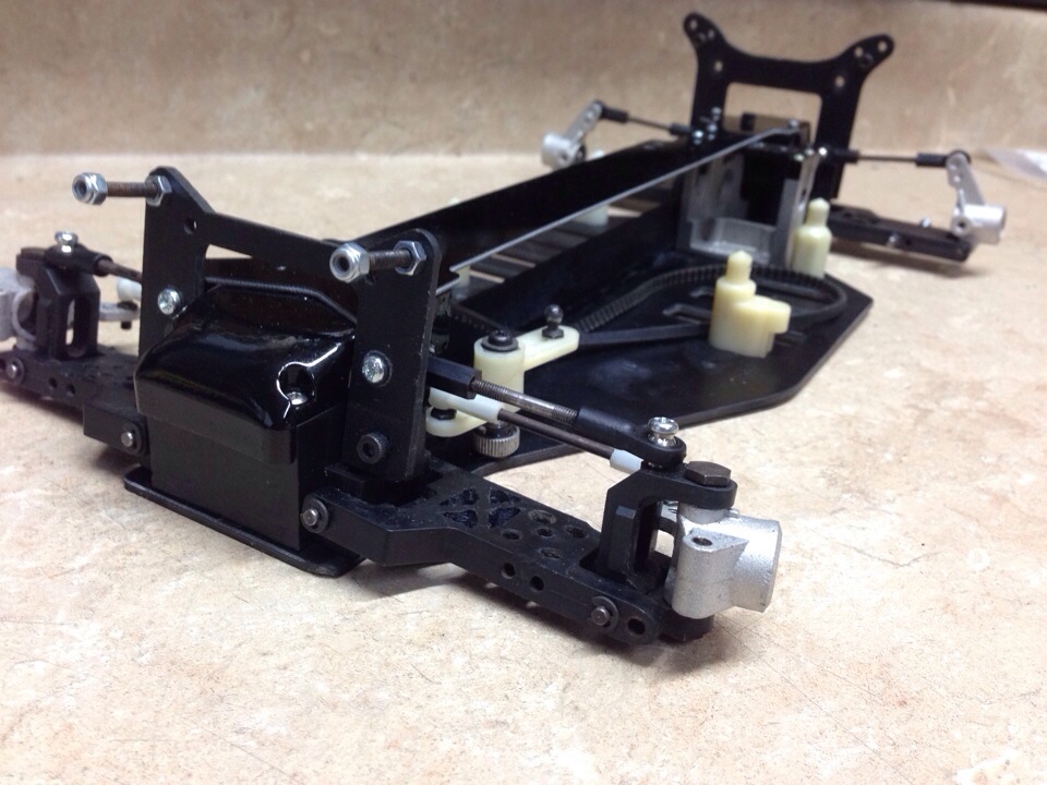

A few sub assemblies waiting for bulkheads. I don't think I can run the double flange pulley in the rear but we will see
Oh, and the turnbuckles are the lunsford retro buckles

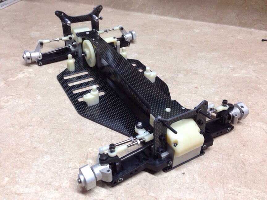

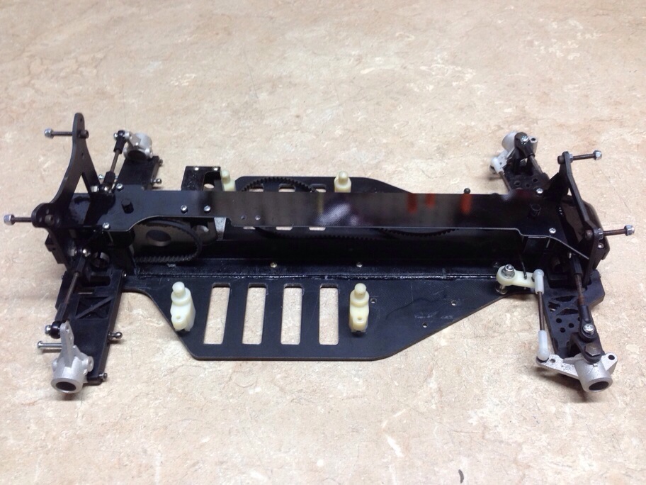

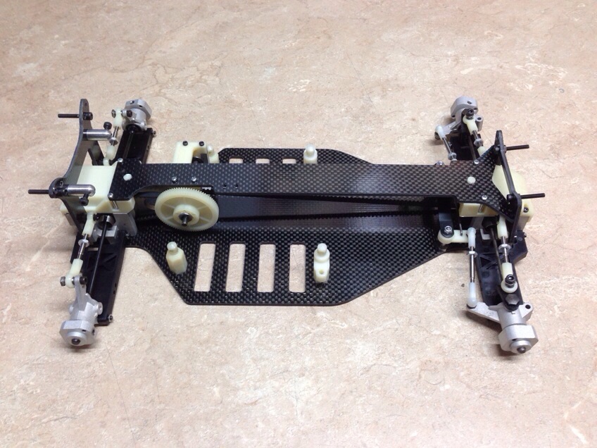

Got my magnesium back today, quick clear coat and back together with new rubber isolators, new belts, and lots of other new bits. Now I need to source some clean associated shocks and figure out what tires I want to put on her
Oh, and there were enough leftover bits to put another chassis back together LOL

Looks great :!:

That carbon one looks amazing.. :shock: the spare parts one looks pretty good too.. :wink: nice work..

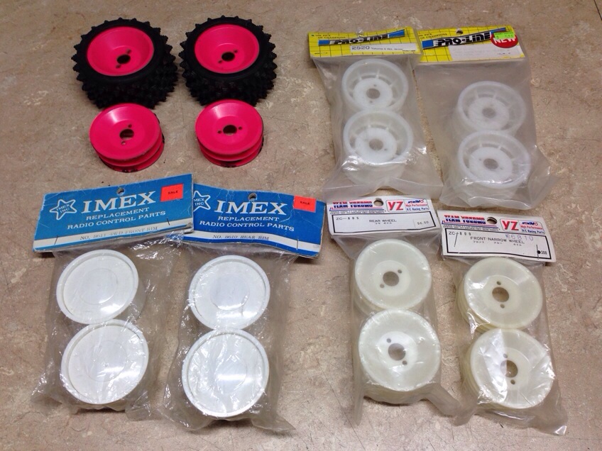

Posts: 12363
Has thanked: 1135 times
Been thanked: 3944 times
Re: Cause I don't have enough going on....YZ870 edition

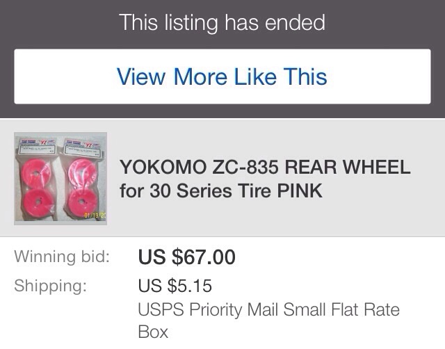

We'll, I tried...but gave up at $40. Never expected they would go that high! My white YZ10 wheels may make it into the car...or my Imex hubcap wheels. Hmmm
aip47-2008
Posts: 1191
Location: Spokane, WA
Has thanked: 170 times
Been thanked: 23 times
Post by aip47-2008 »
A pink set of Yokomo 2.2" front and rear wheels usually fetch near $100. These wheels are very rare and have the correct offset for the RC10 and Team Associated import YZ10.
They were not meant to be used on the newer works cars or yz10's.
