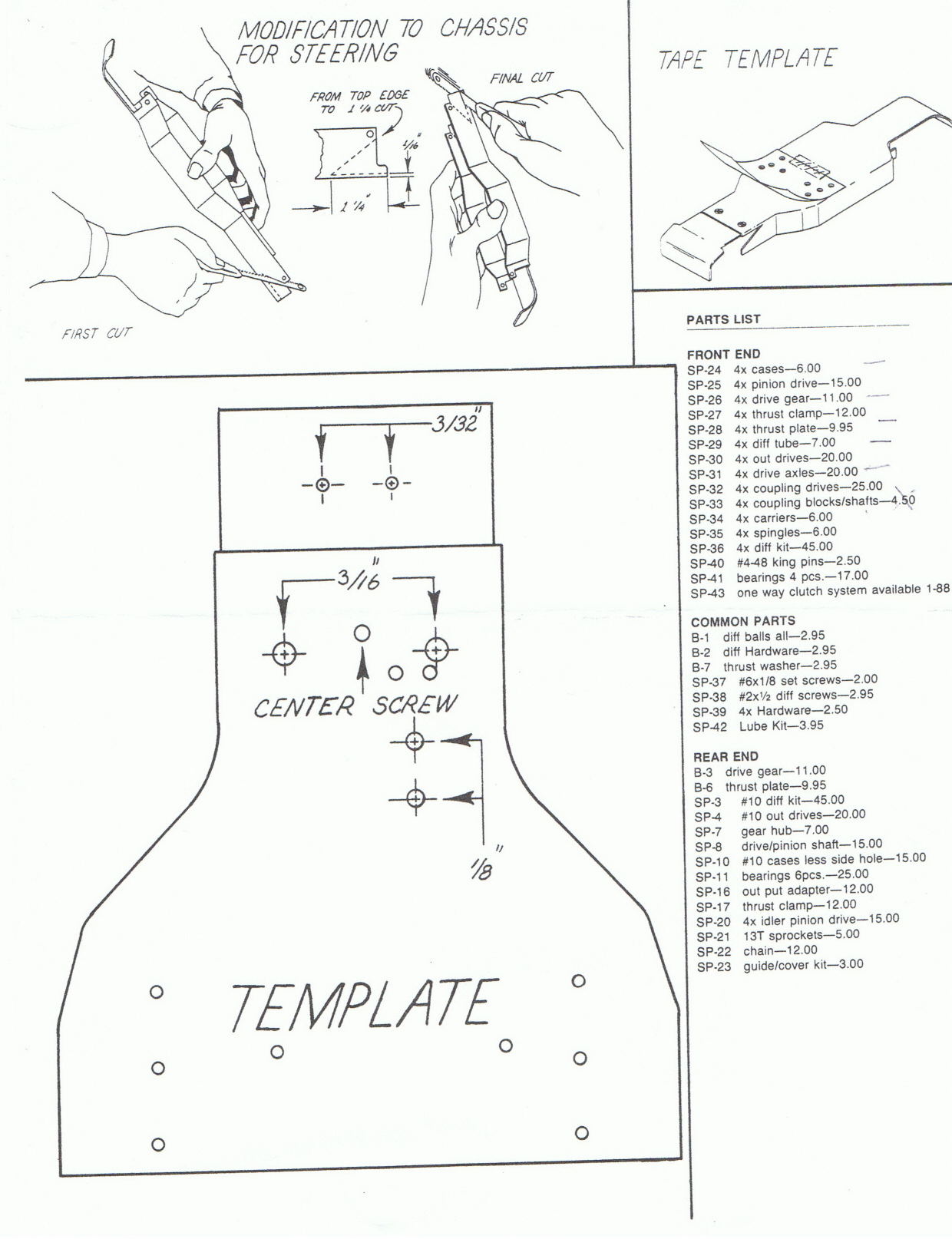

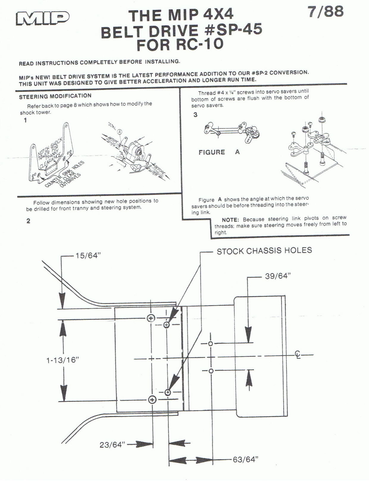

asashaw wrote: This chassis I cut is for the chain drive though. The bellcranks are in a different spot.
How so? Oh and thanks a lot for all the pictures I have been frantically saving them to my hard drive. Cheers.
i'll post a scan of the templates for you

these scans have been reduced for this site's maximum allowable file size. if you need a full size scan you can print out for the actual size template, pm me your regular email and i will send the larger file.
NOTICE THE DIFFERENT SPOTS TO DRILL FOR THE BELL CRANKS
