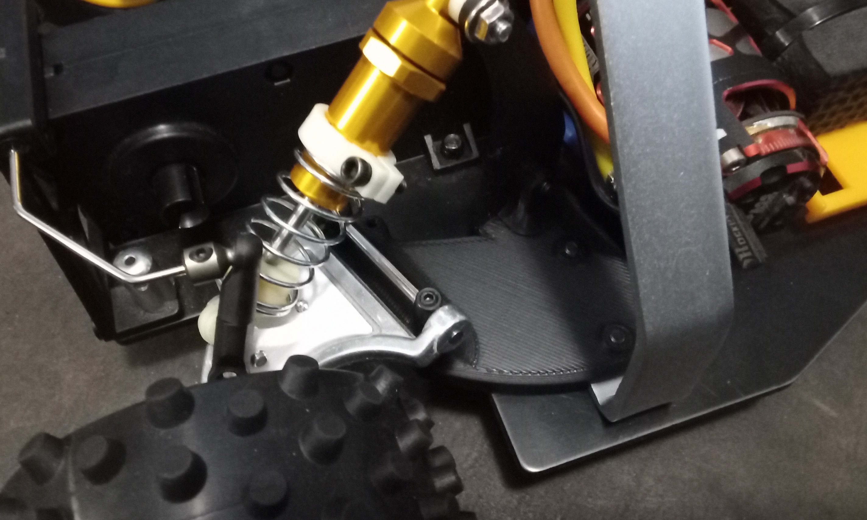

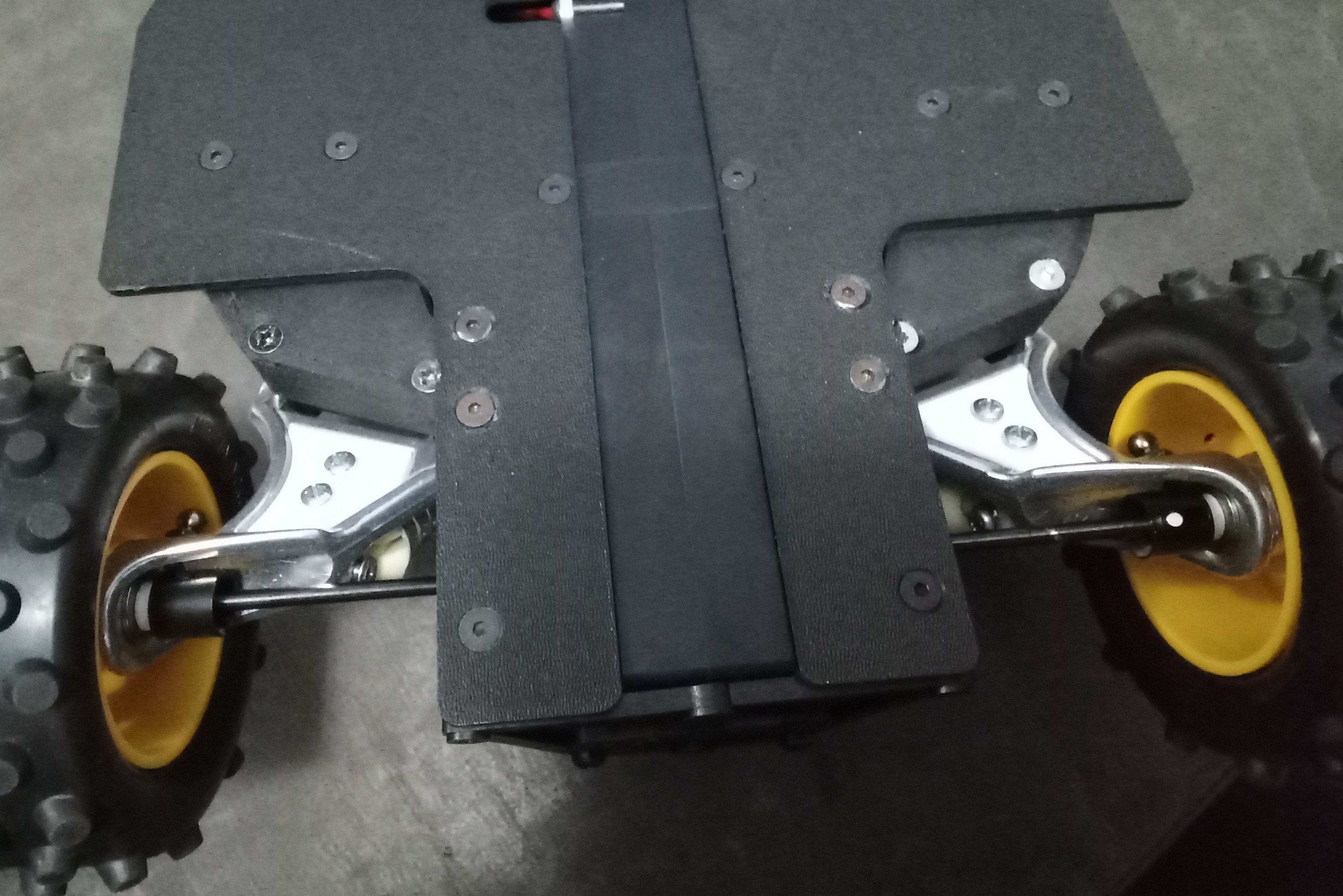

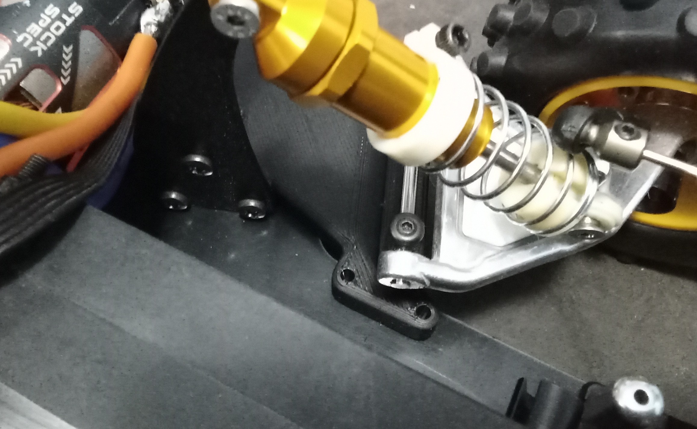

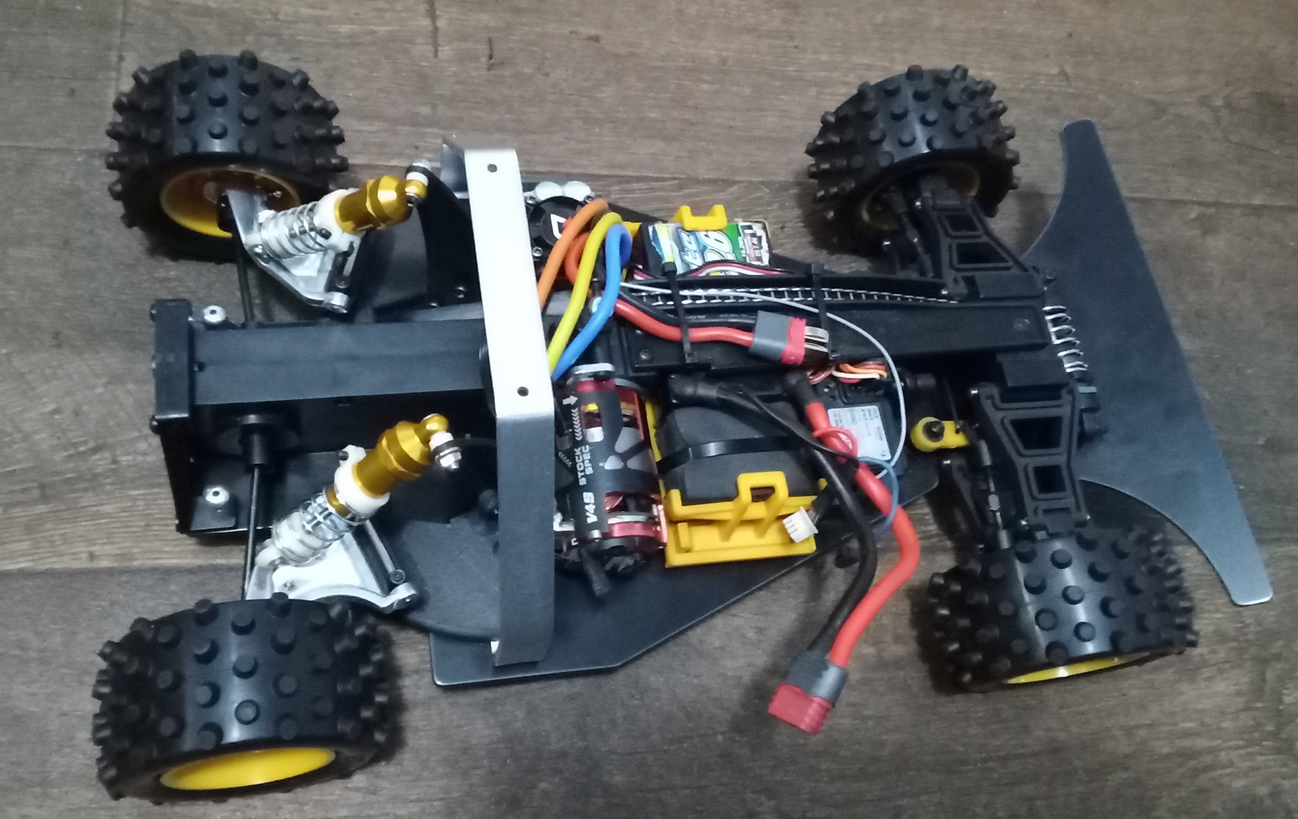

A slight change of direction , originally I was going to make a custom chassis to suit the rear arms but now I think the mounting could be fitted to a stock chassis with the addition of two 3mm holes each side , this one is a re re so M 3 at the roll hoop but it would be simple to just adapt the mount to M 4 . I'm also experimenting with the anti roll bar , I'm hoping to use it but I'll probably have to shorten it at each end a bit.An unexpected bonus is the mount has way more clearance to the motor so the wires for a BL motor can easily fit at the back rather than towards the battery tray .

Just printed out the mountings in PA6 CF, drilled to the chassis and assembled it all , really pleased with how it's turned out.

Nice job on the Scorpion trailing arm setup! I have a similar setup on my rear motor Optima. I'll have to borrow inspiration from your shock mounts if you don't mind!
