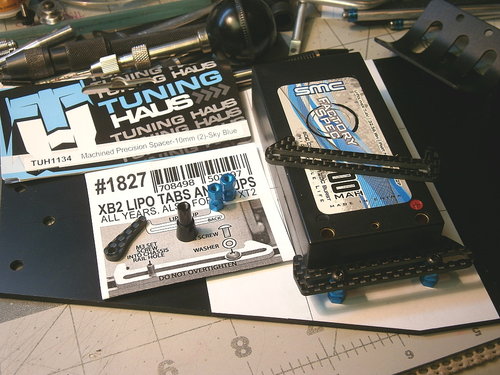

While I'm waiting on some more TLR parts for the battery bulkhead option I started looking at the Exotek parts like I used on the C2 "Tuber" build.
One of the carbon fiber lipo straps had a little bit of de-lamination on the end, which I've repaired with some medium CA glue. This time, I have some blue (sky blue) machined hex stand offs from Tuning Haus. They are available in different colors and lengths from https://www.tqrcracing.com/ or you could buy direct? Yes, they have purple ones too. :mrgreen:

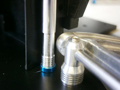

When I disassembled to figure out the battery placement I noticed that the trailing arm pivot was leaving a mark on the ESC stand offs. Not bad, but it was marring the surface. I pulled them off and made a 0.020" reduction of the diameter. Now I'm happy. :D

A simple problem requires a simple solution. Very nice. :D
There's so many benefits to owning a lathe.

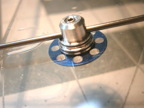

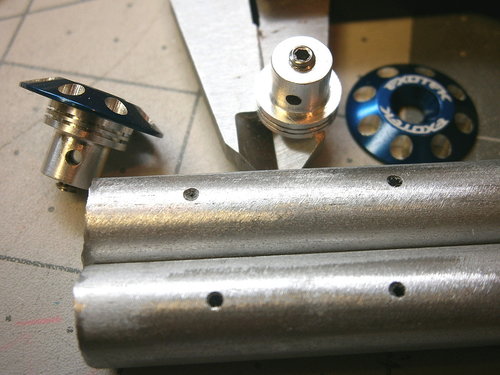

Earlier, I had made some wing hardware but was not real happy with them. They could have used a couple of more cuts,45 degrees here and there. So... I drilled some more rod (1/16" for the wire) in prep for a couple of more. Seeing as I'm waiting on some parts and a new Reedy Wolf Pack lipo shorty. I have something to get into. 8)

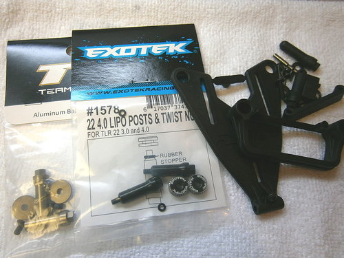

Mail was running a little late today, dense fog this morning. Packages arrived for the battery hold down, a couple of options to work with.

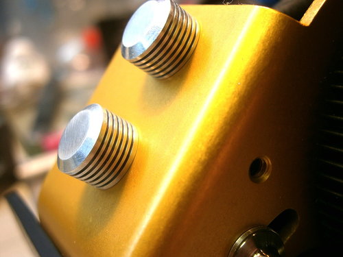

Motor plate heat sinks from 3/8" rod. They might not do much, but look cool. 8)

I've got the wing mount hardware finished now, whether I use the wing or not, it's still done. :mrgreen:

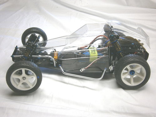

Working on getting the Andy's Renegade body to fit now. I'm close, not perfect though.

Andy's Renegade body is timeless and it looks like it'l fit the trailing arm chassis well. I reckon it's really tricky to trim around those canted rear shocks (probably require a little extra clearance so they'll swing freely). Looking good!! 8)
Do you have a paint scheme in mind?

Yes, rather tricky. I found a way though...
Eyeball the shock mount hole and drill/ream the screw hole position. Use a long 3mm screw and mount the shock, use a sharpie pen to draw the outline of the shock body/spring.
I've not figured out a paint scheme yet but would like to use gunmetal,chrome,blue and white.

That seems like a good method. Your eyeball must be calibrated 'cause you appear to have nailed the shock cutout perfectly. Well done Nomad!! :D
