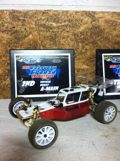

Re: RC10 CE Set Up and Race Discussion
i ran my ce in a vintage race this weekend. stock rear blocks. the car was glued.
setup:
front
-1 camber
gt wide axles
b4 wheels (losi pink taper pins)
35wt #1's brown springs
1 degree toe out
ride height 25mm
rear
klien arms
rpm gt hubs
b44 cvd's
custom works .125" spacers
-1 camber
30wt #1's green springs
ride height 23mm
double dee's
b4 wheels
(the only reason i used klien arms was because all i had were b44 cvd's, so i had to use a OIN rear end, worked great)
turnigy 4000mah
hw 60amp xerun
lrp 17.5
geared 81/30
i was the only thing holding the car back, i was faster with it then my b4. lol
almost took it down. i've never had 3 degree blocks or 25 degree castor blocks so i have no idea what i'm missing.
