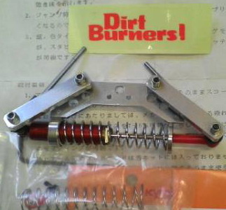

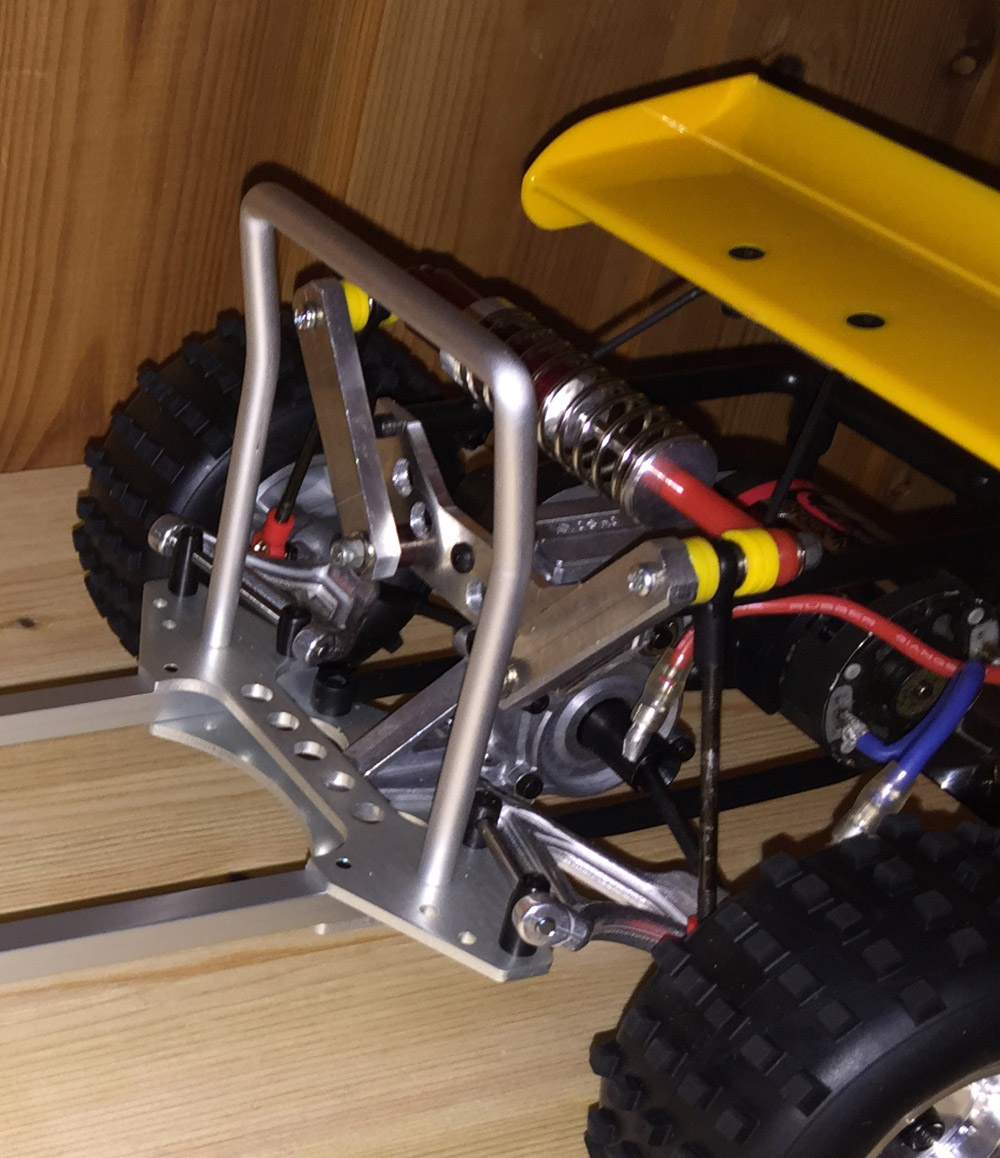

I had a replica made of this "Dirt Burners" monoshock unit:
I have test fitted it on my rere Scorpion (using bits and pieces of hardware I had at hand. Proper spacers, nuts and bolts are on their way from China), and it fits perfectly. It does interfere with the radio tub, so the tub will have to be modified to be used on a Scorp. I'm not sure if it will interfere with the cage on the body..... I'm quite sure it will interfere with the Beetle and Tomahawk bodies, so mods will be needed to fit it on any of the cars.

See-sawing suspension is just a bad idea for offroad. You don't want to reduce the effectiveness of one side by increasing the stiffness of the shock, when the other side has the suspension compressed. I guess one benefit is weight savings, but with an alloy framework like the Dirt Burners assembly above, you might actually be increasing weight. I guess there's a reason why independent suspension is all you really see in the top competitive offroad vehicles, RC or real life.

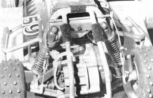

It's not for every track or every situation, but try to convince Mr Dunn it didn't work on the Radiant
Stolen from another thread
JHarris wrote:After posting the pictures of Mike's
Pro Radiant from the 1989 worlds he and I had a conversation about the observations all of you made and some of the other modifications. Mike's car was equipped with a modified front shock tower that increased the suspension function. Here's his explanation of what he did and it's function. This is a cut/paste from 2 different emails so if it seems a little broken, that's the reason.
Kinda surprised nobody noticed the pivoting front tower on my Pro Radiant. They spotted everything else. The front tower was nicked named the "flippity flop" (not by me). I also used one on my Kyosho Laser. It had limit stops on it. The RCCA article should show pics of that.
I did have a special slipper clutch on the car. Not sure where it went.
We drilled an additional3mm hole between the two original mounting holes of the tower and bulkhead. It pivoted off this hole. We shaped the bottom of the tower like a slight "V" to allow it to pivot and this surface acted like limit stops.
The trick to any 4 wd drive car is to never loose front drive while cornering. So if the inside tire lifts from the ground then you have just a 2wd car at that point. This is why the mono shock worked so well. Problem with the mono shock is you had the dampening and spring of only one shock for both wheels. Our system was the best of both worlds. We used a small sway bar to keep it centered and keep it from waundering.

TomEG,
It always warms a kyosho heart to see 12mm od/ 10mm bore red shocks on a Scorpion, vertical or horizontal
Is it possible to post a picture, taken from the front and backwards?
