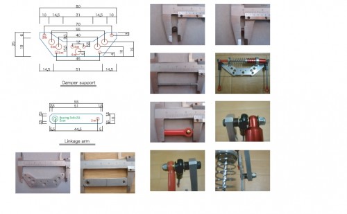

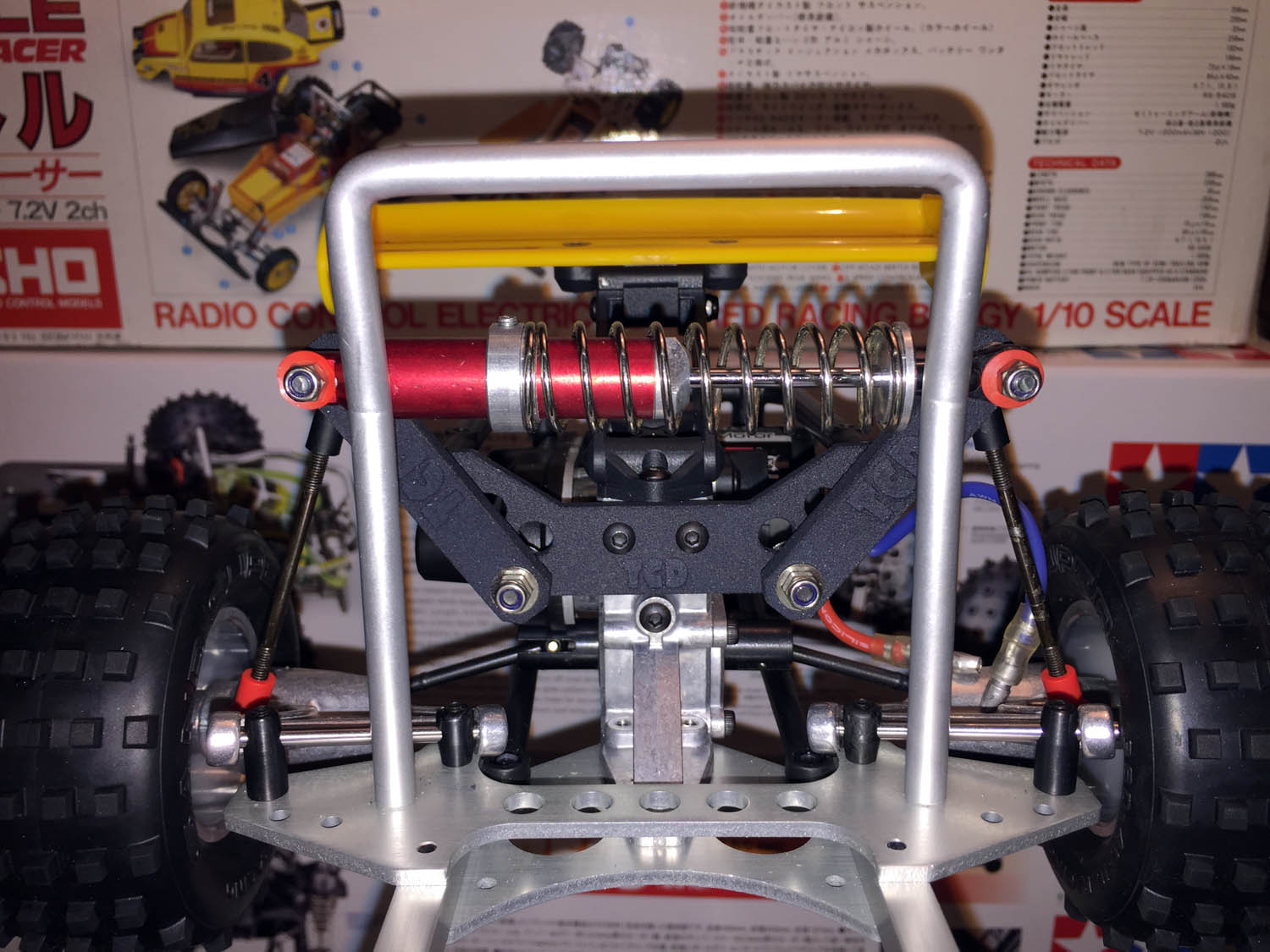

Somebody was concerned about the added weight with my "monoshock-unit" for the scorp, so I had it made in plastic :twisted:
Well.... not really :lol: I made some 3D models of the parts, and had them 3D-printed at Shapeways. The plastic feels strong enough, but it flexes too much to actually be used. I really had them 3d-printed for prototyping, as it's quick and cheap, and I want to do some small tweaks to them before I get the final parts CNC'd in alu. With 3d-printing I can tweak them and make small adjustments until they are perfect.
Sharp eyes will see that the shock now is in front of the arms, instead of behind them. There is now more than enough clearance from the scorpions rollcage. I have also added thrust bearings between the support plate and the arms, in place of the spacers used before. The next step is to get some countersunk "grooves" for the thrust bearings on both the support plate and the arms, as well as countersunk holes for the screws. The goal is to make it more compact and go clear of the radio tub, so it can be used on a scorp without modifying the tub. I'm not sure if I will be able to do that, though..... But all the fun is in trying!
Disclaimer: I don't care if monoshocks are worse than individual shocks, and I'm sure that there are many shock setups that are better than this for racing. The point is that I'm more of a mech/engineering type of guy than a racing driver, and I find great satisfaction in doing things like this. Making things unique, and different from what you normally see. Of course making it work well is a big goal, but I'm really not concerned if it works better than this or that. Fitting a stabilizer bar is the next project, as that should counter the body roll that usually comes with monoshocks. As for the added weight.... I hear that the scorp is front heavy, well, not mine :lol:
Tom

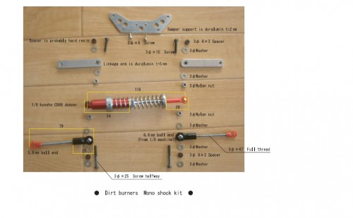

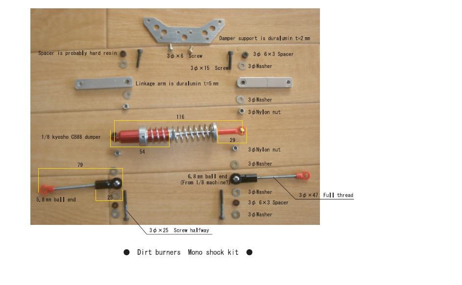

The parts on this unit is made from the exact measurements of the original Thorp unit, I also got hardware (spacers, bolts etc) that matches those that came with the Thorp.

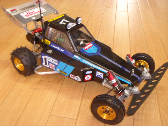

However... the Thorp unit with its original spec hardware couldn't possibly fit the scorpion without modifications. Even the Tomahawk body will have to be modified. That's why we only see "strange" creatures like this:

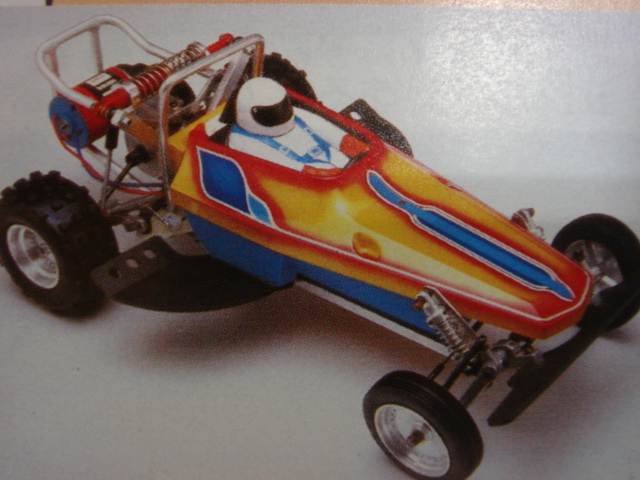

and this:
I would like it to be a direct fit on a rere scorpion, that's what I'm aiming for.

Interesting....the motor on that second scorpion is reversed. :?:
TomEG
Posts: 214
Joined: Sun May 10, 2009 4:01 pm
Location: Tromsø, Norway (Mariestad, Sweden)
Re: Kyosho now on the re-re bandwagon - Scorpion
Post by TomEG »
Phin wrote:Interesting....the motor on that second scorpion is reversed. :?:
Hmm.... maybe it's the picture that is reversed???
That's likely it. Can't read any of the writing on the motor or gearbox cover to see if it's reversed.
It got my attention because the only other Scorpion I've seen with a flipped motor was Eddie Knowles' oval car.
