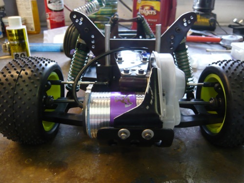

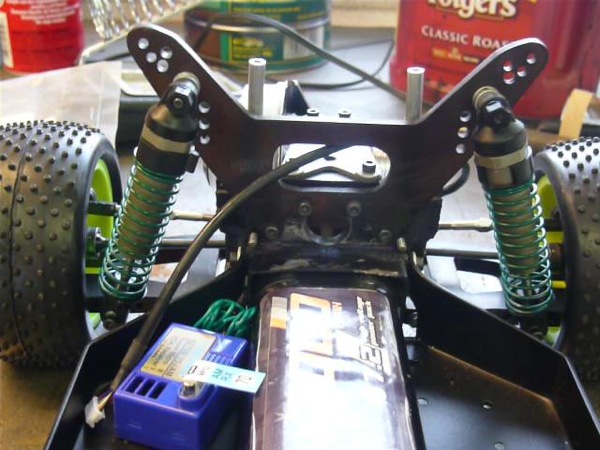

Here's some pics of what I've been doing. I wanted to angle in the rear shocks more so I tried drilling some new holes. I placed a buggy rear tower over the truck rear tower as a template and drilled some new holes. This gave the shocks more angle but now the suspension bottomed out just before the chassis touched ground.

Maybe a shorter shaft in the shock would help.

I tried a 1.02 shaft. It still bottomed out. I think a shorter shock body might help. The spring perch hits the bottom of the shock body.

use the stock associated rod ends on the bottom of the shocks. the one you have on them are raising the spring cup too high which is causing it to bottom out too soon. if it still bottoms out, maybe your shock bodies are 1.39's instead of 1.32's?
