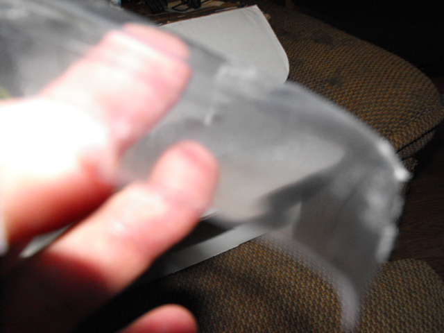

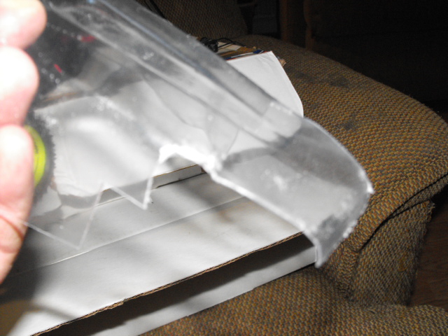

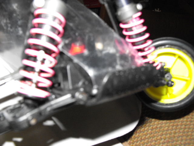

Yes it is way to wide I was cutting mine today and found the same thing. I just cut mine down to a thin tab to stick through. sorry for the poor pics I am tired and medicated so I will do better tomorrow I hope this helped

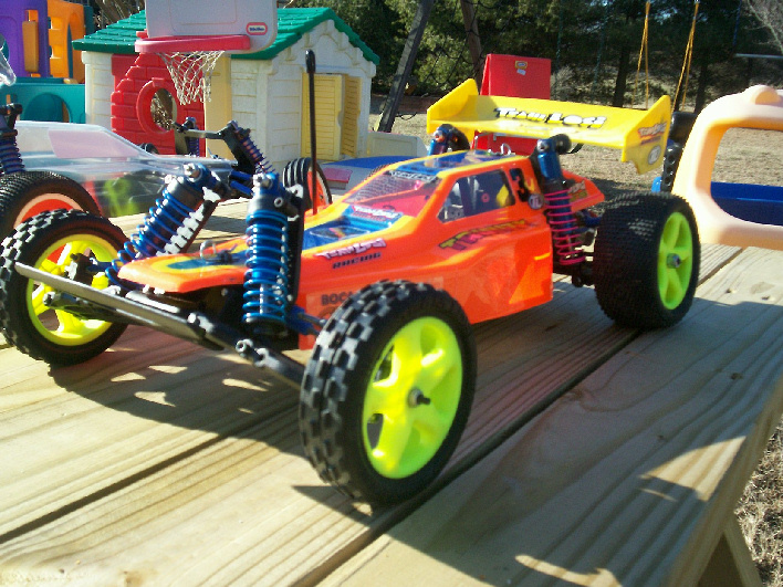

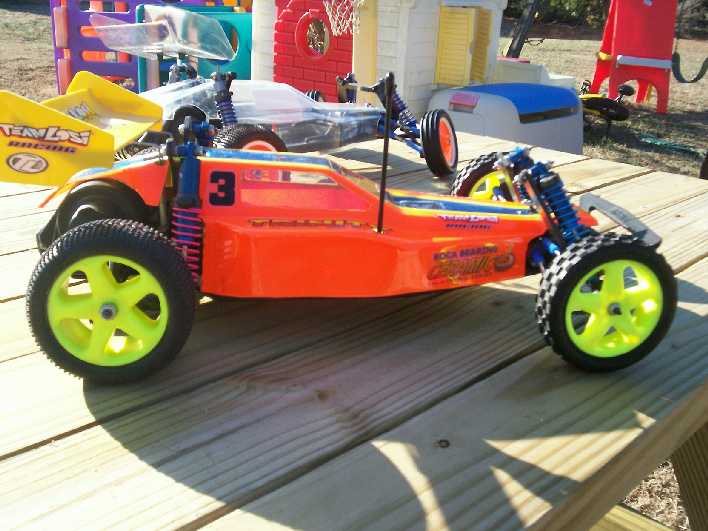

Me to I fun the Losi XX A-8008 body on my Racer Pro se, I like it better than the Pro se body. it looks alot better and I like the fit better. just take your time and cut slowly and you can get them to fit great. here are pics of my pro se with the xx body

Thank you, you need RPM jrxt truck arms, and a set of xx carriers, you need to drill out the lower hinge pin were it connects to the arm to 1/8 install just as normal. it was the best way to run 2.2 wheels and I wanted them to match. with out the truck arms the front is to narrow and it pushes in the turns. this car is a xx in pro se clothing. :twisted:
