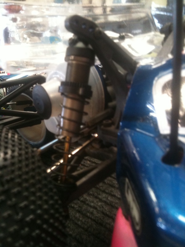

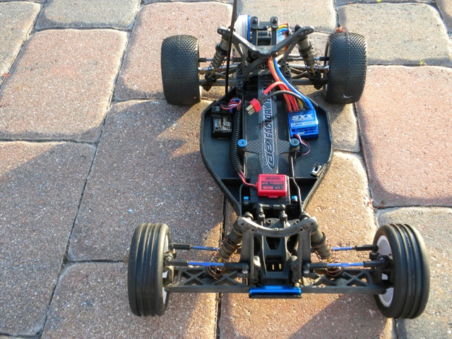

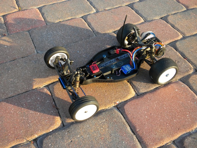

The carbon chassis will work on a high bite track, but if you are on a marginal track the plastic will actually give you more bite. Also, we currently run the lightweight setup with the 4th hole drilled in the rear tower, black springs with B44 spring cups and cut black springs. This setup seems to work pretty good on almost every surface. The front is pretty standard with the brown springs and mounting locations. My son drives for AE and runs plastic everything with this setup.

JHarris wrote:The carbon chassis will work on a high bite track, but if you are on a marginal track the plastic will actually give you more bite. Also, we currently run the lightweight setup with the 4th hole drilled in the rear tower, black springs with B44 spring cups and cut black springs. This setup seems to work pretty good on almost every surface. The front is pretty standard with the brown springs and mounting locations. My son drives for AE and runs plastic everything with this setup.
How much of the spring do you cut and any pics please?

Two complete coils, then flatten back. This puts you between a black and green. I put green paint marks on mine...

This isn't the greatest picture but it will do for now. I took this with my phone at the track yesterday. After I clean everything up I can post pictures of the car.

Post by JHarris »
These aren't great, but they at least show mounting locations for the shocks and ball studs.
