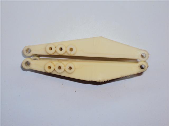

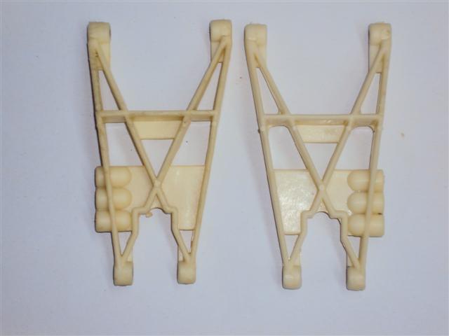

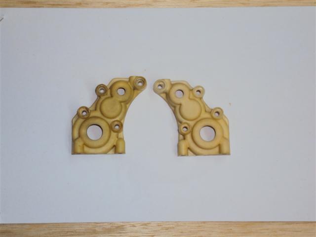

alright. i have a glass in the sun with one average condition rc10t rear arm and a one side of a very brownish looking stealth case. now seeing i will loose the sun around 6:30 or 7ish in my yard it will only get about 4 hours of sun. depending on the results i may try it again tomorrow if a decent result has not been reached. i only did one arm and half of the stealth case so i can take some side by side shots after it is finished so that if there is any difference you have something to compare it too.
i used a 50/50 mix of hydrogen peroxide and tap water. the peroxide i used was very old and has been under my bathroom sink for about 5 years now. if there is any indication that this does work i will pick up distilled water and some fresh bottles of peroxide. i just did not see a point in going to the store and buying stuff if is would not work.
i will post pics tomorrow if there is anything worth posting. if this does indeed work i will test this out on some dyes parts to see what happens later on also.
- LowClassCC
- Posts: 935
- Joined: Wed Mar 25, 2009 12:08 am
- Location: Mauckport, Indiana
- Has thanked: 108 times
- Been thanked: 171 times
Re: Anyone tried this? Yellowed parts white
ok these did not get a full 8 hours of sunlight. more like 3. sorry was very overcast most of the day. i will do them again later this week to see if multiple treatments continues to help. but even though they did not get the full time and i was forced to use a 50/50 mix (didn't have enough to cover the truck arm without mixing.) i feel that this was a tremendous success. there was no change in the feel, finish or flexibility of the parts. only noticeable difference is the color. i may look into some uv lamps in the future and try it out that way.
if anyone else is trying this please post pics. in my pics i have the treated part next to the untreated part that it is paired with. the 2 arms matched in color before the treatment and the 2 tranny halves also matched each other. they look a lot different in person than they do in the pics. my next trials will use non diluted hydrogen peroxide.
