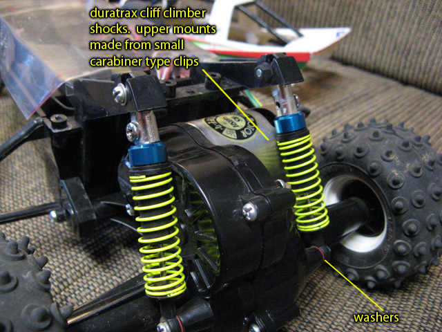

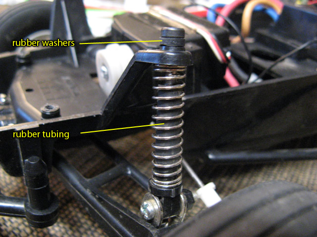

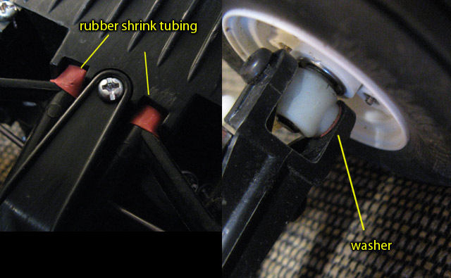

After a few runs it struck me that one of the main giveaways that this was more of a "toy" car, was the rickety rackety sounds that came from the front end and the suspension. I then set out to eliminate as much slop and noise as I could with stuff I had lying around. I started by adding small red washers to the rear shocks and front wheel mounts/carriers. I also added rubber washers below the screws on the front "shocks", and also added rubber tubing onto the screws that are in the front springs. This gives much less travel to the suspension, but adds a TON more stability to the front end when running offroad (the only type of running I do). I just worked with cutting the rubber tubing to different lengths until I was satisfied with the results. I also put rubber shrink tubing around the ends of the bottom suspension(?) arms to quiet it down and tighten it up a bit. The biggest upgrade though was the rear oil filled shocks (from a duratrax cliff climber) that I fitted to the stock mounts by creating adapters from some small carabiner clips that I had lying around. It took me about 3 HOURS to make those 2 adapters by hand with a dremel!!! (yes, I'm insane!)... but anyway I didn't want to wreck the shocks, and I didn't want to wreck the grasshopper body. Creating the adapters was the only way around this. The tops of the adapters have holes that the screws go through, then the bottoms are drilled out and the lower screws go through the "eye" of the top of the shock mounts. I'm including pics that detail what I did. Oh and I also have a 540 motor in it...this thing runs AWESOME now...it's amazing how much the rear oil shocks and front end mods help. Maybe my ideas can help some other people mod their grasshoppers to be a little closer to "real" RC cars :D
