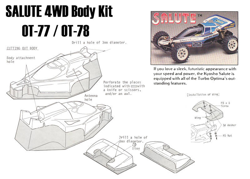

Do any of you have suggestions for a body for my Turbo Optima other than the stock T.O. body, which I don't really care for? I *love* the original Optima body but it's too narrow to fit an 8.4V 7-cell battery. Have any of you tried other bodies and found they fit quite well? Cheers!

You can use the Salute body if you want. It came with 8,4v 7cell battery pack.
http://cgi.ebay.com/Kyosho-Salute-Body-Wing-Driver-decal-fits-all-Optima-/180540834370?cmd=ViewItem&pt=Radio_Control_Parts_Accessories&hash=item2a09128242

Re: Give me some buggy body options for Optima/Turbo Optima
I believe this will work. I can get you a width measurement when I get home tonite to see if 7 cells will fit under it.
http://www.rc10talk.com/viewtopic.php?f=59&t=13993
The open side off the salute did give me some ideas: a tamiya re-re boomerang body or even hotshot should work... it did for my ultima
