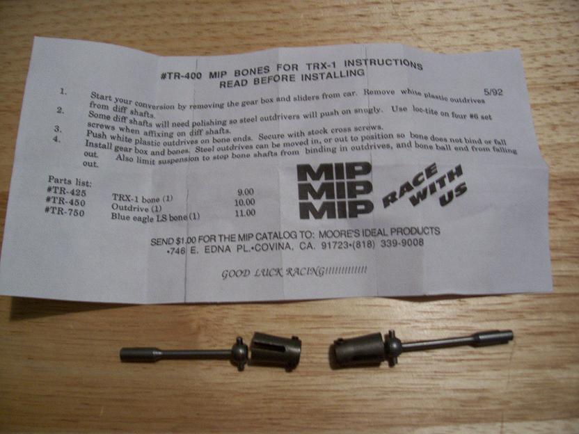

Anyone make their own MIP rear CVD setup? What part numbers etc?

Does this help.

Hmm, thats kinda cool, does the dogbone mount to the wheel outdrive?

You remove the plastic outdrives from the trans and replace with the metal ones. Them remount the placstic out drives on the dog bone and use the stock axles and cross pin.

Ah now I see. Thanks for the clarification.
