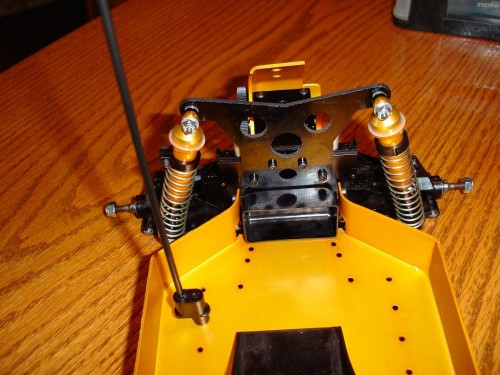

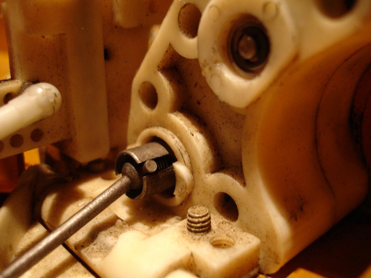

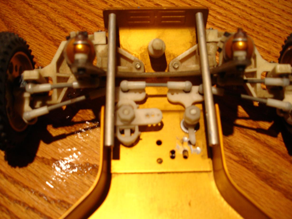

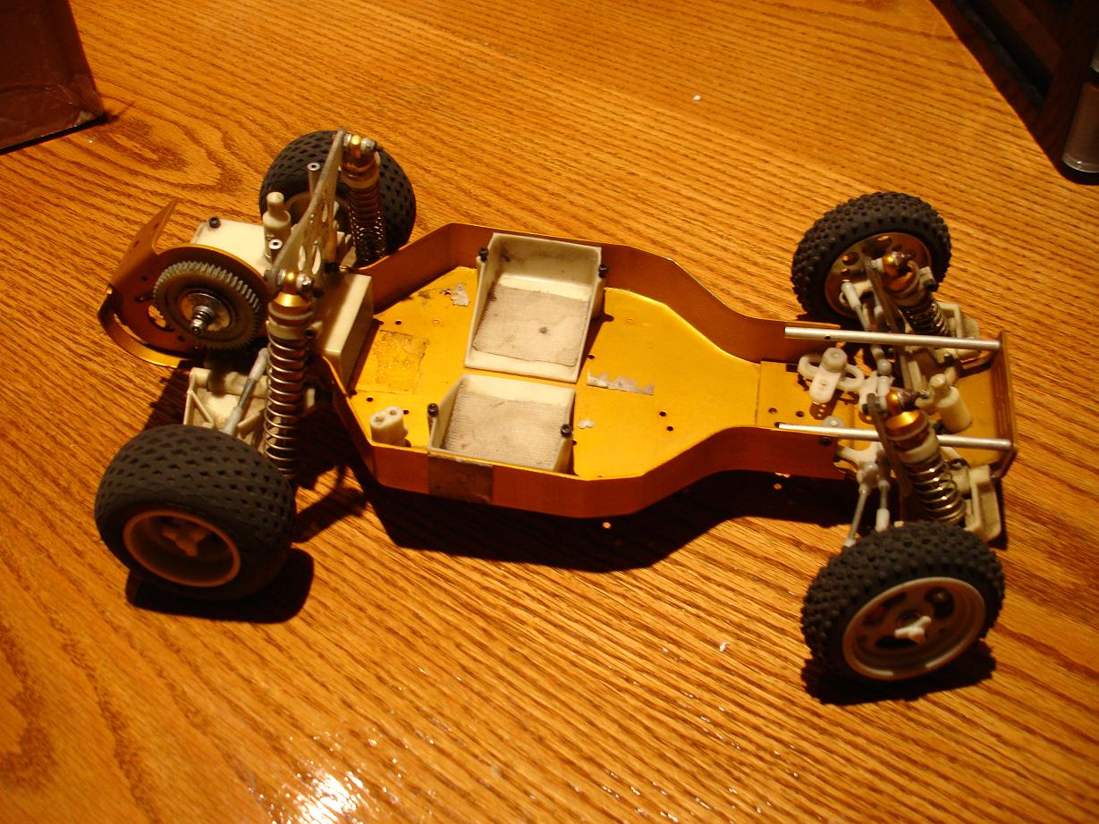

I just picked up my "new" project. It's an A stamp 6 gear that needs a lot of work. Based on slotcarrod's "25 years" article, the car is a cadillac version (like the one I originally bought in 1986). There's no slop in the suspension hinges, very little wear on the outdrives and dogbones, and the tranny feels pretty good.
My intention is to make it a runner using modern wheels, body and electronics (I still use brushed motors and AM radio), while keeping the car otherwise original. I'll update my post as I move along on the project.

outdrive/dogbone
outdrive/dogbone
front suspension
front suspension
cadillac roller
cadillac roller

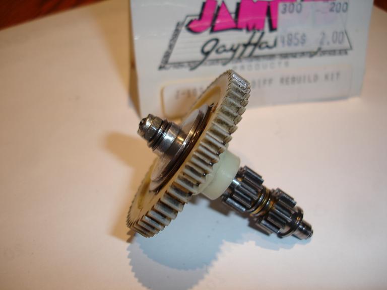

Here's the diff rebuild using the "Jammin Jay" kit. The original bearing was shot. Thanks to "templeofspeed" for posting the pic on another thread, since the kit had no instructions and was vastly different from stock. There's no spring on the diff nut, but it uses another thrust bearing, like the one on the shaft. Also, I'm planning on running a modern (48 pitch) spur gear when I get the car running.

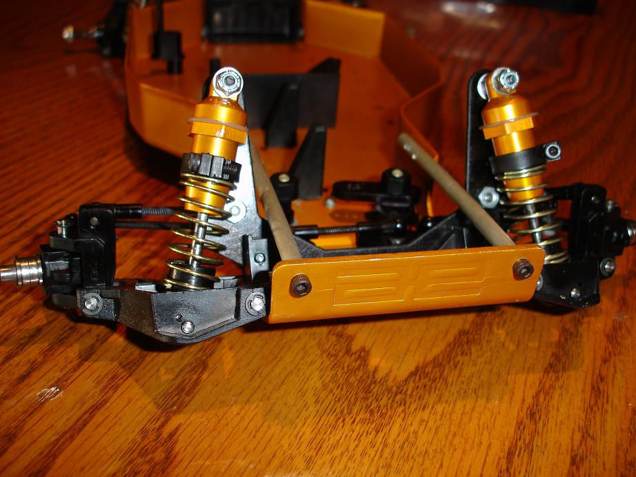

On a different note, I just got some steering blocks/axles/c-hubs from ebay, and they are inline axles (as opposed to the original offset type). Were those previously offered as an aftermarket option, or are they from the TQ10 version?

the inline axles were used with the wide front arms.

Thanks. I originally got them for the kingpins and extra parts, but I was debating on using the inline setup instead.

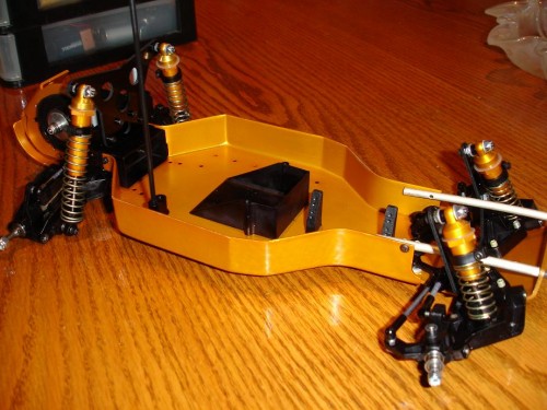

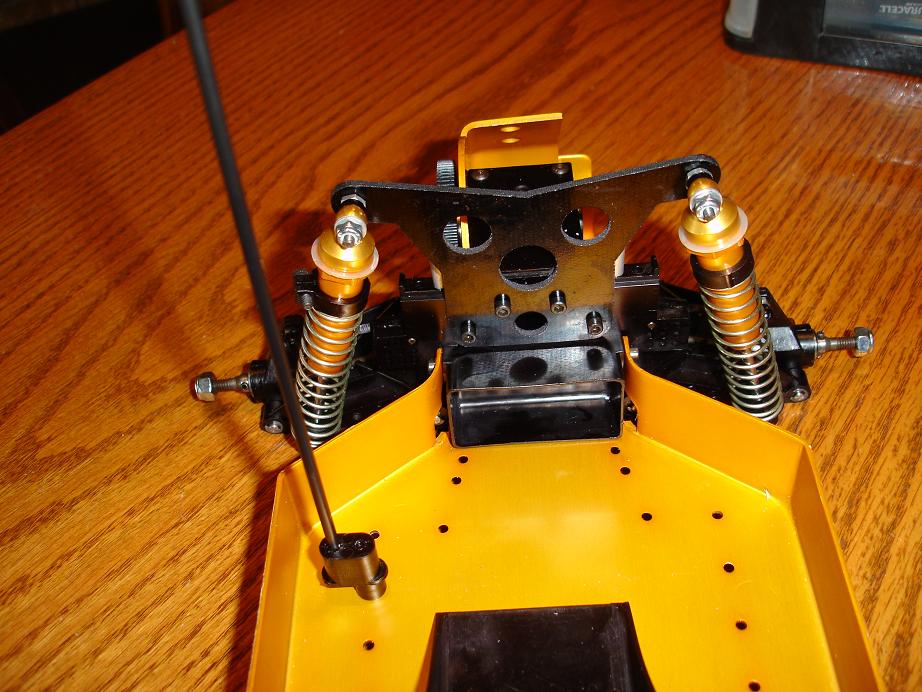

I've managed to put a little work into the car....dye job, rebuilt shocks, diff, and hardware. I picked up a spur gear (48p/81t) from RJSpeed that's a direct bolt on for the 6gear (part #5581). I've also found some black 2.2" front and rear rims for the 1/4" axles (just waiting for the mail). Here's a few update pics as it goes along:

What dye did you use to get that fiberglass so dark and even, and how long did you dye it for...nice build

Post by jwscab »
that came out awesome! I love the black and gold combo (one of mine is exactly that).

Post by Ruffy »
Just use the same standard black RIT dye for the fiberglass as well. The glass needs to stay into the dye a long time, as do the parts, to get them a deep black. Just put all the parts, including shock towers, in the same hot to very warm dye solution and keep reheating as needed. You can use the microwave, I used to just fish my parts out, nuke in the microwave, then add the parts back in until the black I got was very deep with no "purple" hues visible.
I used to dye my parts back in the 80's but stopped soon after. It is pretty easy to do!
