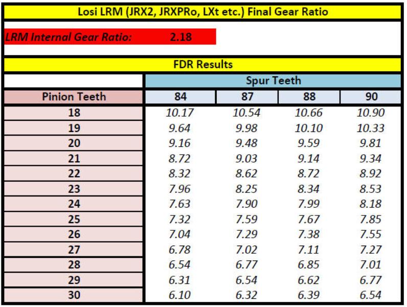

Ready to run my Jrx2 LRM transmission racer this Thursday for some practice. I will be running a a 13.5T (3300kv) brushless.
I have available for my JRX2 slipper spurs in 84, 87, 88, and 90.
I think I want a final drive ratio of between 7.0 and 7.5 if I am not mistaken??
The LRM has an internal ratio of 2.18.
So using the formula, spur gear teeth/pinion gear teeth X 2.18, I am thinking the 88 spur and 26 tooth pinion are a good starting point for a final drive ratio of 7.4.
I will test with a temp gun at track as well but am new to this brushless thing so all thoughts about why I should adjust which gear set etc. are welcome.

Not to rush anyone, but I have 24 hours to finish this car.
Perhaps a better question would be, if you had to pick a starting point final drive ratio what would it be for a 13.5T brushless LRM tranny. Then I can back into it with any size spur.
Novak site says final drive ratio of 7 is a good place to start for 2wd buggy with 13.5T motor.

What rear tires are you running? If you're running original JRX2 rims and no foam, I'd say go closer to 7. If you're running B4 rims with foam, go closer to the 7.5.
Now that being said, I'm a big fan of finding the sweet spot through running. You're definitely in the right area with 7-7.5 but get the car out there and run it through the full range.

I have only run a 13.5, but I was geared 30/76 in a XX4 (2.3 internal). Car was fantastic, but my FDR was closer to 6.0. In my Short Course, I was geared 24/88 (Blitz 2.6 internal) 9.5 FDR, but I was also running a Mamba Max Pro with CHEAT enabled (30 degrees of timing @ 9000 rpm).
I would personally start with the smallest spur you have, it moves the motor closer to the rear wheels helping reduce the pendulum effect swinging the rear end around. (I see 84 is the smallest you have
). Try finding/picking up a 78 and starting with a 24. Still starts you @ 7.

See I would have never thought about moving the motor forward as I was hung up on the number. I will work on getting a smaller spur for the slipper set up and start with the 84 I have for now. I doubt the LHS will have a spur for a 20 yr. old set up
Thanks a lot.
