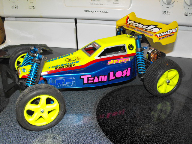

We started this discussion in another thread, but no reason to continue to hijack that one...
Here are the stock JRX2 axles on top of the XXT "conversion" axles for the GTX/NXT (and LXT).
Here is the stock Losi axles next to an AE alloy axle:
Here are AE axles installed, then the GT wide AE axles installed:
I personally use the stock Losi front axles, with a spacer from the rear end inside to use B4 wheels. I did the same on my TCP (it uses Losi axles up front too).
--Joey --

Yes, they are LOSA1022, but I really think those would we way too wide.
Converting the car over to run XX/XXX wheels is another option. If it didnt need the rare RPM front arms it would be a very viable option. Is there a replacement arm out there? Like the Dynotech/Klein arms?

I run B4 wheels, this seems the easiest and cheapest to me. B4 wheels of all styles are a dime a dozen and all you need is a small spacer on the stock axle to move it out a bit.
